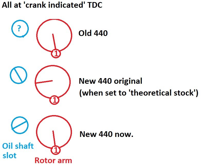

When I took the old one out I carefully set the engine to TDC on the timing marks, noted where the dizzy was set and which direction the rotor was pointing.
However, the new engine, when set to 'TDC' on the timing mark and oil shaft pointing to 'theoretical stock' it has the rotor pointing a completely different direction.
It seems odd to me that at TDC the new engine would [by default] have the oil shaft pointing a different direction. Surely both engines, at TDC MUST have the rotor arm pointing the same way ? Unless dizzys vary and the shaft/rotorarm dont align across manufacturers ?
Anyway - Here is a diagram of what I mean. I have 'set' the oil shaft/slot so that the rotor arm is pointing at #1 and the crank shows TDC. But I am scared to turn the key now !! I can set the timing once its running but on first fire up there are so many other things to look for (leaks etc) I'd like it SOMEWHERE in the ballpark from the off...
So closing question is "Crank shows TDC. Rotor arm roughly pointing at #1. Am I good to go ? "

- timing.jpg (51.73 KiB) Viewed 1150 times

Dizzy was marked on ‘old’ engine so i know roughly where it should go. I just got confused as to why i needed to realign the oil-pump-shaft ( which the dizzy plugs into.)
The issue is simply that ( it seems) the oil pump shaft is at diff angle - i should have measured it before twirling for pressure...
So i am reading ‘tdc, fire #1’ - which is what i have set up... true ?

Ok, the cam and therefore the distributor runs at half crank speed. So when the damper is set at the 0 timing mark it is either at TDC or 180 degrees out. At TDC both valves on No1 will be closed, so make sure that’s the case. No1 on the distributor can be anywhere you like, it depends on where the oil pump drive is sitting. If you want No1 in a certain position, once you have the damper set correctly at TDC, use a big flat screwdriver in the oil pump drive and unscrew it from the cam and move it round a tooth until No1 on the distributor is where you want it to be. I hope that makes sense, call me if it doesn’t and I’ll talk you through it.
Re: First fire up - timing jitters
It does. Thanks.
I think its where i want it. If 180 out will it hurt anything ?
No but it won’t start it will cough back through the carb....
