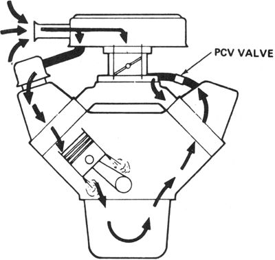

Hang on. Is your breather on the SAME rocker as the PCV valve???
The system will not work like that. You need the valve on a sealed drivers side rocker and one breather (with its own filter or plummed to the air filter base) on the passenger side rocker.
That way air is drawn into the breather, through the crankcase, and out through the valve to the carb where it is burned with the mixture and blown out the exhaust.
Like this.

Posts: 5893
Dave I think you are spot on. Jim has the breather and the PCV valve on the same rocker cover, so he needs to move it back so they are on opposite sides.
I always thought the breather let fumes out, not suck air in, so your diagram makes a load of sense and (as always) I learn something new every day!
I thought we could do away with the PCV but then I looked at my Charger and that has one sending crank case fumes to the same place on the bottom of the carb.
I think this is problem solved when Jim can switch the PCV or breather to the other side.

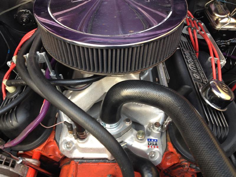

:thumbright: Done last night :thumbright: Both at the front now but on opposite sides

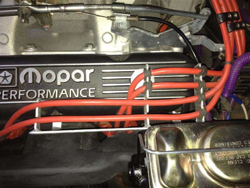

This home made plug leads rail is why I ended up moving the PCV Valve to the front (need a few more grommets to finish :) ) I could have made the bracket futher forward or back but it would hold the leads wrong so I moved the valve & thank the Lord I did cos we now know a bit more about crank case ventilation :thumbright: I have a transmission question on the tranny section if anyone can help some more :oops: :? :lol:

Jimfish wrote::thumbright: Done last night :thumbright: Both at the front now but on opposite sides
Are they still not the wrong way round ? :scratch:

:oops: I just thought they had to be oppposite each other, does it matter if it sucks right to left instead of left to right?
