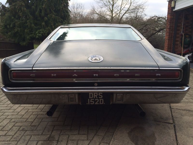

I know 1965 and earlier cars can run red rear indicators. But with post 65 cars (mine is April 66) is there not a "testers discretion" thing for getting a car through or is it a final no? I ask as on my car the whole of the rear of the car lights up as stop/tail light and half of each side flashes as an indicator. As this is about 2-2.5 feet of big red flashing light, it seems silly for this to fail the mot, but I can put a very small Amber light possibly half hidden away and get it passed!

Lovely rear end pic ..... ;)

It is not a problem as long as the drivers behind you know what it is when a RED indicator is flashing.
In UK most drivers are not used to seeing RED for indicator, only for brake.
So if someone hits you from behind when you were turning, then problem with insurance and the rest could follow, not worth the hassle mate, as the law says after 65 all AMBER indicator (does not matter the size).

If the person at the back cant see them brake lights flashing or not Ali, they sure aint going to see a little amber bulb flashing :lol:

Just as appoint of law, irrespective of friendly MOTs it is illegal for post '65 cars to have red indicators. I had my red indicators pass MOTs without problem, but the police eventually pulled me and told me categorically that I would be nicked if I drove it again without converting the indicators.
There is no grey area on this, it's just whether the police or the MOT guy care or not.
