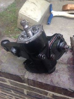

Manual steering box rebuild
This is for RHD cars but the same stuff is used in LHD, you just don't need to do the ball-nut swap for a LHD case if you buy a LHD ball-nut and screw

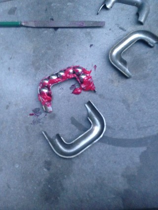

2) take off the ball guides
3) take out balls
4) swap ballnut end for end i.e put it on the other way round

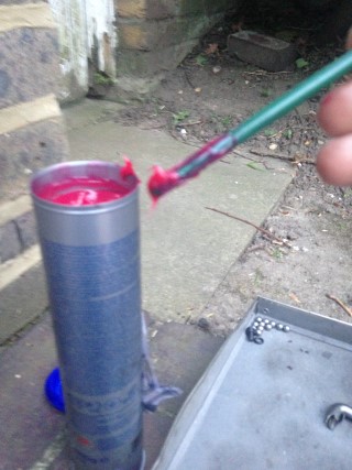

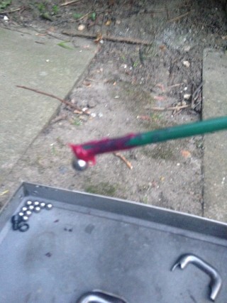

5) grease ya balls
6) push 50% into one circuit and 50% in the other
push 21 balls into each circuit well greased
glue the other 6 into each ballguide with grease
press in ballguides making sure not to loose one of your balls the wrong way down the threads out of the circuit.

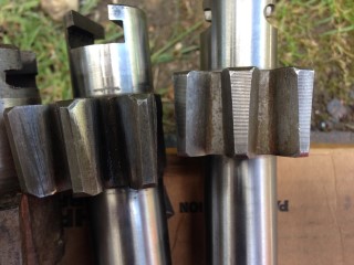

Sector
sector shaft teeth should be trapezoid in shape. look at pics below, see how bad my old sector was the teeth were so worn the trapezium shape was practically inverted
i.e looking from the side, wider at one end than the other. The teeth face is not parallel with shaft, wider teeth at top than bottom of teeth
looking from the front direct into the teeth wider at the top than the bottom. they should match similar contour to ballnut face.
worn teeth just mean you will have less adjustment from the adjuster, provided they clean up with a file they won't adversely effect the workings of the box unless so worn that you can not achieve stiffness in the middle of the box.

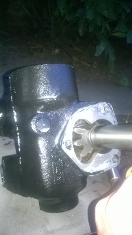

How to make a RHD 16:1 box using US Parts followed by general assembly
Avoid having to get an Australian 16:1/track/police steering column shaft or Pay for an Australian 16:1 box out of a race car or police car which has been rebuilt many times and is worn out. any hard chrome plaiting on the box interior parts indicates a shoddy rebuild
(based on ebay prices I think aussie 16:1 boxes are made of gold, $500-1k and the only other source is the 67 68 16:1 dodge dart box, I have never seen one anywhere)

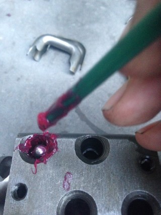

1) get a 16:1 ballnut and screw from FirmFeel inc.
3) take out balls
5) grease ya balls
7) put on ball-guide clip
You don't need to do 1)-7) if just rebuilding a Left hand Drive steering box, this is just to convert a USA worm and ballnut to an Australian one
8)Put the case in a bucket and clean it
the old grease is waterproof and does not melt in boiling water.
You can burn it out with a torch but it stinks.
better to use brake cleaner to stop it clinging and Bananarama! out in lumps
9) prize out seals
10 Using your long extension and a socket that passes through the mid sector bearing Knock out the bottom bearing
11) use same method to knock out the top bearing from the other end
use a small screw driver style hex socket and small socket extension through the adjuster hole to bare on the inner lip of the cover bearing with rollers removed and tap it out
12) if new the grease on the bearings will be good, if shop soiled clean all new bearings in brake cleaner and gently blow dry, do not blow the needles out
13) use your sector to start the bottom and mid sector bearings into case. use a socket of similar diameter on your extension to knock them in fully
14) use wood block to put the cover bearing in
15) put worm screw adjuster seal in
16) mount the worm and ballnut in the case with a smear of grease
17) do up the adjuster plug to 20 inch lb
18) back it off so that it takes 3-5 in lb to turn the screw (one of the AF or Imperial sockets in your socket set fits the spline)
19) put in sector seal with Hylomar round the side and in the corner of the seal well in the case (knock it in with a block of wood)
20) pack worm screw and ballnut area with NLGI II red grease
this will move grease over into sector section as well when you move the ballnut
21) Put ballnut in middle of travel hold teeth parallel with sector teeth and insert sector
22) check that sector teeth and ballnut teeth mesh thus, middle tooth in middle slot
23) pump it full of grease and close it up
24) the adjuster button and shim need to be fitted into the sector slot and then the case top wound onto the adjuster stud
25) set it so that when you adjust the sector adjuster that it is stiff in the middle
Use service manual or Firmfeel 16:1 Mopar action article on firmfeel site for precise setting info.
26) centre the box using the master spline on the sector and the case casting seam
27) grind new master spline into wormscrew shaft.
once in car pump in as much grease as possible.
drive it to settle the grease and move the air about
top it off with 90 weight gear oil
With new everything, you have a brand new steering box. no slop, precise, rock steady on the move, and just damn good.

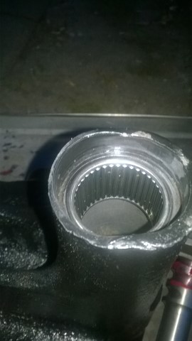

Sector

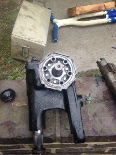

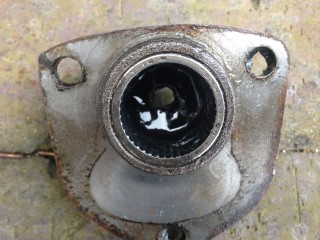

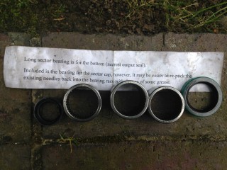

- rebuild kit from firmfeel two 3/4 inch long and one 1 inch or so long drawn cup needle rollers
- IMG_1744 (Mobile).JPG (34.36 KiB) Viewed 53332 times

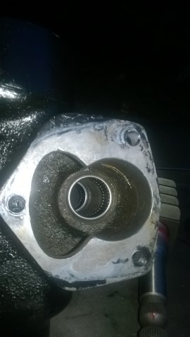

- steering box lid with old bearing still in place
- IMG_1743 (Mobile).JPG (35.79 KiB) Viewed 53332 times

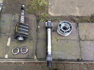

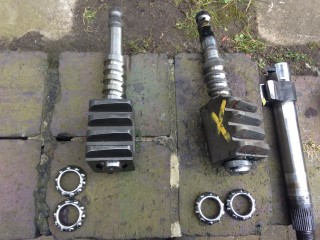

- aussie parts: Ballnut and screw the ball bearings for the screw the sector and the screw preload adjuster
- IMG_1742 (Mobile).JPG (38.96 KiB) Viewed 53332 times
- new 16:1 LHD ballnut and screw to the left and old Aussie RHD ballnut and screw to the right. Notice the different orientation of the ballnut teeth. 1 way for left hand drive the other way for RHD.
- IMG_1741 (Mobile).JPG (38.32 KiB) Viewed 53332 times
more pics
ballnut swap round
ballnut swap round

- greasing your balls
- IMG_1755 (Mobile).JPG (50.51 KiB) Viewed 53326 times

- Power sector: longer top , worn sector manual middle, new sector manual bottom
- IMG_1769 (Mobile).JPG (35.66 KiB) Viewed 53318 times
- worn sector left new sector right, look how worn the teeth are. this is what casues sloppy steering
- IMG_1768 (Mobile).JPG (31.06 KiB) Viewed 53318 times

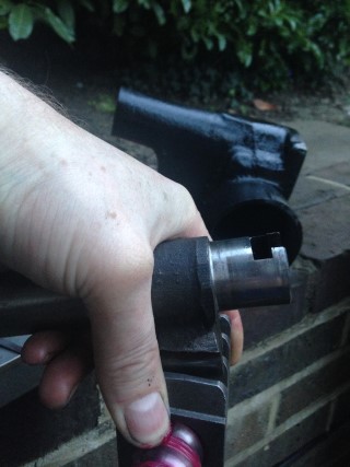

- bashing in the bottom bearing GENTLY with the old sector
- IMG_1765 (Mobile).JPG (44.52 KiB) Viewed 53318 times
- sector mesh with Ballnut for RHD
- IMG_1764 (Mobile).JPG (43.07 KiB) Viewed 53318 times
more
- tapping in the top beraing
- WP_20160503_003 (Mobile).jpg (73.74 KiB) Viewed 53316 times
- IMG_1771 (Mobile).JPG (51.36 KiB) Viewed 53314 times
- top bearing in place
- WP_20160503_004 (Mobile).jpg (69.34 KiB) Viewed 53314 times
- bottom bearing in
- WP_20160503_002 (Mobile).jpg (69.66 KiB) Viewed 53314 times

US ebay now seems to provide access to 16:1 and 20:1 brand new, Mexican or Brazillian made, US LHD steering boxes for about $200-$300
for US cars i think its worth it you could have 2 of these for the price of a firmfeel rebuild as they are similar in price, for a whole complete box, to buying the sector and wormscrew bearings 2 seals, a worm screw in your ratio and 2 tubes of waterproof grease once the Import and VAT is applied to each package.
if you have a RHD box in need of rebuild, i'd buy the US box in the ratio you need and swap the parts where necessary into a RHD box i.e the ballnut worm screw and bearings, doing the ballunt flip for RHD compatibility.
obviously not having done this i can't say 100% that the internals are identical, but finances dictate that a company making a new standard box for a very old car are not going to be reinventing the wheel. why pay costs to redesign, flameing river style, if you are not adding any new features
so i'd suspect they are genuinely a clone of the original the ballnut/ wormscrews and sectors are still made by Saginaw/Delphi so the detail for each application is in length, ratio (standard for all brands 16 20 24) and spline
i.e for RHD rebuild parts its worth the risk, its cheaper than NOS parts, it cheaper than firm feel if it doesn't work you can always put it back together and flog it to a ready audience of LHD owners.
you will need to buy a sector seal regardless. Rockauto sell them, but look them up on part number only, as the listings for manual steering for Mopar small sector manual boxes are wrong, you will end up with a seal with a coffee-mug diameter, it and the worm screw seal have been listed wrongly, since about 2006
