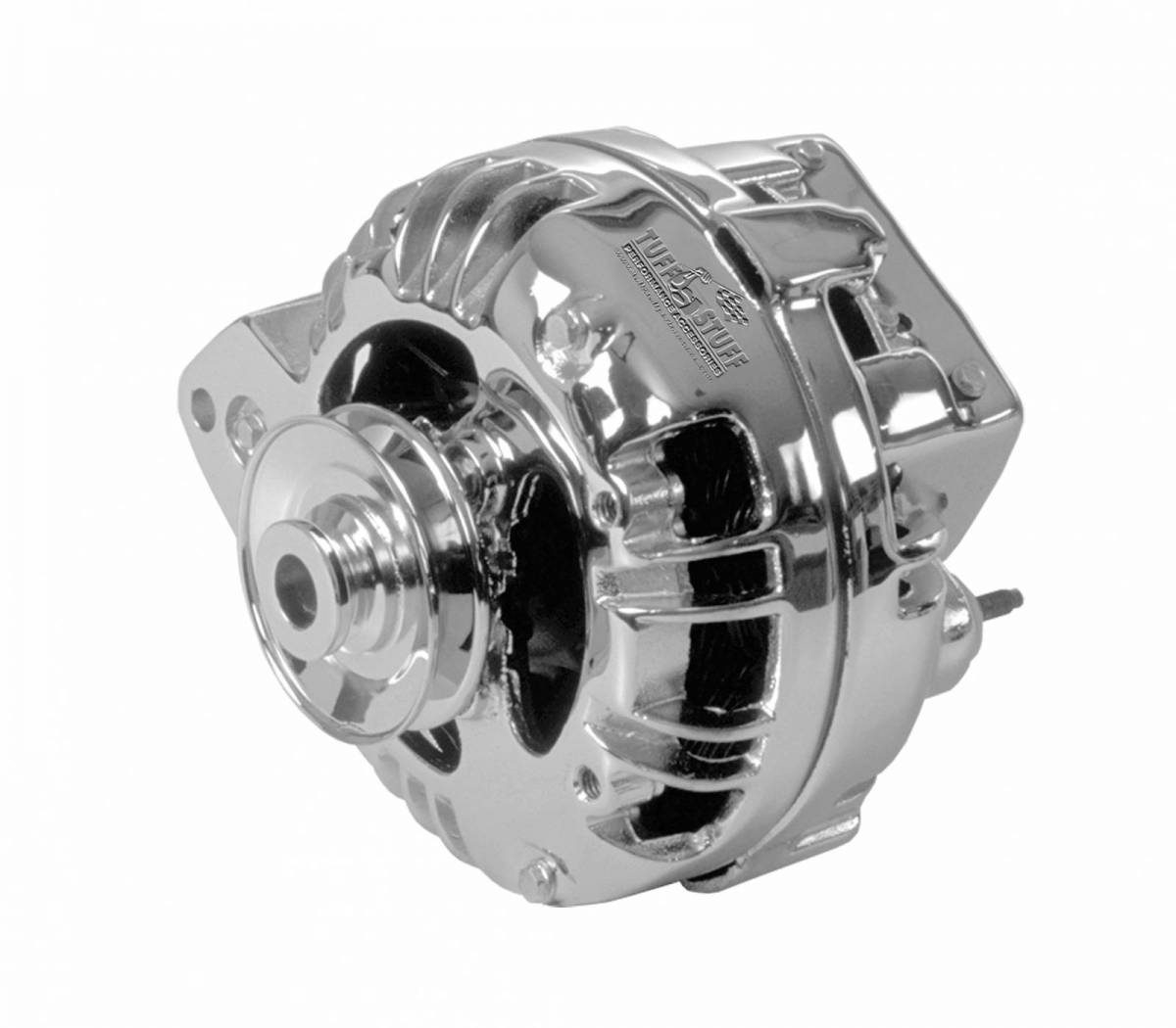

I have a 100 amp unit made by tuff stuff and have not had any problems pricey yes(200 BUCKS), but very reliable
http://www.tuffstuffperformance.com/i-2 ... 9rcsp.html :mytwocents:
