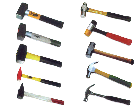

Posts: 7613
if it helps mate, here is a picture of a standard old Mopar toolkit....you may want to invest in some or all of the items at some point..... :D :thumbright:
Standard Mopar toolkit.gif (47.76 KiB) Viewed 2510 times
Posts: 7146
Steve wrote:if it helps mate, here is a picture of a standard old Mopar toolkit....you may want to invest in some or all of the items at some point..... :D :thumbright:
You forgot the manual to go with it Steve....... ;) :thumbright:
Or get a poster if you want a quick summary of what to use when working on your Mopar............. :D

Bigger the problem, bigger the hammer!!
