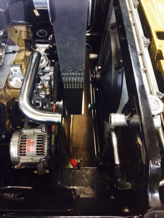

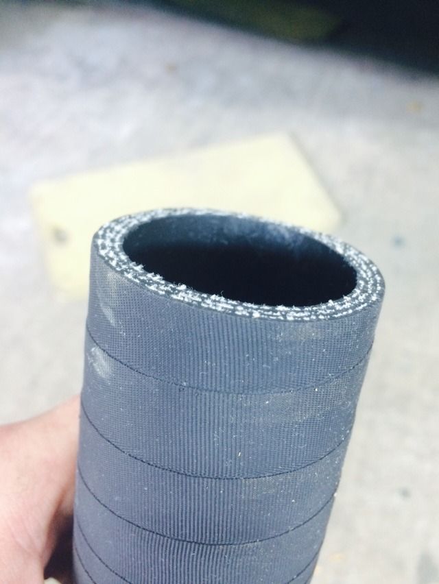

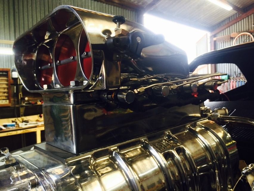

Found this silicone hose wrapped to look old
The gold was a bit to much

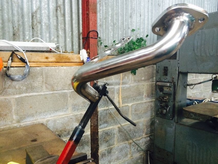

Also took everyone's advice and made my stainless pipe shorter
<a href="http://s73.photobucket.com/user/autofet ... 1.jpg.html" target="_blank"><img src="http://i73.photobucket.com/albums/i205/ ... sprhs1.jpg" border="0" alt=" photo BD737D2D-4A28-4C51-A7CF-A561E44A9827_zpsnmsprhs1.jpg"></a>
<a href="http://s73.photobucket.com/user/autofet ... y.jpg.html" target="_blank"><img src="http://i73.photobucket.com/albums/i205/ ... 34rqmy.jpg" border="0" alt=" photo 396EE30A-AC9B-40DC-920A-B5B5D3B254EC_zpskx34rqmy.jpg"></a>
<a href="http://s73.photobucket.com/user/autofet ... n.jpg.html" target="_blank"><img src="http://i73.photobucket.com/albums/i205/ ... ezvsln.jpg" border="0" alt=" photo 7EE08D4B-C212-4A44-AAB3-791504F6A723_zpscxezvsln.jpg"></a>
<a href="http://s73.photobucket.com/user/autofet ... 7.jpg.html" target="_blank"><img src="http://i73.photobucket.com/albums/i205/ ... yyts77.jpg" border="0" alt=" photo FEDFD208-C8B2-45F6-8C86-64E2D53F9EDE_zpsuuyyts77.jpg"></a>

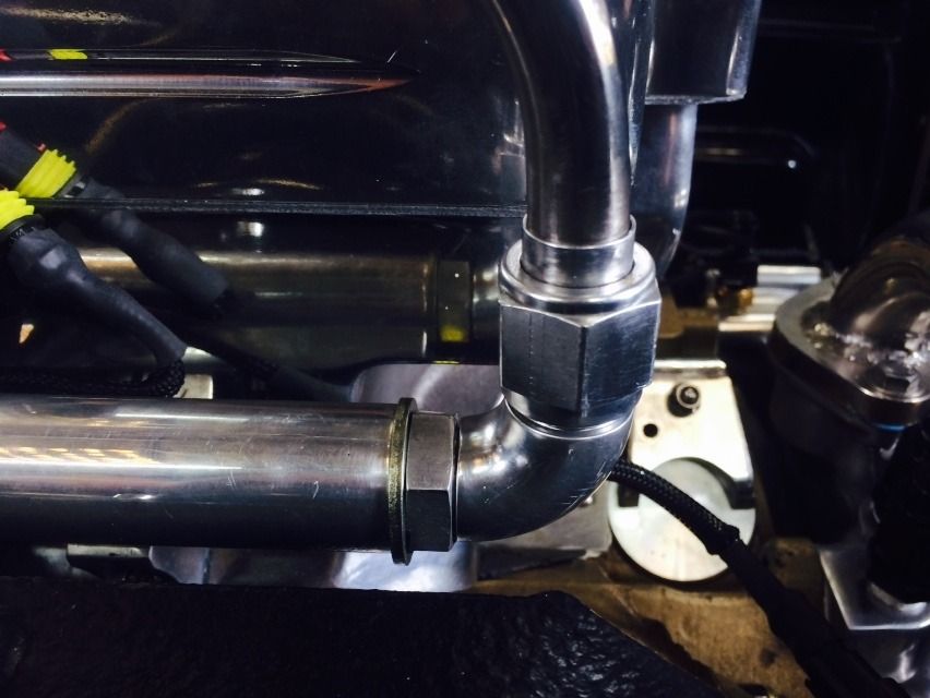

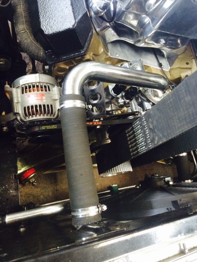

Also did the bottom hose with a stainless elbow
Left the hose a bit long for sacrificial k frame rubbage

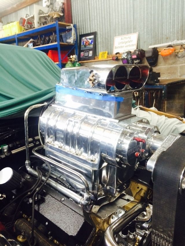

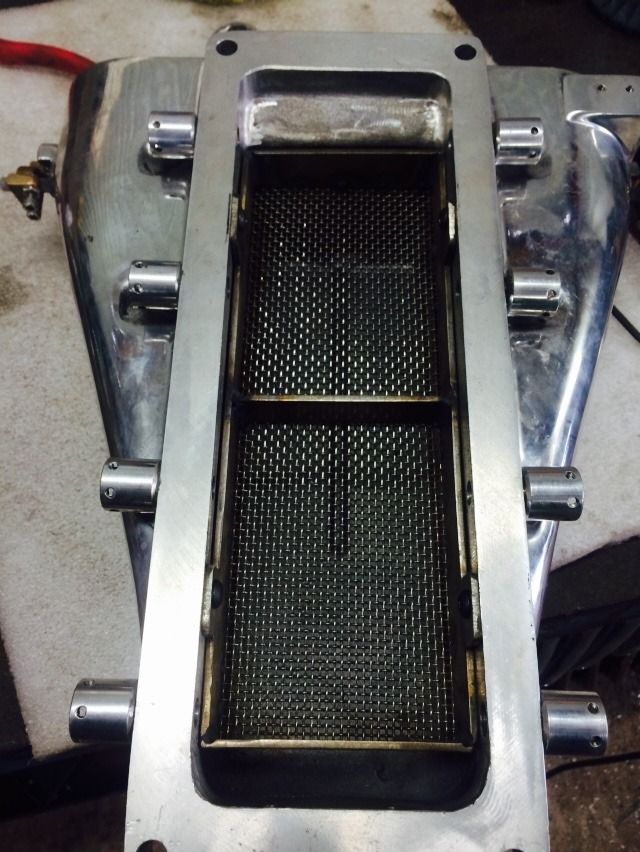

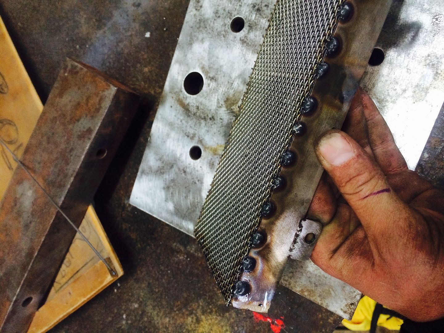

After weeks and weeks of stress and scratching my head
Half the people say yes half say no
fuel is add at blue line so any filtration need to be above blue line
well im running a gauze only and no filter.
to late if you think its wrong it done and over
The gauze is 304 stainless as used in fencing masks
all 304 stainless
all 304 stainless

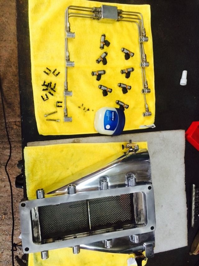

As said latil the surface area of a finer filter would be to small and restrict air flow.

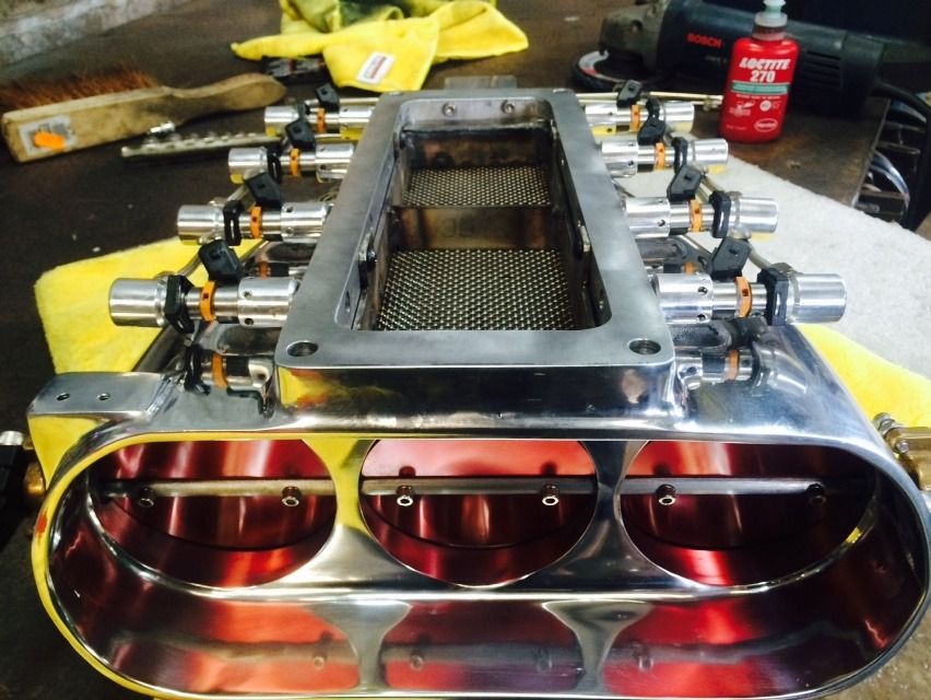

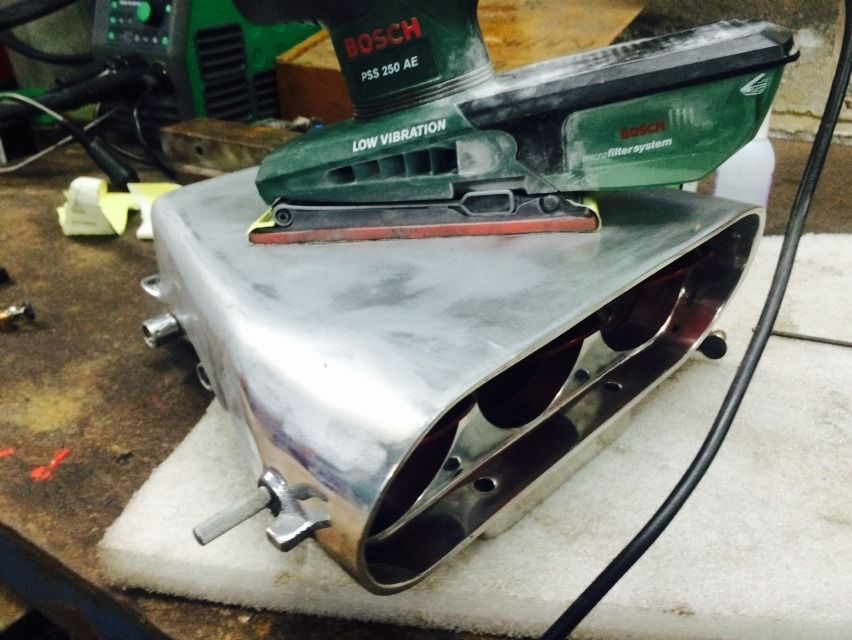

Cleaned all fuel rails and injectors
Didn't like the shine on my hat so started from scratch

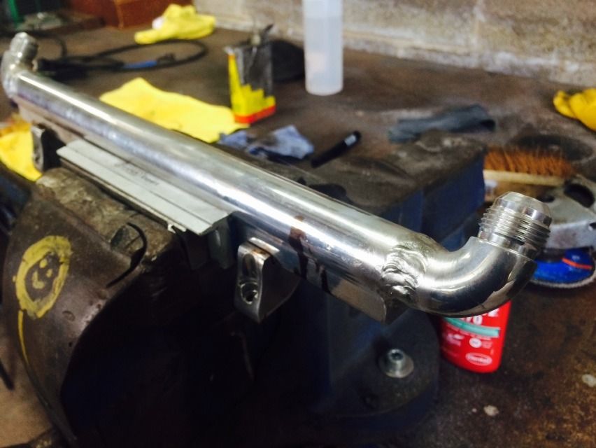

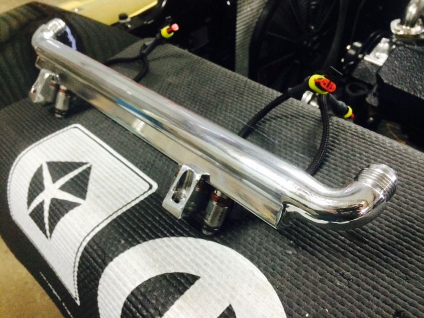

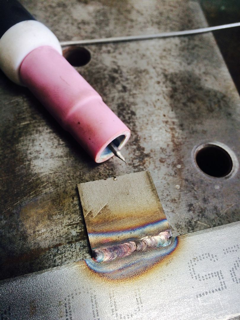

Filled with fuel
As I'm running EFI I need to have around 45psi in the fuel lines
This will also increase as boost increases
So I need to test my fuel lines to around 60psi
Got to 40 psi and sprayed everything in petrol
The design of these fittings with the O-ring is crap Tried dowty washer still fuel wveryware
So out with the welder and I welded the fittings straight on.
fuel rail I made and fitting all aluminium
