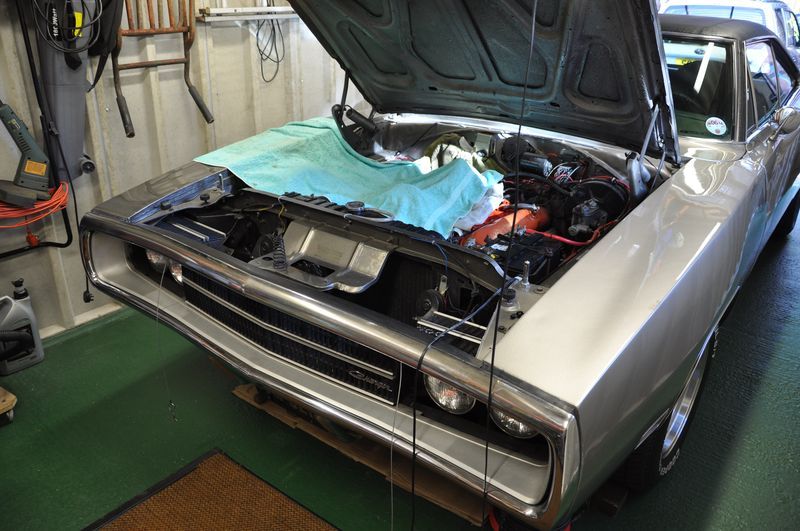

Si's '70 Charger 500
Back in 2013 ...

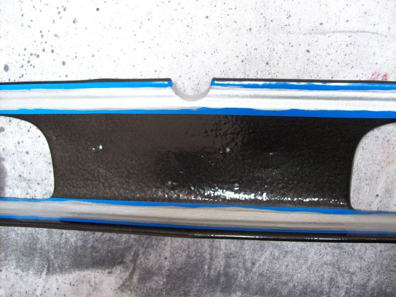

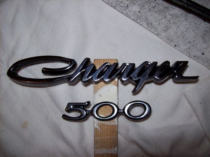

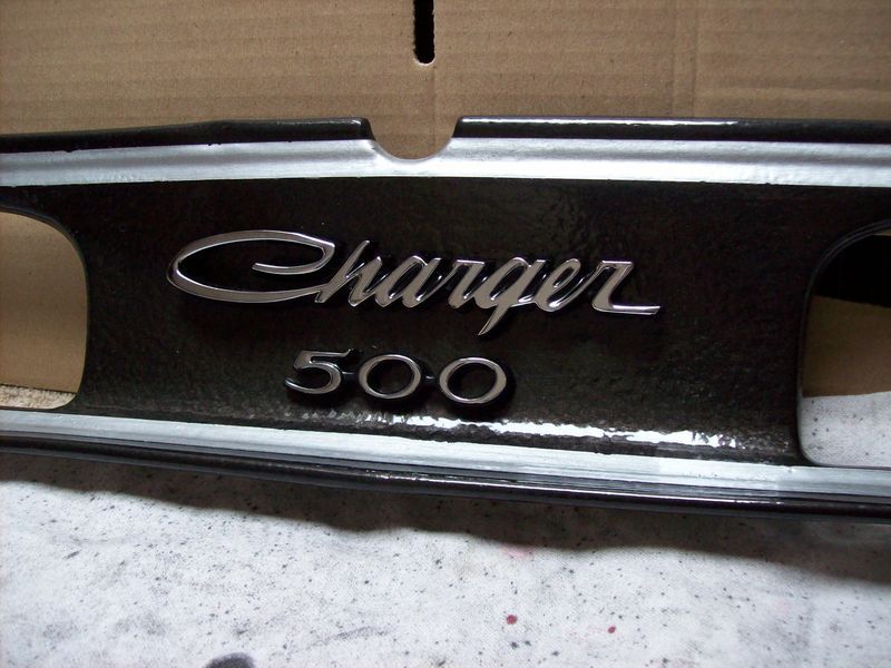

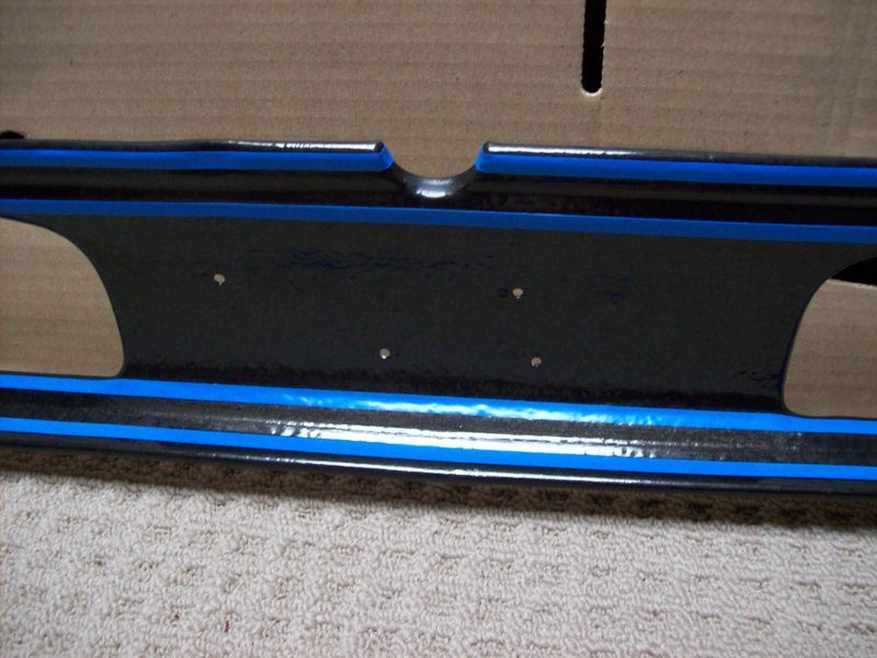

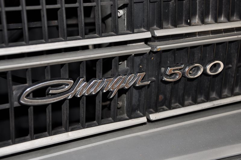

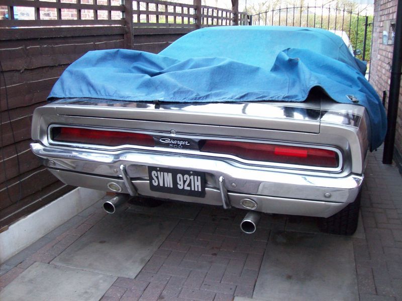

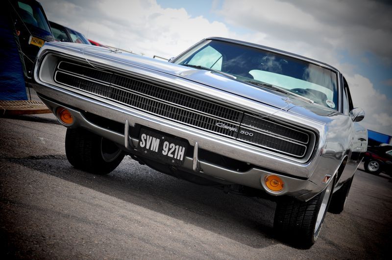

Refinished the rear tail panel and changed the Charger ‘arrow’ emblem to ‘500’
Seems lots of 500 models left the factory with the "arrow" emblem instead of the "500" emblem. Some had none, some had a 500 on front only, some had 500 on rear only, some got lucky and had 500 on front and rear. Never a clear tie-in with production dates. Some think there may have been shortages of the 500 emblems or possibly just mistakes by assembly line workers
I decided to use the larger front grill type emblems on 2 lines instead of the correct emblems on 1 line …

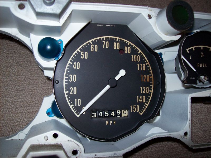

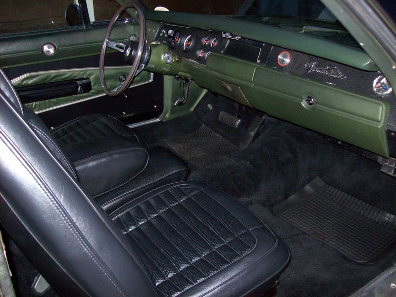

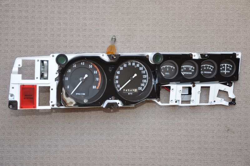

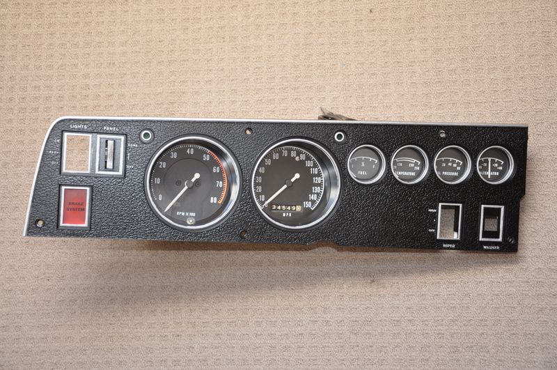

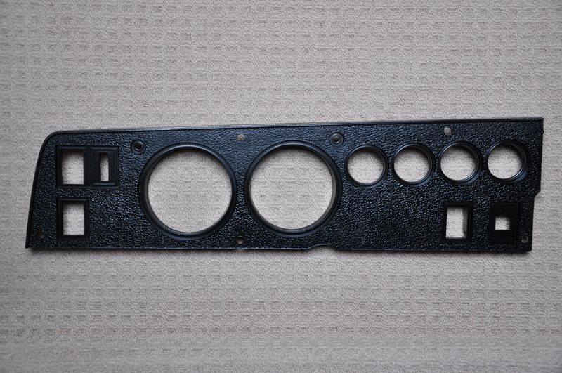

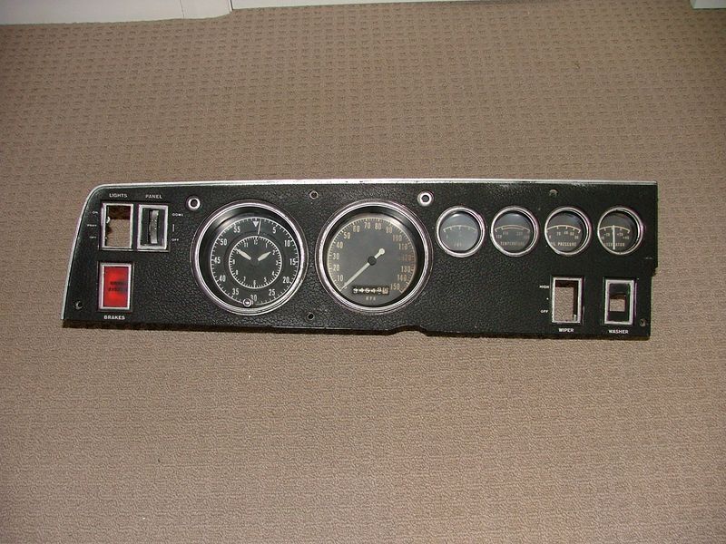

Refurbishing the original Rallye Dash Instrument Cluster

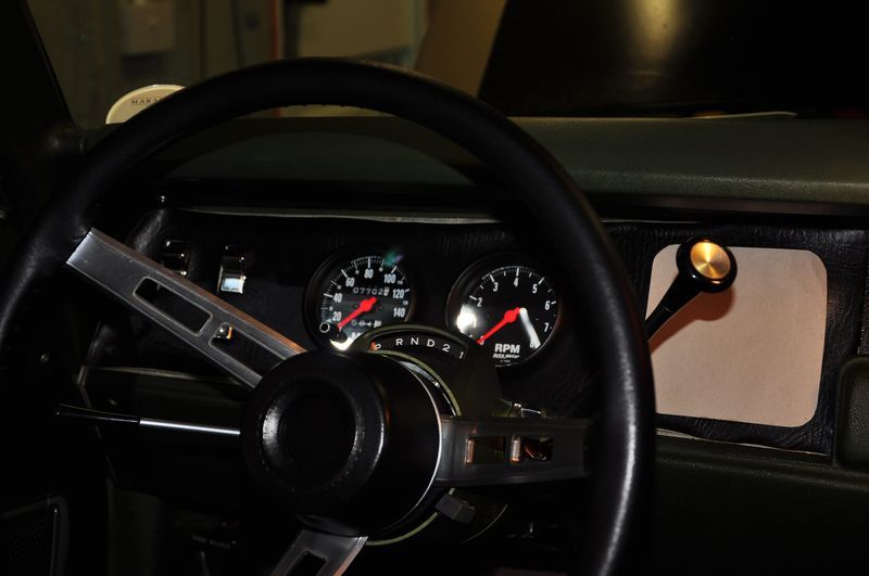

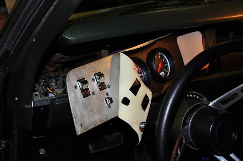

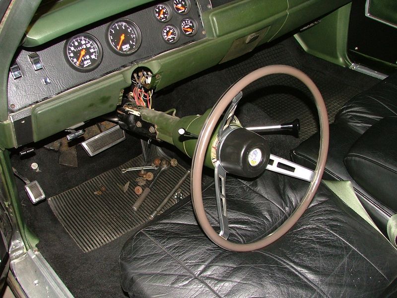

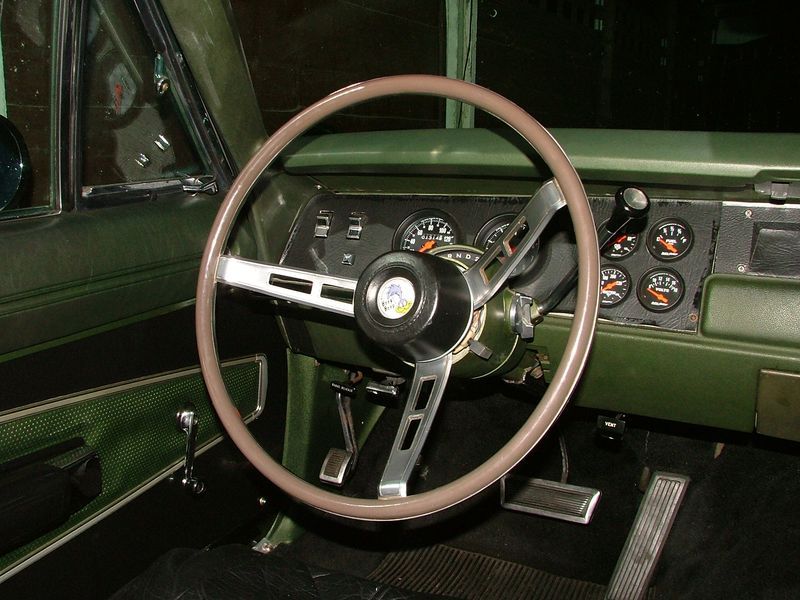

The previous owner had removed the original instrument cluster and built a custom panel with Autometer gauges
Whilst functional, it wasn’t to my taste, in my opinion the Rallye Dash doesn’t need any modification …

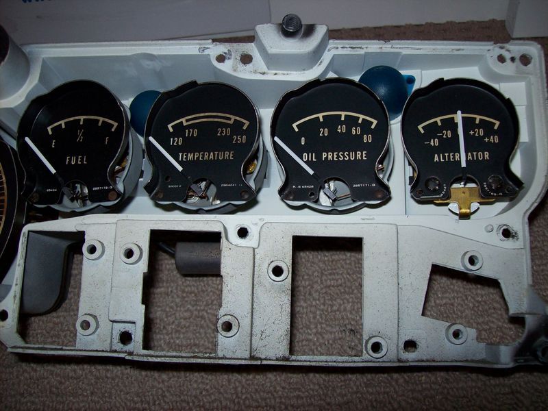

Fortunately the original instrument cluster came with the car …
I don’t know for certain so I’m guessing it was swapped out because most of it didn’t work
Another problem was the custom panel didn’t have a high beam warning light or turn signal repeaters, both of these required for MOT, whilst I could have added these to the custom panel I decided it was best to get on with the Rallye Dash resto …
So here’s the plan …

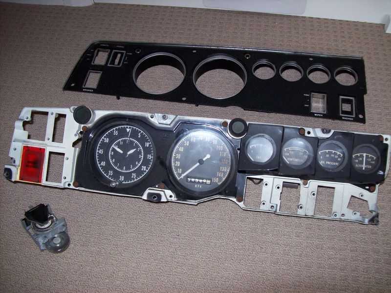

Take it to bits

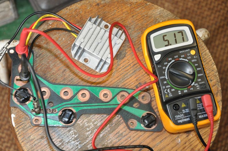

Replace mechanical voltage reg with an electronic version
Clean / repaint

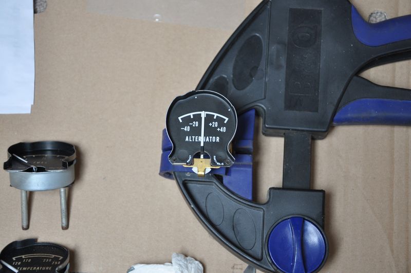

Reface gauges
Install repro tacho without clock
Replace all backlight lamps with LED

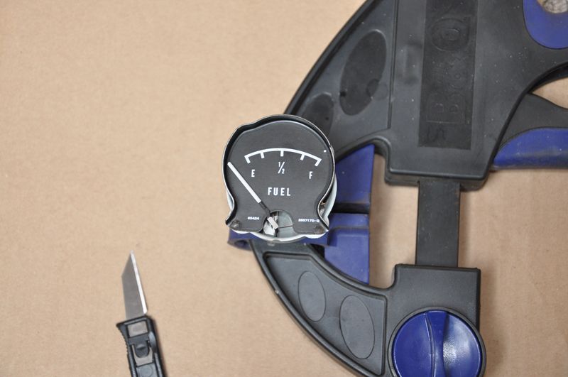

Reface gauges

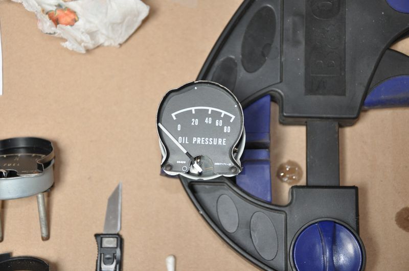

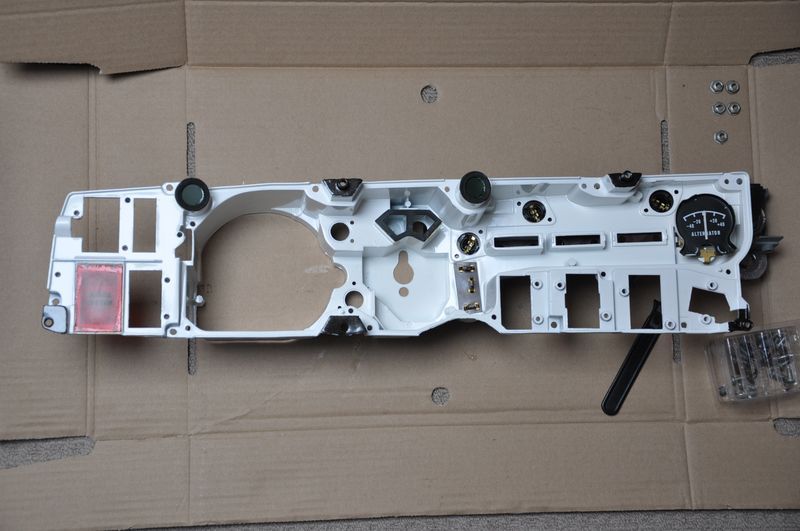

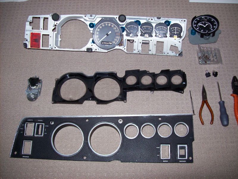

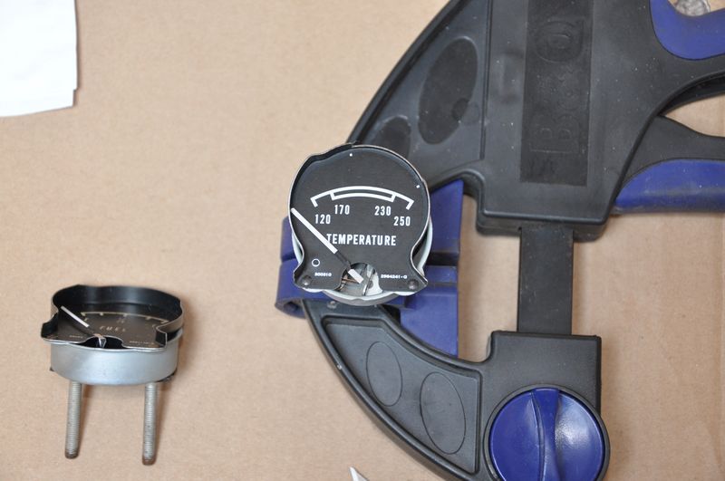

So the tear down began …

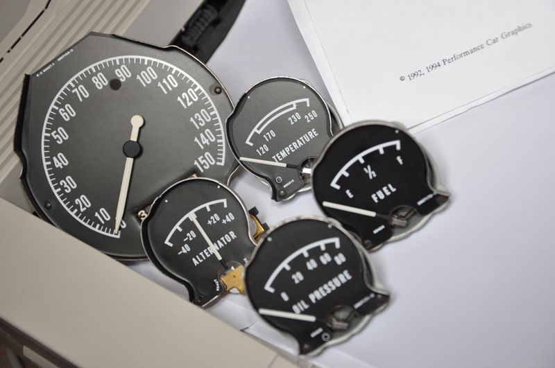

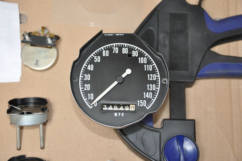

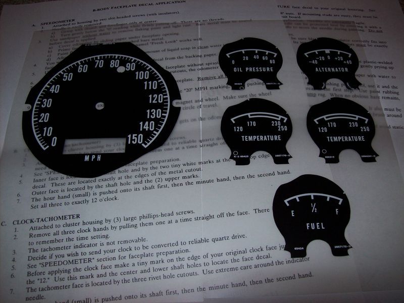

These are the new gauge faces from Performance Car Graphics …
http://www.performancecargraphics.com/D ... k-Tach.htm

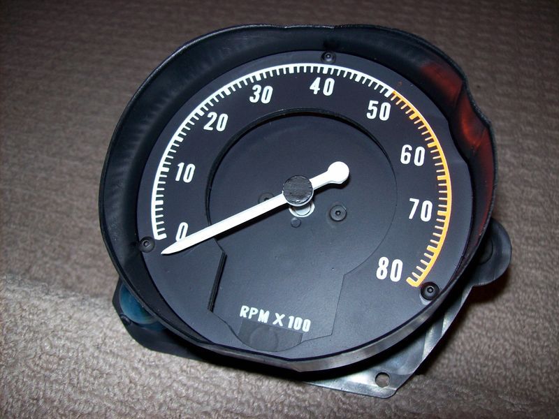

And the repro Tacho from Charger Specialities …
http://www.chargerspecialties.com/tachos.htm

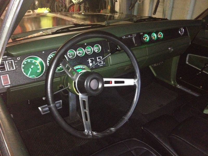

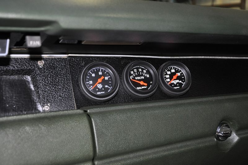

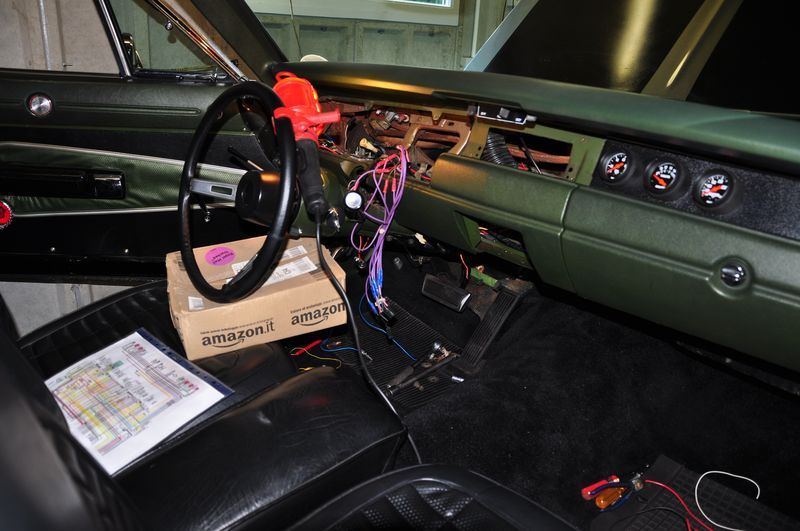

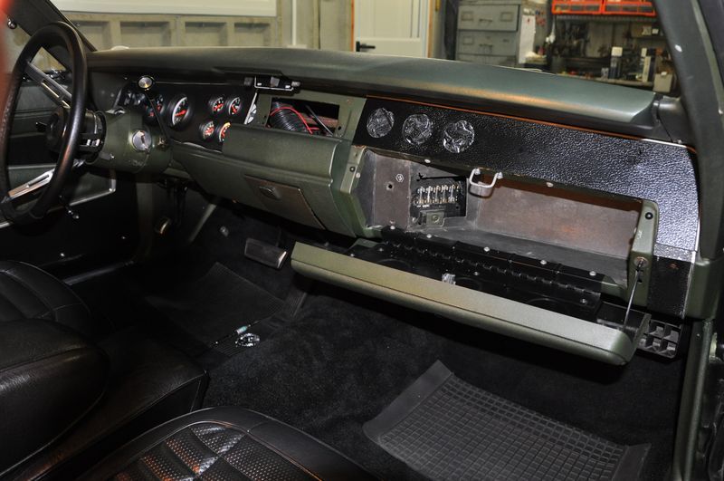

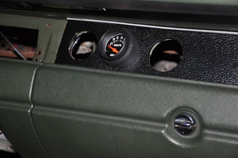

Back in the car, I wanted to keep the 3 mechanical Autometer gauges and decided to relocate them to the passenger side using angle rings to turn them toward the driver
I wasn’t too mithered about cutting the passenger side dash panel as it had already been drilled for the non-standard emblems shown in the first few photos above

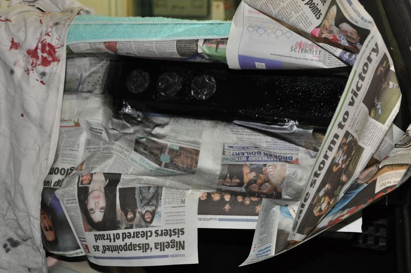

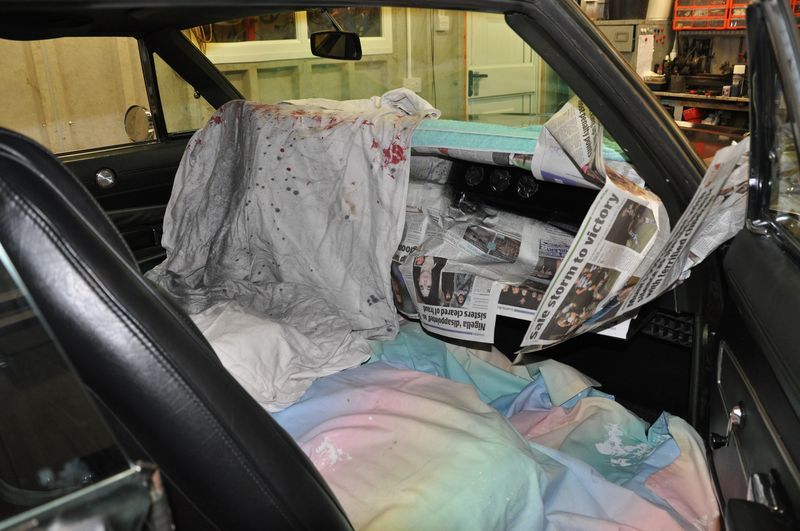

I tried to get the panel out for painting but it wasn’t having any of it, so masked it all off and sprayed it in place …
Next a new hole in the firewall to re-route the capillaries through to the passenger side
The new hole brings the capillaries through just above the heater box …
Pulled the gauges from the old panel and installed in the new location …
Oil, Volts and Water temp in and connected up
Maybe not everyone’s cuppa but I like it …
Back on the Rallye Dash Instrument Cluster

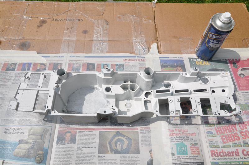

Gave the frame a waft over with gloss white …

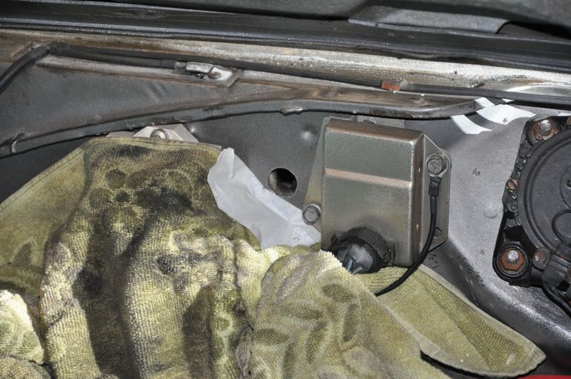

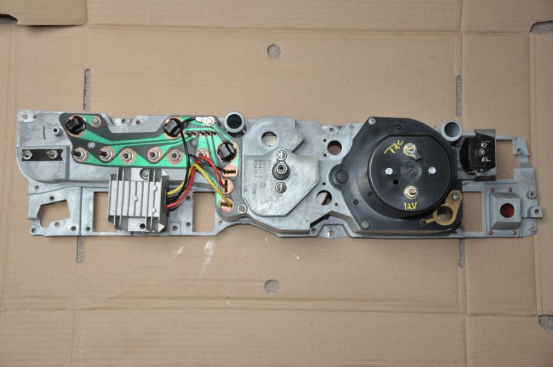

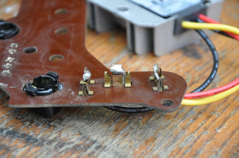

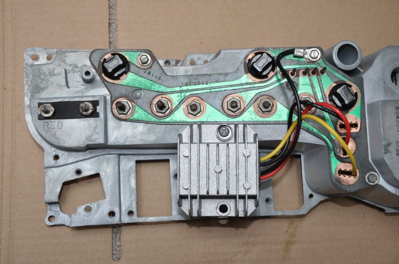

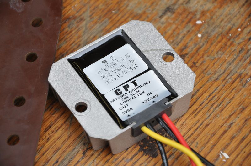

For the 5v voltage reg I went for a CPT device including heat sink and built in over voltage and under voltage protection …
http://www.ebay.co.uk/itm/25W-DC-DC-12V ... 0930951097
Soldered the tails into the pcb where the mechanical voltage reg used to sit …
Testing …

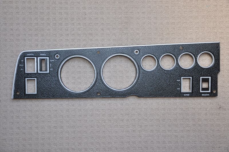

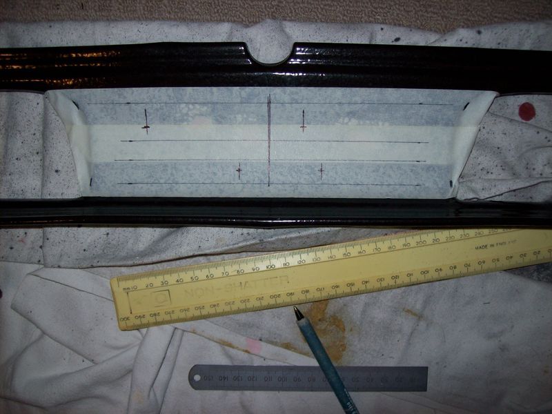

Brake and indicator lenses polished and reinstalled, dash panel painted and lined silver
Testing …

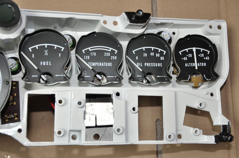

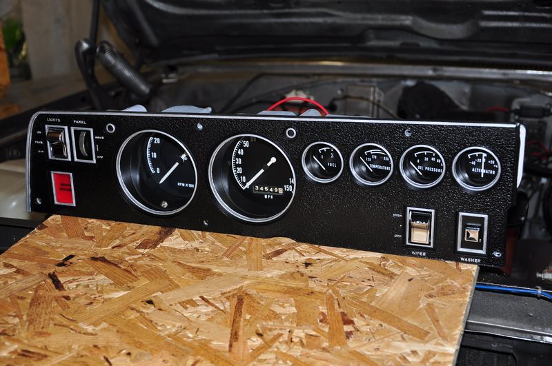

New gauge faces applied …

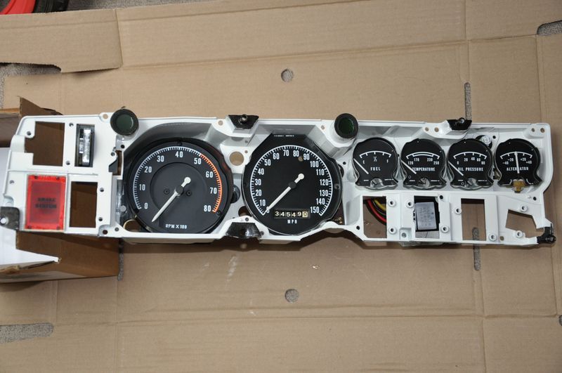

Got everything reinstalled …
The electronic 5v voltage reg fits well behind the gauges using the screw hole where the original suppressor used to be …
Tested all the gauges, backlights and warnings lights etc during the build up …

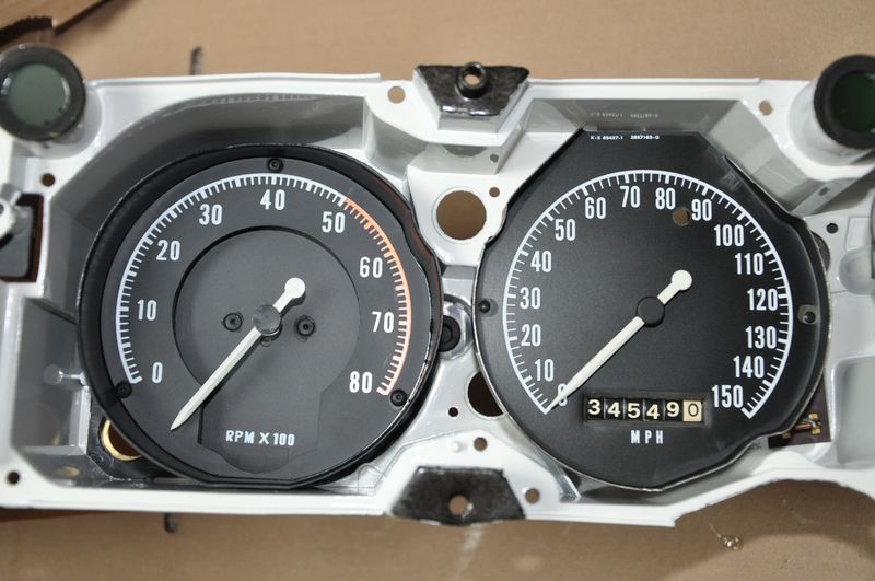

The finished Rallye Dash Instrument Cluster ready to go in the car

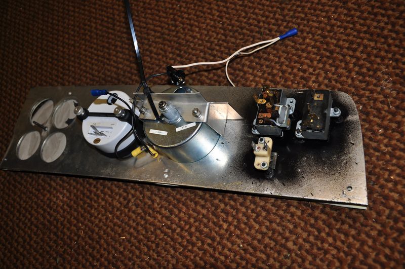

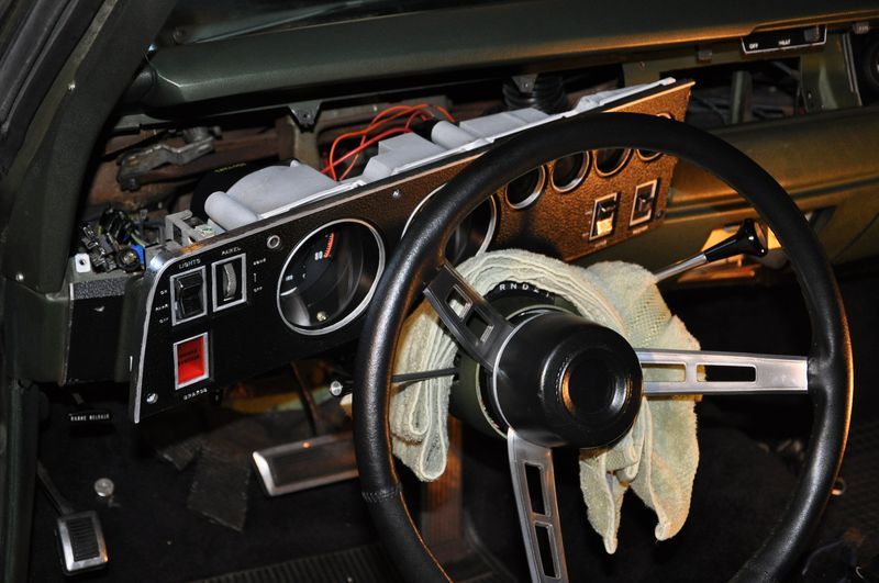

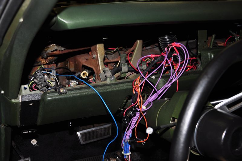

Next to rip out the custom panel …
The original wiring was all in place aside from the windshield wiper switch loom (lilac wires) that had been extended, this was cut out and restored to original …
Even remains of the charred ammeter wires, bypassed a long time ago …
In goes the Rallye Dash Instrument Cluster …
Job job’d …
Job job’d …
Everything worked a treat and passed MOT …

Also when you say "Brake and indicator lenses polished and reinstalled, dash panel painted and lined silver" Lined silver, how did you do that ?
