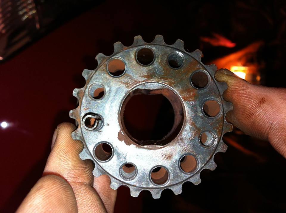

These are pages from the Kia repair bulletin someone has stuck online, and a pic of a knackered crank pulley.
Crank pulley damage p7.jpg (70.88 KiB) Viewed 4658 times
Crank repair p3.jpg (52.2 KiB) Viewed 4658 times
Crank repair p2.jpg (63.28 KiB) Viewed 4658 times

Yes that's it. Seeing that has reminded me of a kia we did a few years ago at a non franchise garage I work at. Similar story to this really, customer with misfire, I vaguely remember the old hyundai problem. Took the bottom pulley off to find the worn pulleys and crank etc. Tried it with new pulleys ,sprocket and bolt etc and fingers crossed. But it didn't fix it. BUT, even though the car didn't have a full kia service history and was out of warranty , after the customer complained to kia customer services they did fix it.
It may be too far out of warranty now to even consider it, but it might be worth a call if the car has a good service history and low mileage. Even if they only offer a contribution to repair..
