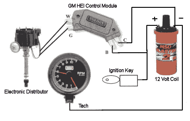

do you run the 4 pin ballast resistor?
has part of it died?
Miles is selling an HEI set up for £40
all you need for that is switched 12 volts from the ignition key and a place to bolt/earth the module.
provided you have a magnetic trigger dizzy
if it doesn't work with that its surely the pickup in the dizzy
although I'd be carful without working out whast wrong there is a small risk you might fry it
