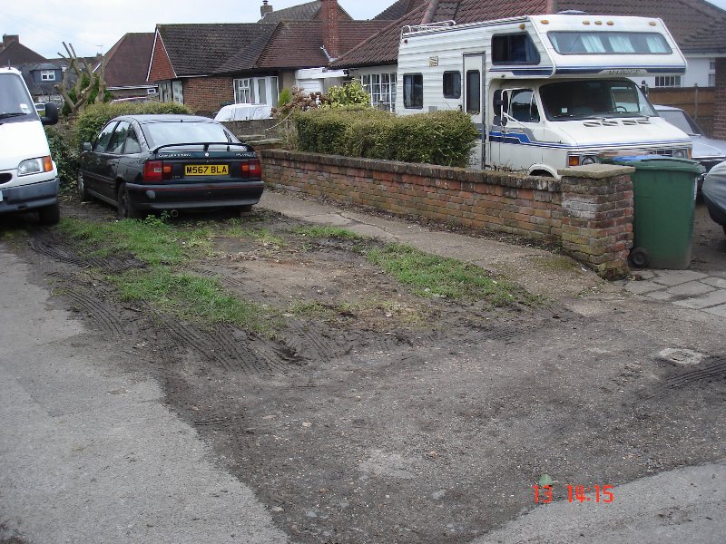

Ok anorak question, Now we have moved I need to get the front drive and garden cemented over (or maybe Tarmac). It will be more use to us for lots of classic car parking :D
My question is we have had a quote of £4500 to do it, have you guys had much cement work done? is this a good price.
What are your opinions between cement and tarmac? any advice is welcome guys. The size is about15ftx41ft

You got about 60 m2 there to get covered. Concrete you need about 12m3 which is about a grand but its all the other stuff like reducing the ground level, putting down a proper sub base, edging, drainage, expansion joints, labour and plant, etc. You need to know what you're getting for £4500 to be able to make a comparison really.

Thanks for the info, yes he is doing new edging blocks to define the edge of road and to define new path edge too. Also supplying new water main cover, digging out and removing soil and laying concrete with a brushed finish. The quote doesn't say what base he is putting down thou should I ask?
