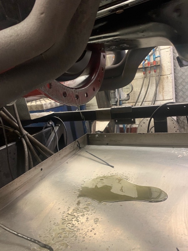

We inspected my 383/432 stroker yesterday. No obvious reason for the main seal oil leak, but it is a bad leak (see photo below from the dyno session). The guys noticed that the Fel-pro rubber main seal had left a mark on the crankshaft journal surface. Is this cause for concern? NB the journal surface is smooth, not knurled.

Post by DaveB »
Ring me, ill try and advice on rear seal issues, 07791 141170, regards, Dave

Thanks again for the advice Dave - will set the seals in the block and retainer with silicone as you suggest. I inspected the seal area myself last Friday and it didn’t look like the seal halves had been installed with a slight rotational offset so the seal and block/retainer joins are not aligned. This’ll be corrected next time, and the workshop will run the engine on their rig to see if the leak is still there. I’ve also bought a one piece Fast Fish seal from the States as a back up option. Watch this space...

Next question - the workshop guys are going to run the engine (at idle speed) on their test rig, to see if they have resolved the main seal leak, before putting the engine back in the car. They are currently considering how best to start the engine on the test rig. Obvious option is to hook up the A727 (with all the oil cooling plumbing connected) to the engine so the starter motor can crank the torque converter. Issue here is that the bellhousing will obscure any views of the main seal, so if there is still a leak they won't be able to pinpoint it. Alternative option could be to fit a manual flywheel to the crankshaft, assuming we can find one? Or would a manual flywheel obscure the main seal view so much anyway that we might as well just hook up the A727?

i can't remember if there's a tin plate between the engine and box, if so bolt the box on without it so you can see up to the crank seal area. it's probably the best view you're going to get and if the seal leaks it'll get thrown onto the flex plate so you should be able to see that at least.

Main seal leak sorted. Thanks to Dave B and others here for advice provided. Can't wait to hear what it sounds like through headers and a 2.25" stainless system I recently ordered...
