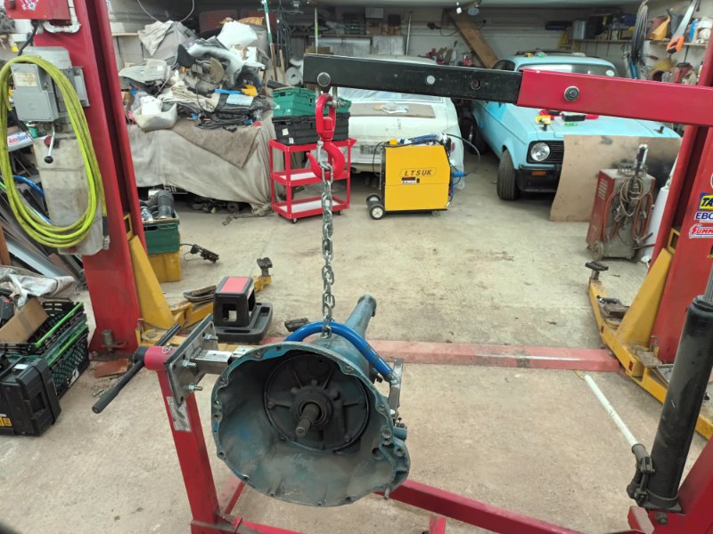

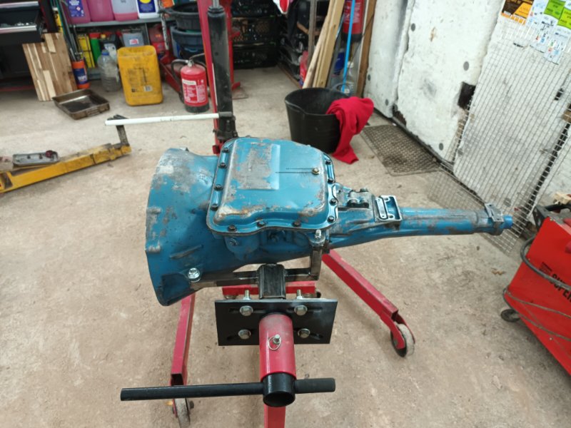

Well after 5 years on the bench, I made up a gearbox holding fixture to make rebuilding the box easier.
So much time has past, the Dart has been parked in the corner, under a dust sheet.
I'm looking forward to making a start now.
Posts: 3703
Re: Johnny's Dart repairs
Good to see you back on it :thumbright:

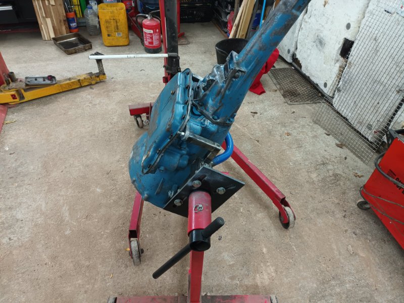

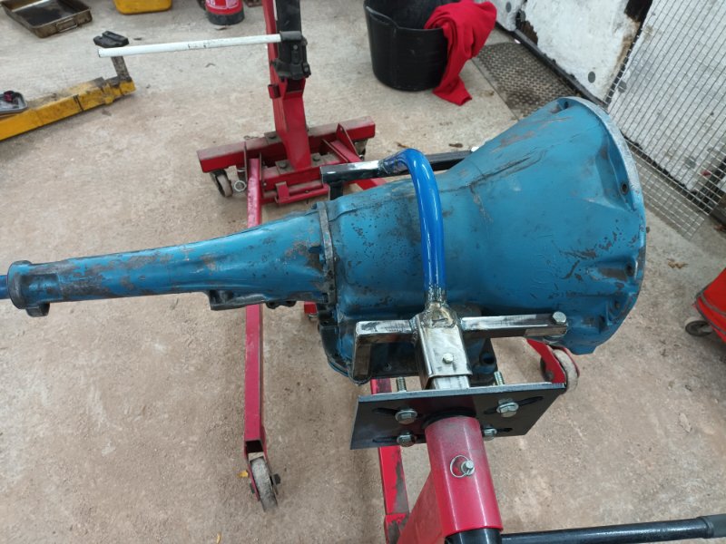

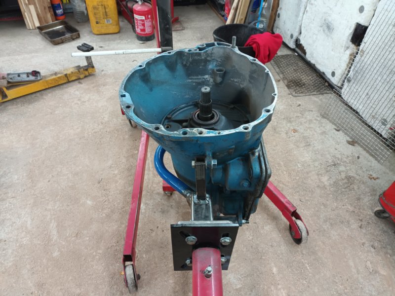

Not quite sure why they are not the correct orientation.
mygasser
Posts: 1611
Location: faversham, kent
Post by mygasser »
i don't have a 'smart' phone but i've read about this issue on other forums. i'm assuming you took the pics with your phone so you may hold your phone any way up and they will still show on your phone's screen correctly. however when transferred they show in the orientation that they were taken, so if the phone was sideways to get the shot it'll display 90 degrees 'wrong' on the forum. you have to rotate them on your phone apparently so they show correctly on here. pretty sure that's what i read, but it was a couple of weeks ago and i've been asleep since then so.....

Thanks, I tried that, I must be doing something wrong.
:-k
Posts: 14598
There seems to be a random issue with photos coming up the wrong way round. One or two photos posted at once usually is fine for me but post more than 3 at once and it all goes wonky.

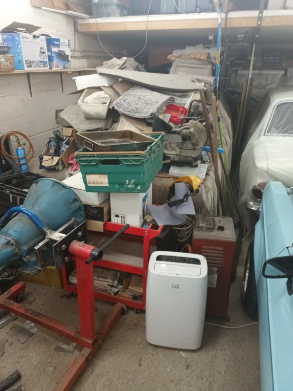

I haven't been on here for a long time, as "other" projects have got in the way , and the Dart has been tucked up in the barn hibernating, waiting for me to attempt the auto box rebuild.
I'm hoping to start again this year :oops:
