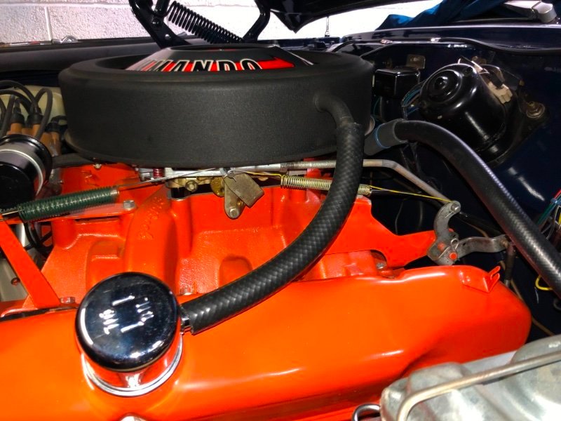

Re: Phelonic Carb Spacer
Thanks as always Dave, your knowledge never ceases to amaze me!
The flap is over the smaller bores and I am happy its just a choke flap. Ive decided to just fix it open so if I ever decide to wire the choke up in the future, it will all still be in place. Im not sure if I ever will but if I take them out, Im not convinced I wont lose the parts
The choke body has a coiled spring in it that hooks behind a lever that moves the flap as the spring uncoils when the power is on. It has a 90 degree bend at the very end of the spring. Ive basically put the spring the other side of the lever so it efectively pushes the flap to the open position permanently. I havent altered any parts so it will all go back to normal if needed.
The manifold is PN 280631 which is the original 68 HP 4 barrel manifold so I have gone for the matching ported spacer that matches the bottom of the carb and the 4 manifold apertures.
Ive got a small issue with a tiny bog if I put my foot down so while I was rebuilding the carb I cleaned and tested the accelerator pump circuit and have changed the metering rod springs to one step stiffer. Hoping all of these things combined will help with the fuel percolation and bog....fingers crossed

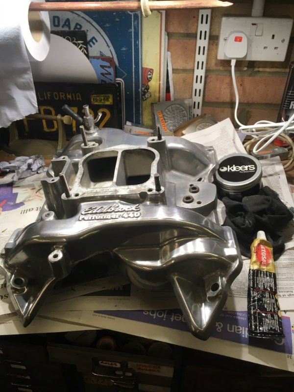

What about 2 holes.
- IMG_4474.JPG (118.74 KiB) Viewed 11466 times
I’d use a 4 hole on that as well. Also make sure the holes in the spacer and indeed the gasket are the same size or bigger than the carb throttle bores or else it will act as a restricter.
The spacer I have ordered to replace the 1" has 4 holes the same size as the two larger bores and the holes in the manifold

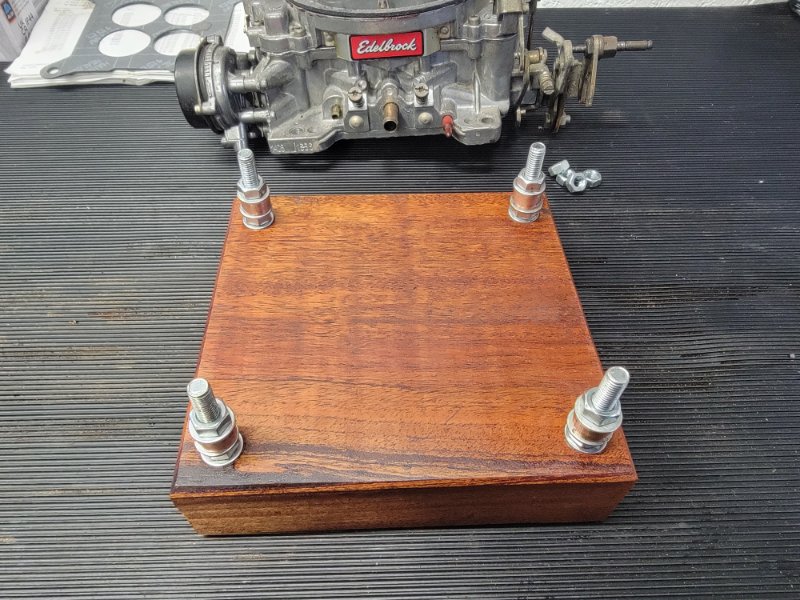

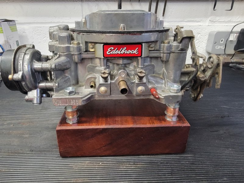

Been treading water this morning waiting for the spacer to land so decided to make a carb stand. It keeps all the linkages off the workbench and keeps the carb steady. Wish I had made it before I started the project...typical
