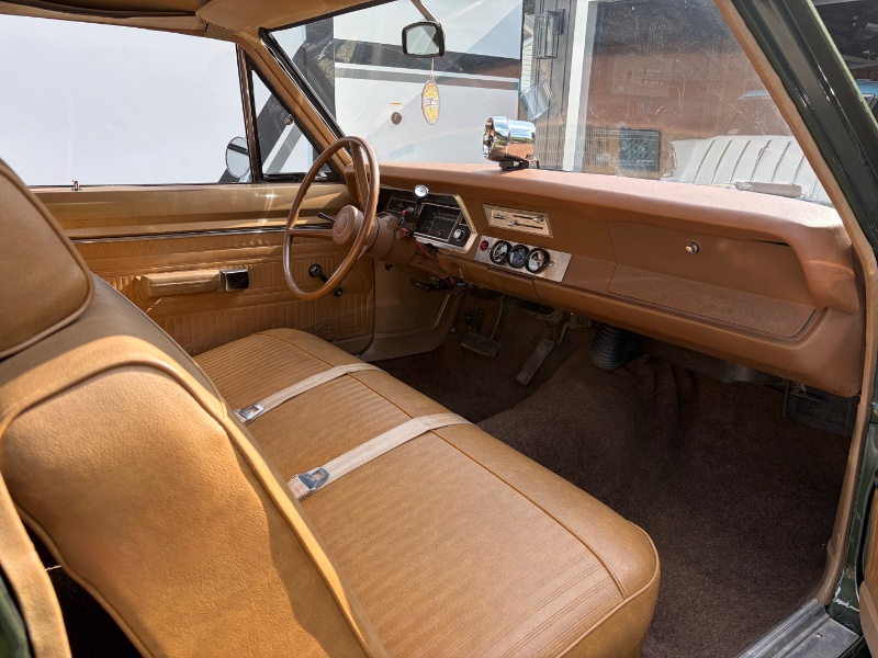

Interior back in apart from under column trim.
Had to do a quick fix on the rust I found. But have ordered a new floor panel for that area. Luckily they have one down the road a bit in national mo-parts.
But that job can wait.

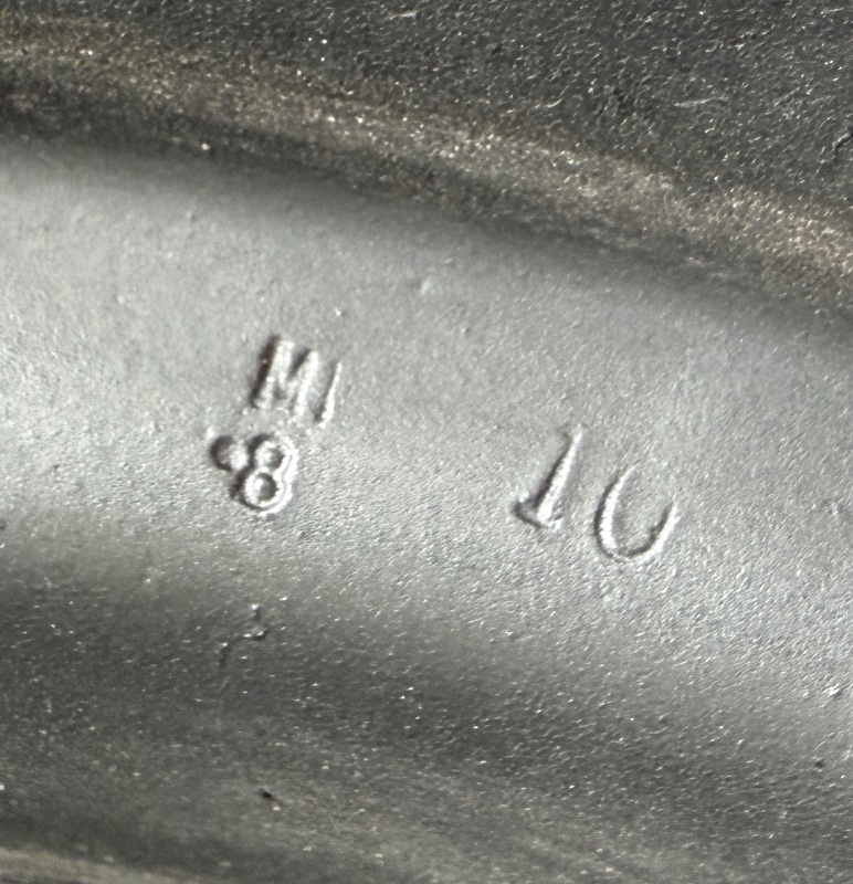

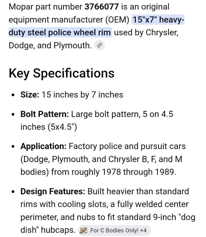

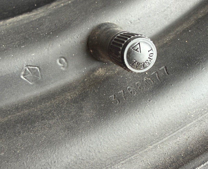

Found the rear wheel info from stamped numbers on them.
- IMG_6390.jpeg (148.67 KiB) Viewed 307 times

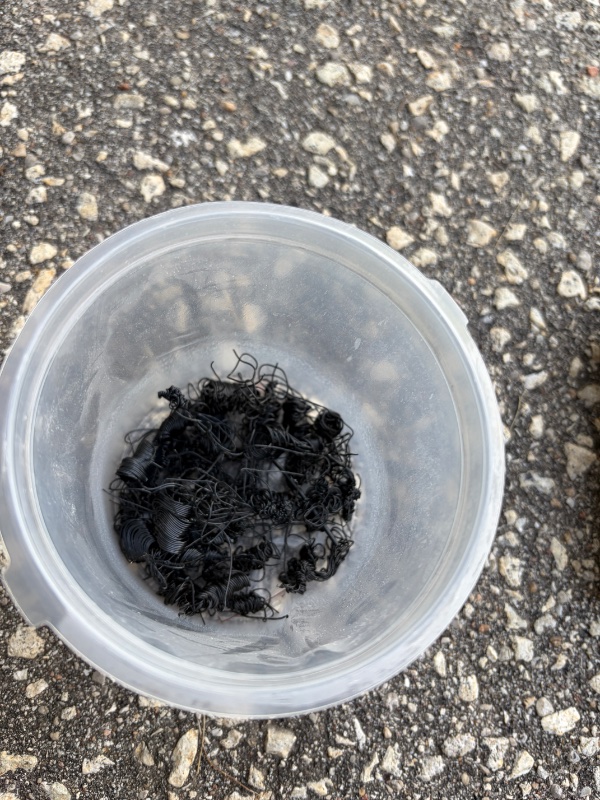

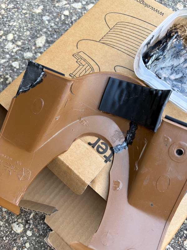

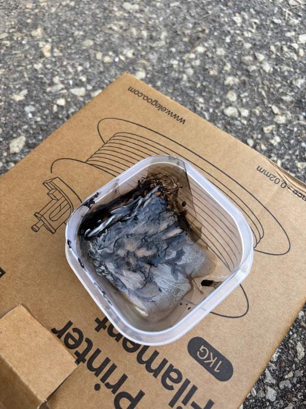

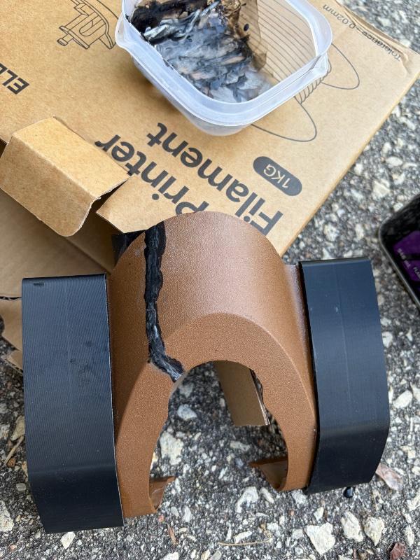

So I got the ingredients to mix some ASA slurry.
It is a melted plastic, that will bond with the original plastic. Just mix the raw ASA plastic with Acetone. When it has melted to a paint like consistency, brush into the crack.
It will go off quite quickly. Going to leave this overnight. To totally harden, then start sanding.
- IMG_6405.jpeg (279.66 KiB) Viewed 105 times
- IMG_6406.jpeg (246.4 KiB) Viewed 105 times
Re: Jeff’s ‘69 Valiant

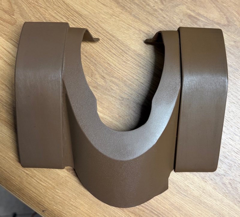

well, it aint perfect. Still more to do.
- IMG_6407.JPG (213.35 KiB) Viewed 80 times
