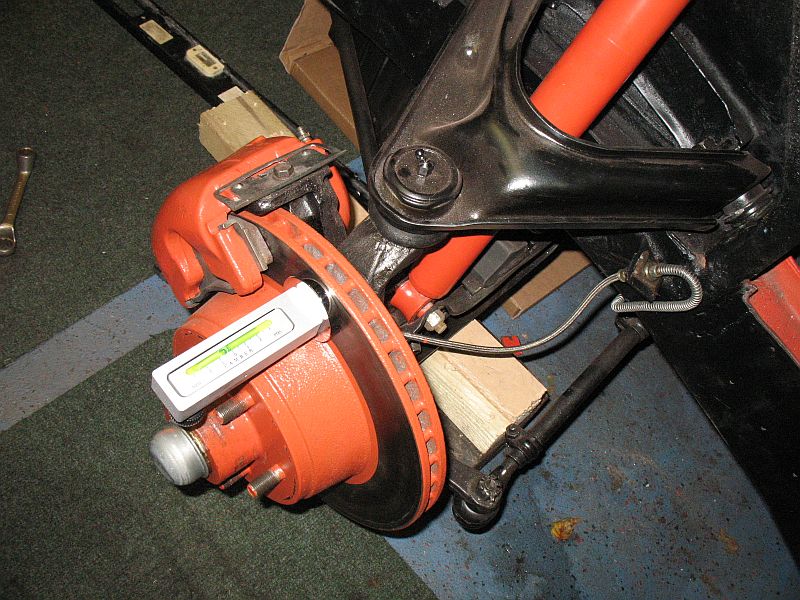

Decided to set the front wheel alignment.
I started off by getting the car as level as possible. Also resting on the LCAs at about ride height.
I set the UCA bushings full in at the rear each side and full out front in order to set max positive caster.
Checking each brake disc with a plumb-bob I could see that each disc was very slightly positive camber by the same amount each side. This confirmed my spirit level readings for the car to be correct.
I then wound in each front UCA bush very slightly to get zero camber on the plumb-bob.
I then zeroed a magnetic camber gauge on one disc at a time and wound in the front UCA bushing inboard some more to give 0.5 degrees negative camber.
Dialing in the front UCA bush also decreases the positive caster.

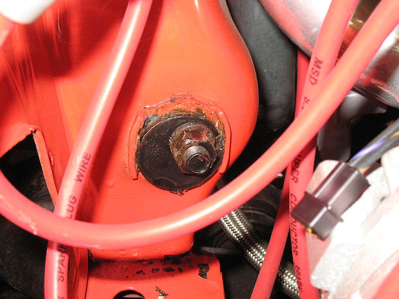

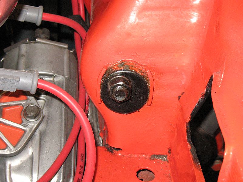

Looking at the adjustment cams on the inner fenders when i had finished they look to be set exactly the same each side so I think i have it right.
I would normally put a bit more negative camber in but have decided to go for slightly more caster this time and see how it goes.

You were right when you thought one wheel looked like it had more camber than the other in photos. That means it must have had more caster on one side than the other too.
So much for a "professional" job. :roll:

I spent a day doing that on the Barracuda with gauges, Dave - Set it perfect and it drove awfull. Pulled one way on acceleration and the other on braking.
Set it again for maximum caster, bugger the camber, and hey presto! drove like a dream......hope yours works out better. I am convinced this was the cause of the weave at the top of the track.
Dave , are you setting the steering geometry as a mirror image of the FSM?
Mick70RR wrote:How much caster did you end up with Dave?
I knew someone would ask this but i lived in hope.....
The answer is i don't know and I don't care. I have fat tyres and manual steering in a 4000lb car. Too much caster I can do without. :lol:
I can work it out by using the camber gauge but it is a pain in the bum to do and not necessarily correct when you are done.
Pete. I had more camber and less caster before and it was fine so it should be OK?
What the hell. It is easy to change. I will see what it is like.
Adam68 wrote:Dave , are you setting the steering geometry as a mirror image of the FSM?
Possibly. The FSM needs to go out of the window mate. The spec designed for old ladies and Yanks that like light steering and not performance.
Obviously the more positive caster (and toe-in) you have the straighter the car runs. But you need negative camber for cornering and controlling under-steer (in a big block car in particular) because the cornering forces induce positive camber which limits lateral grip from the tyres.
If i was setting the car up for drag racing I would have dialed in ZERO camber. That would have given me a LOT more positive caster. But my car has never been set up for drag racing and never will.
