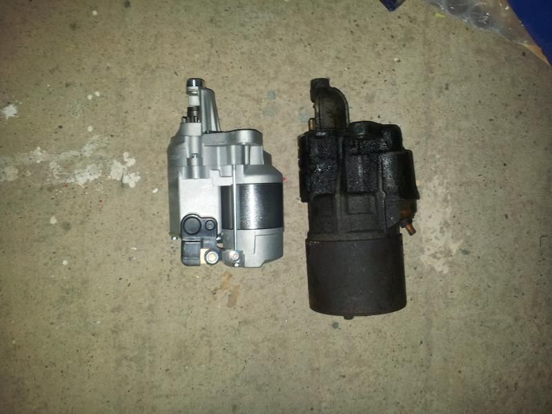

What an Absolute BITCH it is to do when the car is foot off the floor.......Torsion bar, exhaust, steering linkage/pitman arm. and a fat lanky man with ape arms lead to it taking 3 hours only to be defeated by my blood pressure in the end!
Managed to get the old one off, but just couldn't get the new one in with the wires connected. Took wires off bolted in.....try to reconnect and I lose the Starter relay post nut..........Do you think I can find it.....Even with telescopic magenetic....just no hope.
I gave up at 10.30pm last night and looked like a black man from the elbows down!!!!
The old ones weigh a ton........

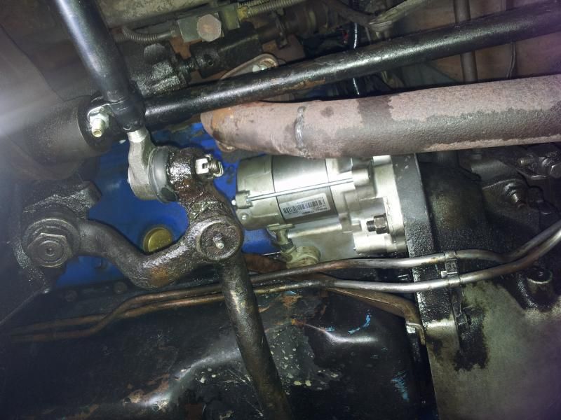

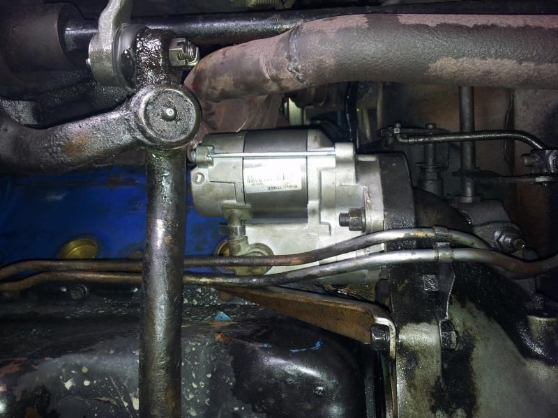

I had tried before but trying to get the mini starter in with the cables connected is near impossible (especially when not on a 4 post lift). It wont clear the Steering, Torsion bar, exhaust or trans cooler lines.
Get past those and then hook it up and its easy.....ish!!!!
For those that have yet to do it and have yet to understand the contortionist fun........Here's what I spend 4 hours under!!!
Directly underneath..........

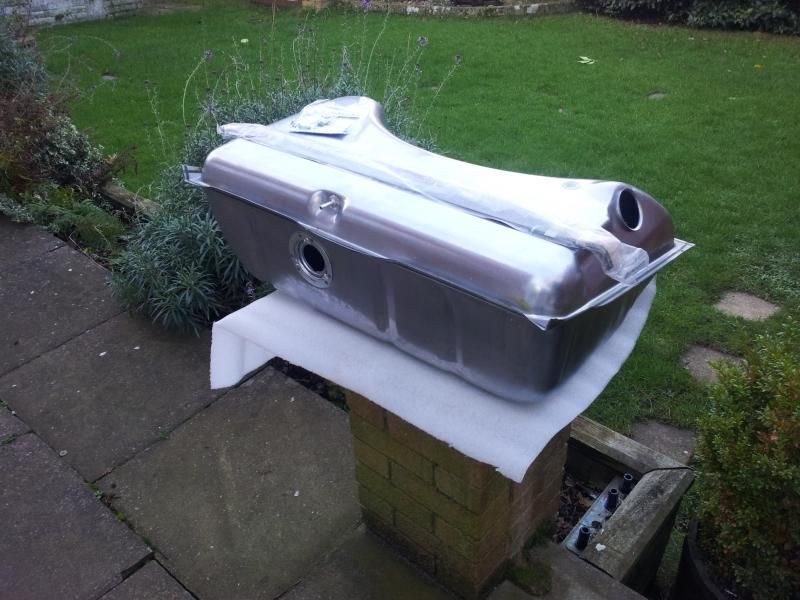

New Gas Tank:

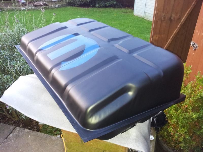

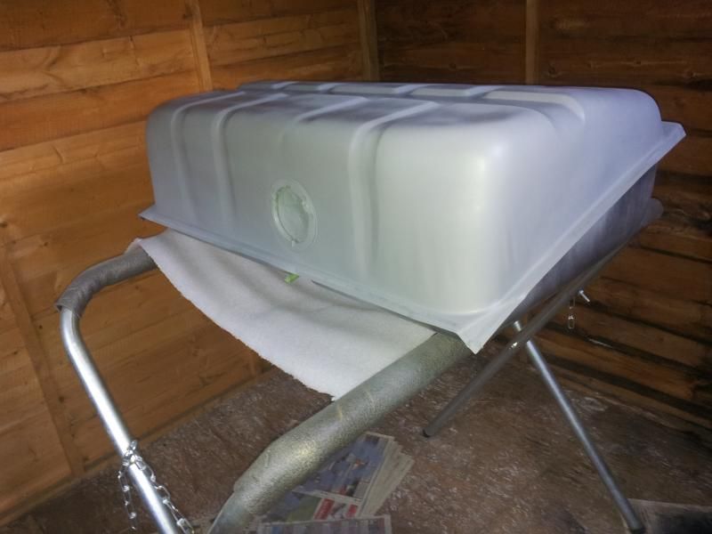

Degreased it, added primer, matt black paint and a little finishing touch:
Not 100% completed as cold weather/Slow drying times and lack of light put pay to that....just need to tidy up the decal and clear lacquer to Bananarama! off! :thumbright:

Hi dave,tank looks great, if it were mine while the tank is new and out ,would coat it inside with P O R tank sealer available from frost ,its ,an excellent product, check it out. Richard.
Looking good Dave. Like the little detail :thumbright:

Even less room for the starter when you have headers. Like the little touch on the fuel tank. What else is left to do, you must be almost there now?

Posts: 5254
how did you do the Mopar logo??
looks neat

Posts: 7149
Charger wrote:how did you do the Mopar logo??
looks neat
Printed off the logo from the web to a size I wanted and used it as a guide.
Light pencil marks and then taped it out.
Painted the whole tank black first then blue on top.
Not 100% happy so gotta do finishing touches before I lacquer it! :thumbright:
