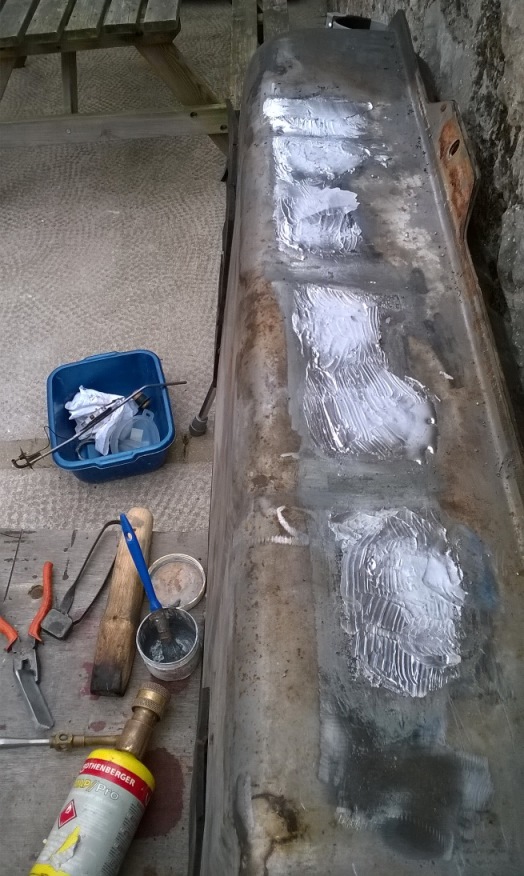

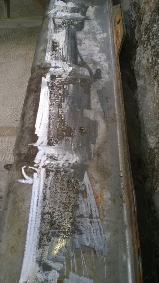

So my star mate Doug came round earlier and between us we got the fuel tank out and emptied it.
The tank underside had a bit of rust! I got my co2 tank from the welder and flushed then filled the fuel tank. I put my leading skills to good use and it's hopefully fixed :thumbright:
I'll test it in the morning, fingers crossed!

Got the tank back in and it's leak-free 😊
Well done fella love this truck :thumbright:
Nice one mate. See ya at the Nats :thumbright:

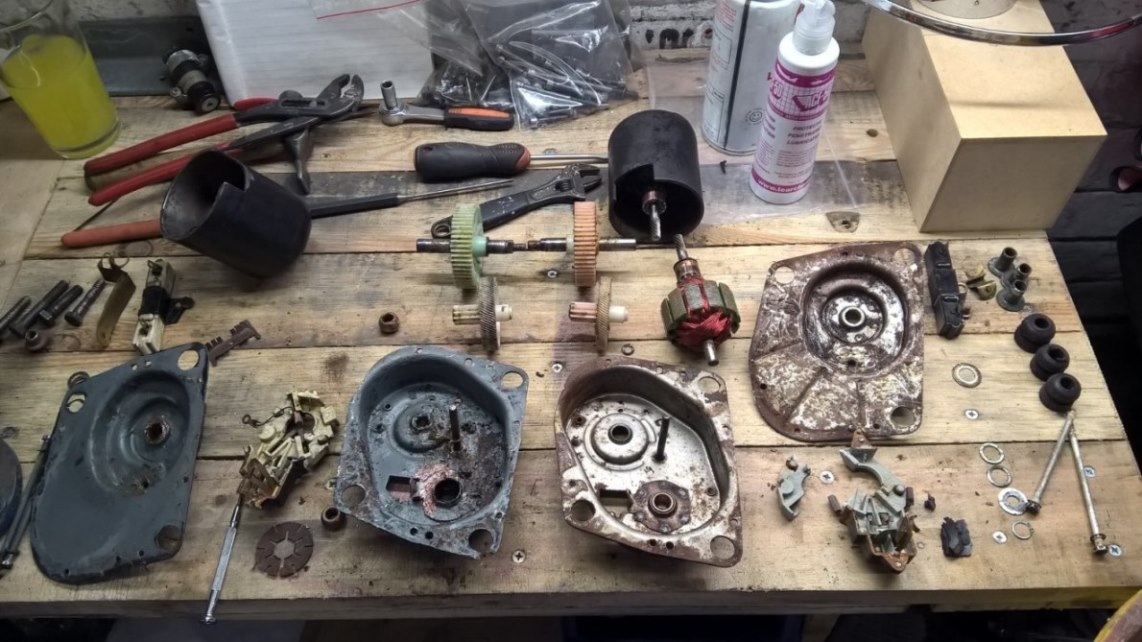

I eventually got fed up of the constant running water through the cab so I tackled the roof the other day. Lots of grinding, sealant and fibreglass, some rust killing and a slap of paint. NO water now enters through the roof or windshield.
It is still pouring in from somewhere though! :P

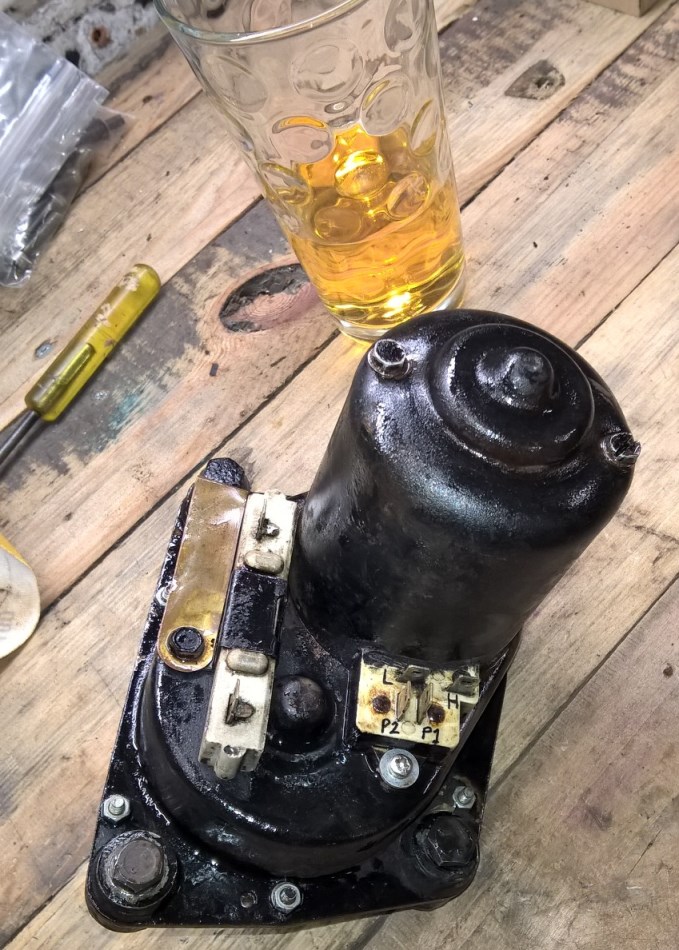

I've also had no wipers for a few weeks due to the motor (which I bodged several years ago) packed in again.
I was sent a used one, which also turned out to be faulty. I decided a couple of days ago to see if I could build one good one out of the two.
Motor 1-
Rusted case which I'd previously welded and which has now rotted a lot more.
Semi-seized bronze bushes
Bearing retainers broken
Broken braid on one motor brush (this is why it stopped)
Rubber mounts disintegrated
Motor 2-

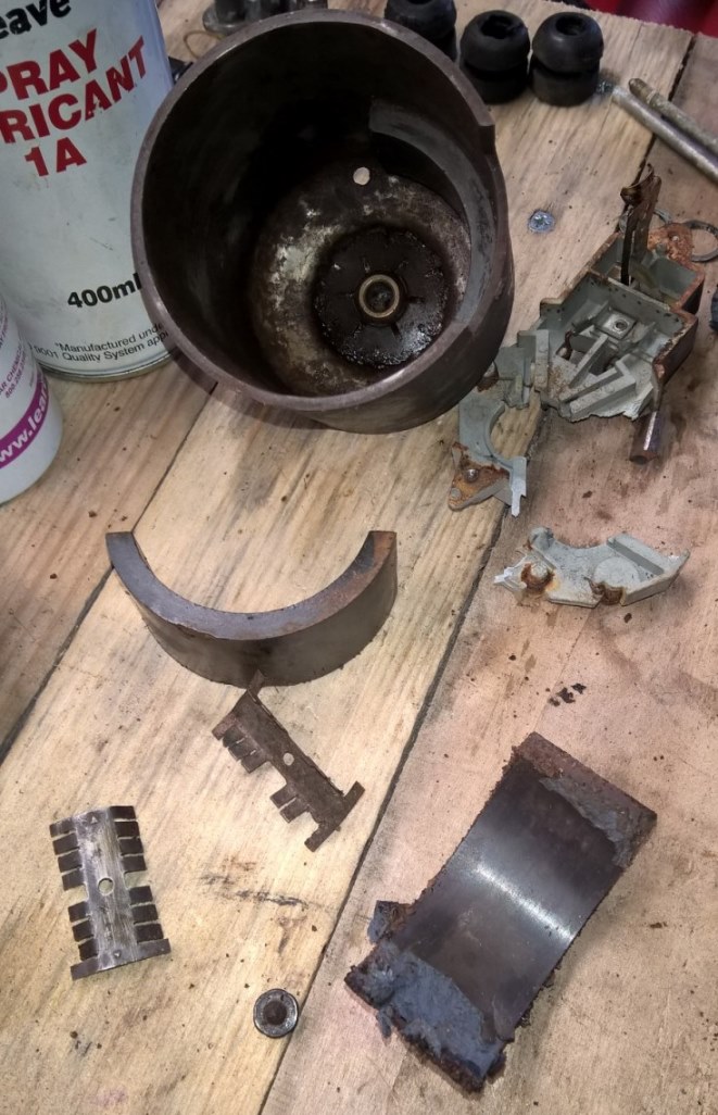

Motor jammed solid with rust
One motor magnet disintegrated
Motor brush springs rusted to nothing
One motor bolt sheared (They're aluminium fer chrissakes!!!)
Plastic wiring module thing fell apart
Luckily I've salvaged enough parts to cobble a good motor together.

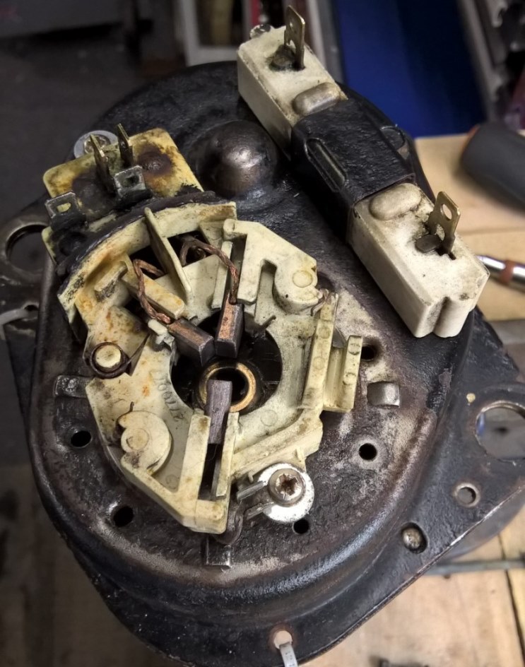

This link is fantastic- http://www.passion4mopars.com/Bench-Tes ... d_b_5.html
I tested it and it still didn't work. I took the motor cover off and found on brush had stuck in it's guide. Bugger!

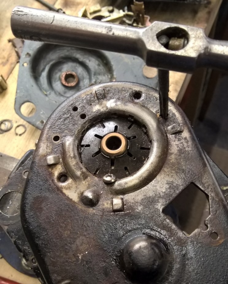

The armature was also tight in the bearing so I pulled it out, which broke the bronze bush retainer. Double bugger!!
So that's it for this evening. I have a cunning method for repairing the retainer which you can see I've done in pic 2 to another one. This one, however, is in the bottom of a metal case surrounded by magnets so it's hard to reach and everything gets grabbed by the bloody magnets!

It works! :D
It put up a fight, it took me an hour to get the bush retainer in place. The 20th time the bloody thing pinged and stuck to the magnets it very nearly got hurled through the window!

Well done, persistence pays off!!!
Nice one Paul.
Miss tinkering (bodging !), with me old truck. :(
Well I've used the wipers a few times now and they work great! Quiet too!!

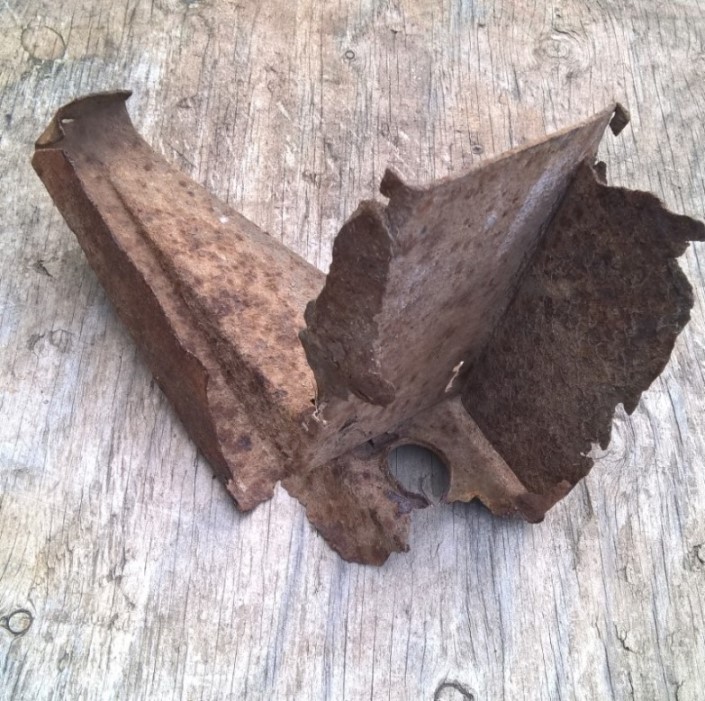

After all my work on the roof and the screen surround to seal out the rain... it's still pours in :P
Also it seems worried about it's weight. It's shed a couple of pounds.
I hope it was nothing important :shock:
Truk rust.jpg (206.62 KiB) Viewed 1608 times
Posts: 22111
Don't worry; its just passed a stone! :thumbright:
Yea they had extra steel,so they just put it on..........but there is what looks like a hole for a grommet,or a wiring pass through :shock:
Yes Drew, it was dangling from some wires when I found it. Luckily the wires are stronger than the steel
