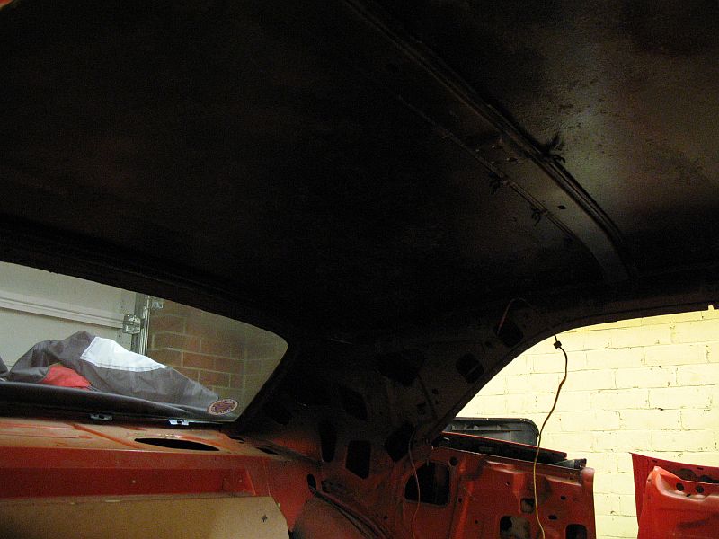

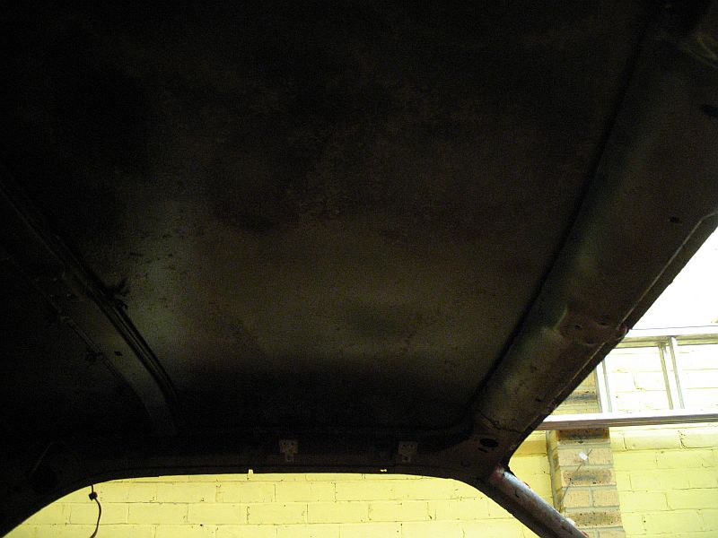

Had to get rid of the headliner and sound deadening because it was rotten. I have a new headliner from Sixpack Speedshop that arrived yesterday. It will probably be next weekend before I fit it though.
After treating with epoxy rust converter and a light spray of cavity wax it looks a lot better than it did before. It will never rust again which is the main thing.

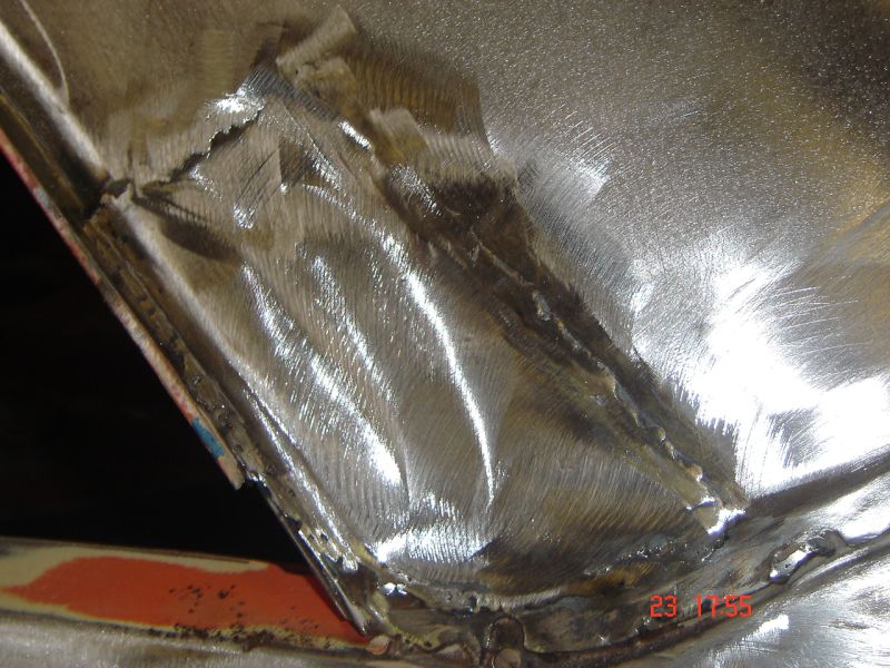

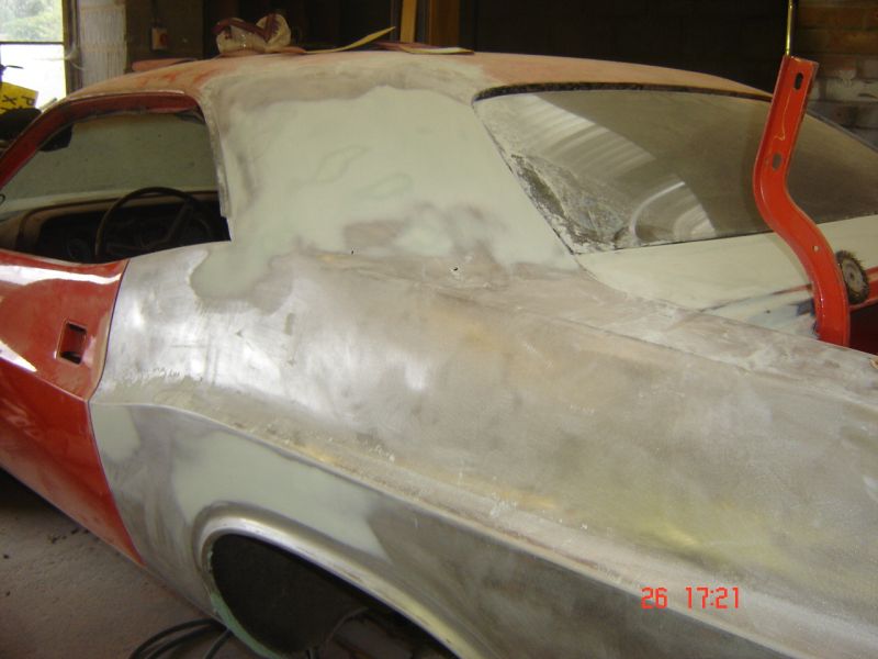

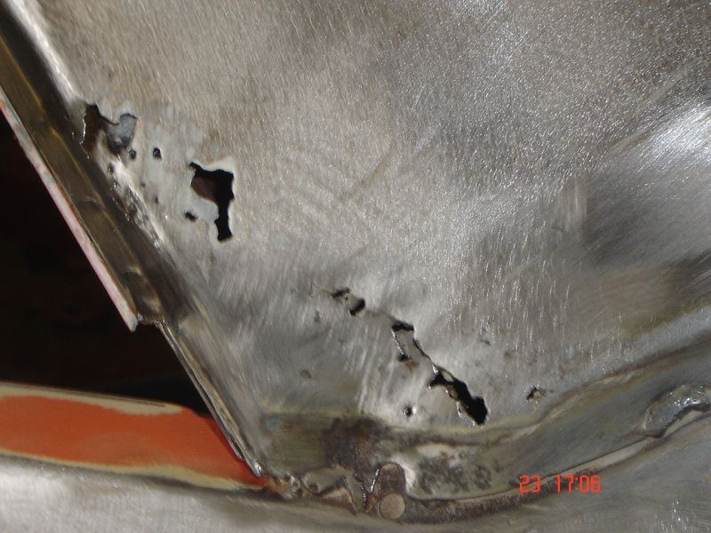

Matty took it down to bare metal on the top side when he did my bodywork. There was one place he had to patch but it was just above where the join with the quarter panel is? (See photos)
You have to remember that I had the car (plus roof under the vinyl) resprayed back in 1989 before it was shipped to the UK so it has been quite well protected since despite having to sit outside for years.
As I said. The inside was just very fine surface rust. Probably from condensation.
Wire brush in the drill took the thick of it off. I didn't want to take it down to clean bare metal though just in case I did go through anywhere. Plus rust converter works better if there is still oxide at the surface. As long as it is not loose oxide. The finish is totally inert and hard as a rock. I gave it a fine spray of wax just because i was waxing in the cavities anyway and i was thinking "belt and braces".
