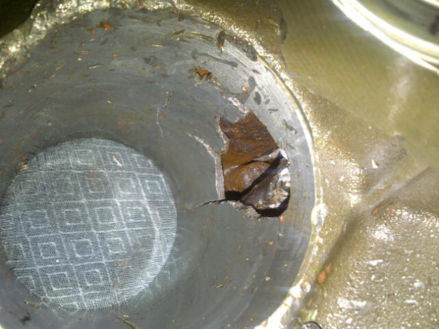

It should be fine, it was still running consistant 9.9's, launching a 5 and shifting at 6500, It looks like there is a crack in the block letting the water into the oil, so it should just be a case of getting the block machined and swapping everything over.

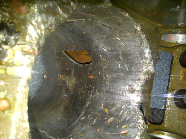

Finally got to strip everything out, I,m not sure if it will run again :oops:

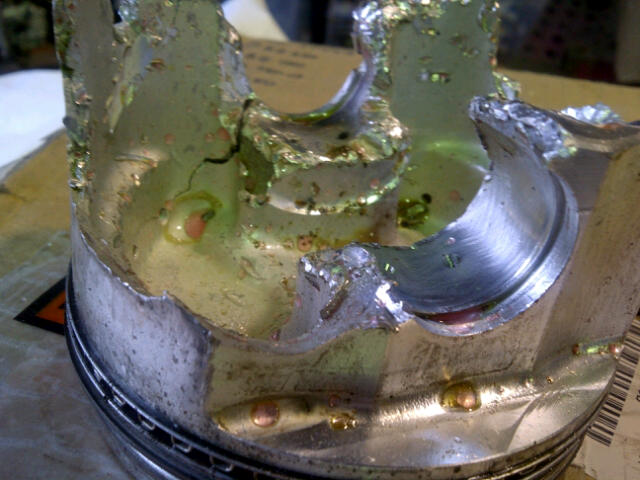

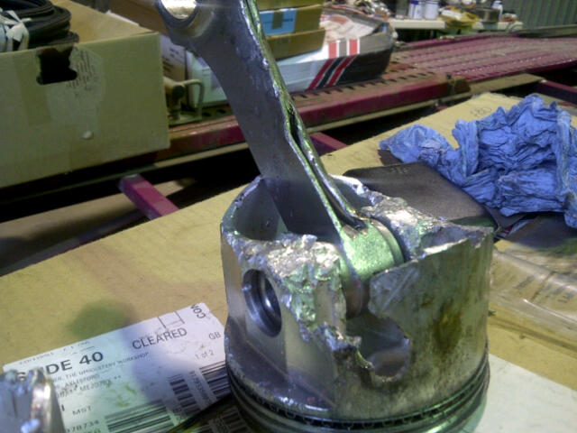

Post by Turnip »
More
Posts: 22261
Ouch!
I doubt that will hone out......... :cry:
Clearly a weapon of mass (self) destruction.........
Posts: 13003
That is well and truly mullered...it's definitely a case of start again from Scratch...sorry to see such carnage Jon.
I've only had an engine go to a similar extent and I just wanted to throw the whole lot in the skip and walk away, but like a mad person, started again!
