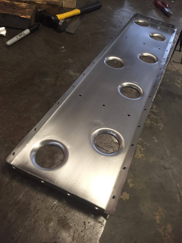

Take one perfect rear tailgate, and cut it up!
Jeff

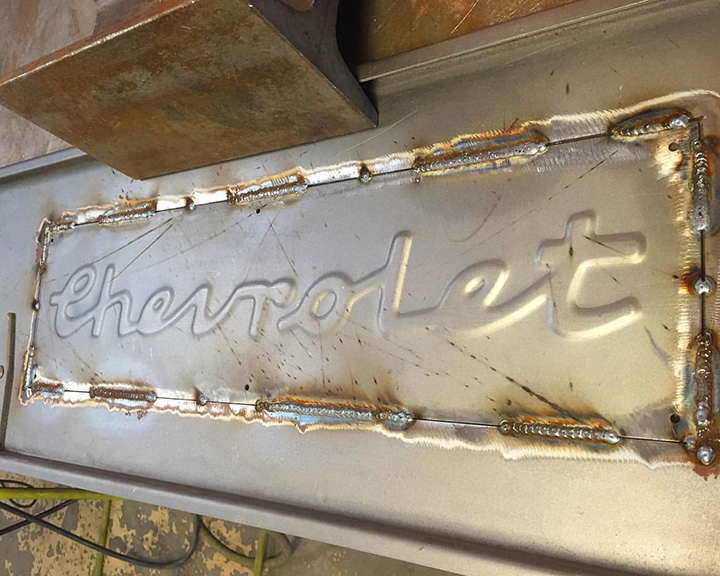

Post by Jeff »
welded...

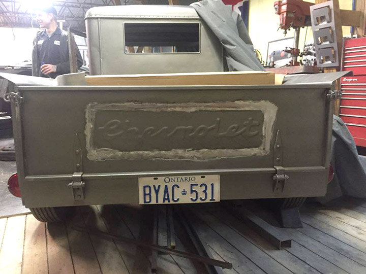

Post by Jeff »
Gonna need a skim or two.....

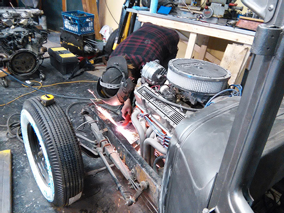

Tools used today.... Big ol electric static metal saw. Mig welder, gas welder, plasma cutter and 1964 snap on air chisel! What fun we had! So nice working from a fully equipped shop.
Cut the front crossmember out today, that. Was a tad scary. Dropping the rad, and moving it back slightly is proving to be very difficult!!

Yup Blue... New crossmember should be in this week... Going to have to steal lower rad parts from a Jag to make this thing look and fit right. Channeling a truck 9 inches brings a lot of problems with it!

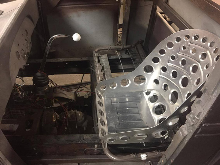

Started making seats today, not sure if I am going to do 2 of these, or do a bench seat in similar fashion.... This is just a quick mock up one. Final will be much cooler!
