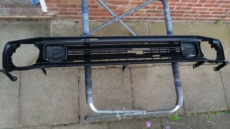

Update:
Slight deviation on the factory grill.....Firstly like most 40 year olds its seen better days. Few bits have broken off and the silver accents have worn and now look grubby.
It all adds to the character of the car I suppose!
I love the Dart, but if I'm being honest the grill in 72 was a slight step backwards to previous years. This was made worse by the silver accents exaggerating the HUGE indicator covers.......bit too fussy!
Its just not mean/sinister enough, so after watching Big Muscle with the Identity crisis Dart.........
Before:
After:
