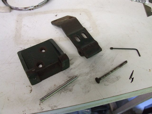

thought i'd have a look at the boot hinges. Boot didn't sit right and one hinge had loads of play.
Removed the hinge to find what looks like a nail as a pin.
found some silver steel rod the correct size that i had kicking around and repaired it with a grub screw to hold it together.
then i though i'd just have a look at the other one. Turns out it has a snapped pin and was only just holding together. had to drill this one then did the same repair as the other one.
needed to remove a broken bolt from the boot lid (yes using the English terminology) that wasn't tight in the thread but had 'just' snapped?
then i took a closer look and discovered that the bolts holding the hinges to the bodywork should be countersunk not standard bolts. obviously it had been binding and caused the bolt and hinge to snap. Plus it would be impossible to align hence the poor fitting.

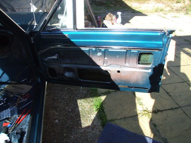

since the passenger door now fits better i removed the door card to wax the internals.
tons of leaves in the bottom and no door membranes. Going to have to redo the door cards as they are now warped.
Lubed the winder mechanism, pinched the drop glass guide so no more free-play and drowned the door with Mil-spec wax.
replaced the door seal and door now sounds really quiet when shutting

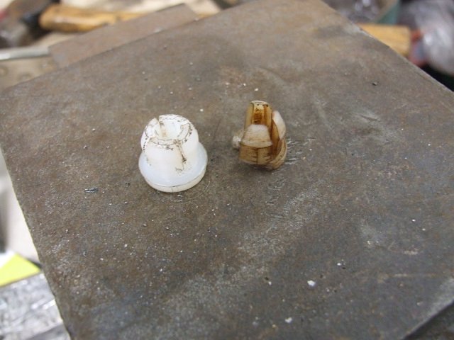

finally got the passenger rear window sorted. Took hours because it wouldn't go up the last half inch without force. Eventually traced it to the winder mechanism bent, probably due to excess force over the years, so a few strategic bends, readjusted and it now goes up as it should.
Onto the drivers window. that had about an inch fore and aft movement as well as up and down play. Traced that to a plastic clip broken. Made a new one and that sorted the play, rear guide trim was beyond repair so i cut some thin rubber backed carpet into strips and glued that in, works and fits perfect.

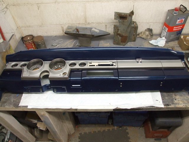

but for now
a bit bling?
much nicer to look at.
i have a chrome old style modern DAB radio on the way which'll suit the dash.
