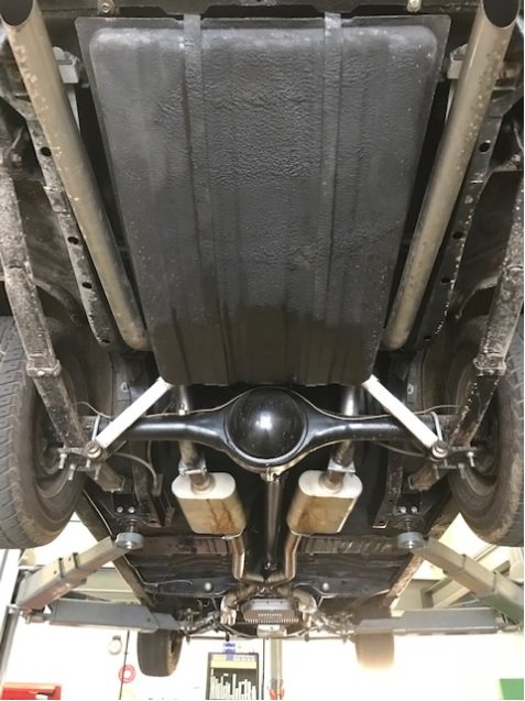

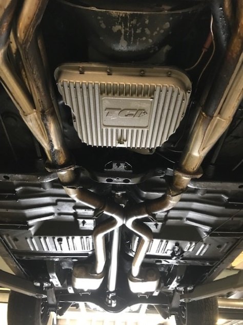

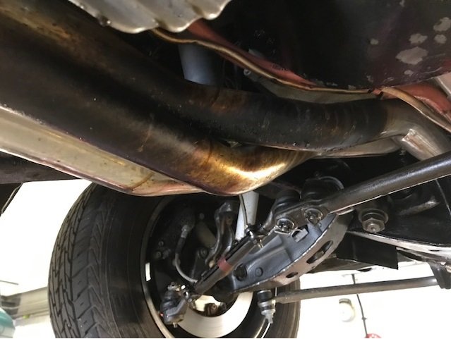

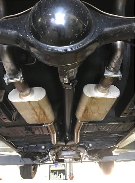

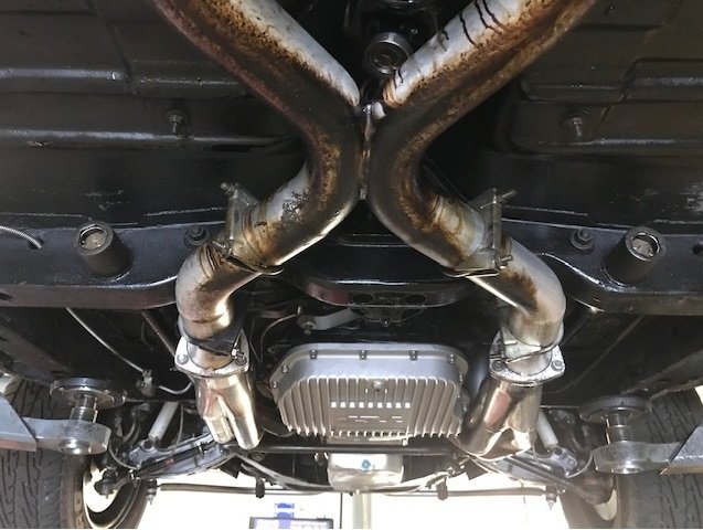

Go on then. I know you are all dying to see it... When I referred to 'moderate oil leak' this is what that looks like after 320 high speed motorway miles... My underside is slightly on the stained side !
No wonder it lost a bit - looks like rear main. There is a bit dripping from a rocker cover (I am biting the bullet and fitting the chunky mopar performance ones so that'll sort). But the rear seal is annoying. I should have done it when it was out (I was told) but ahhh. Whayagonnado ? Live and learn. At least its leaking oil out rather than burning oil in !
Look at the exhaust - oil bakes nice onto ceramic headers doesnt it ? :)

Doesnt look too bad...tell-tale stain on tank
Note the oil on the silencers...
Aw dammit...
Aw dammit...
Still. Rust protection I suppose.
SSSmokin' !!
SSSmokin' !!

Now that looks familiar! That burnt on oil takes some getting off the headers.Bet your rear tail lights and bumper were also suitably sprayed.
Quite an easy job, not so good laid on back tho.

I'd call that rustproofing.
Re: Morgans 68 Charger. Engine #3...
Roger S wrote: Mon Sep 09, 19 8:50 pm That burnt on oil takes some getting off the headers.
Rog
Oven cleaner :reindeer:

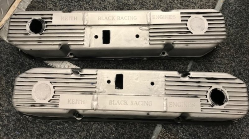

Well, given that the rockers have to come off anyway I took another look at those old finned ones that came on the Bob engine.
(I dont know whether they were actually used on it in anger, as it had orange ones on there when I first saw it - but I guess these were used at some point. )
They are fairly tatty but straight. There are a couple of bits that need a quick tack (the welds on the 'Keith Black' plates dont quite run to the end). The odd holes in the middle need a plate, they need a paint/powder.
Anyway, I decided that in the interests of nostalgia they are worth saving. So today I took them over to a pals and borrowed his blaster-booth. They came up OK - at least I can see what I am dealing with now. I'm going to paint/power them black, rub the fins back to silver, engine lacquer them and put them back on. The whole vintage 'Keith Black' thing stamped crudely is pretty damn cool.

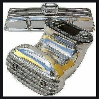

Q - Whats with the holes in the middle of the cover ? Breathers are at the ends like normal so I assume something else was fitted here at some point ?
So - Here we go, blasted up pre-paint. More to follow...

I would guess that the Rocker Cover was cut for 426 Hemi style hi-Rise Breathers...
Old style stand up breakers like I use.

err OK. (googles frantically - see pic)
And I'd want that why exactly ? I think I'll plate it over unless you guys are face-palming at the moment...?
Edit - Ooh ! crossed with Blue. Yes, OK, I see. But is that 'better' or just 'period' ?
Less propensity to spray an oil mist everywhere as you have raised the point of the escape to atmosphere from where the bulk of the oil is...
I run them on the 572 Hemi... but I have modified them and they are piped to the Headers.... sorry, no picture...
