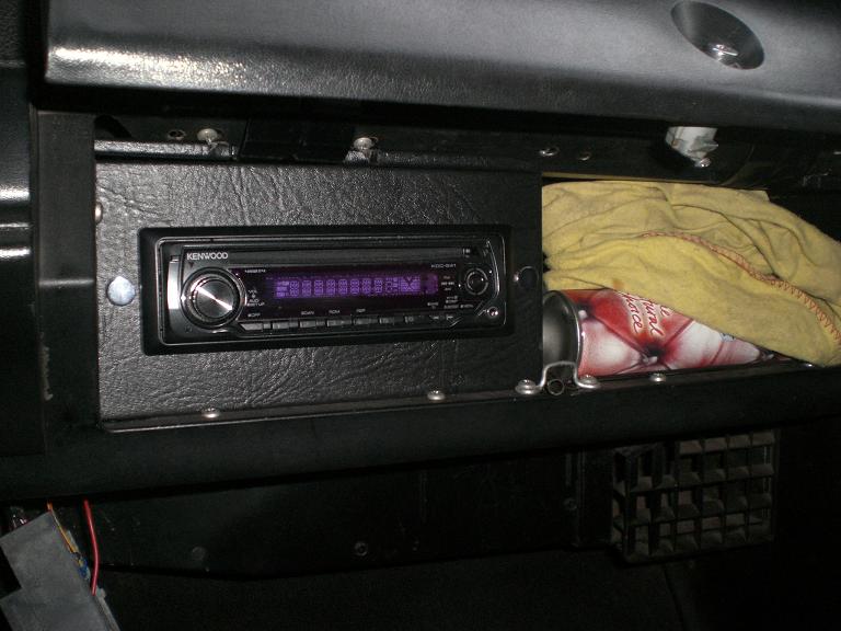

Here are a few pictures of the new stuff.
New Stereo fitted in new vinyl covered glove box made by myself

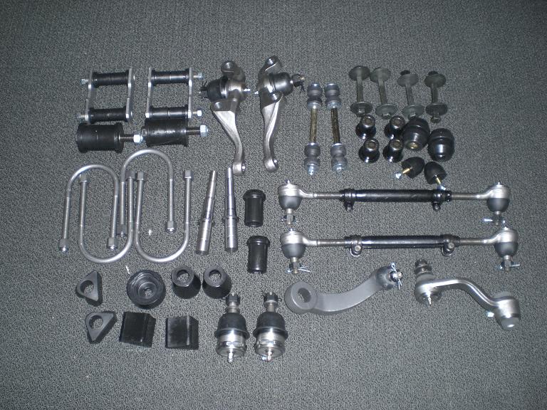

All new suspension from Beaver Bushes

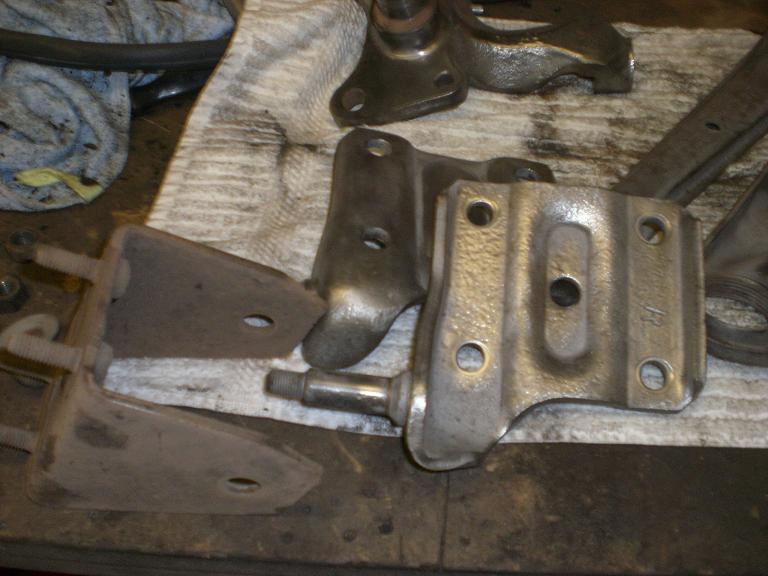

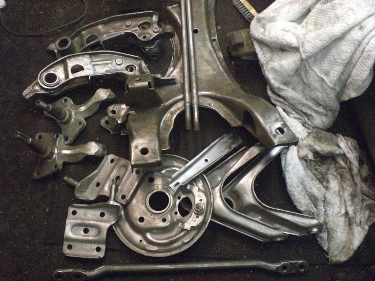

The cleaning of all the rusty parts is going well.Only the rear axle and front leaf spring brackets to go and then the painting and powder coating bagins.
Before and after.Rusty leaf spring bracket to the left

Cool, proper way to do it....looks like how i did mine :thumbright:

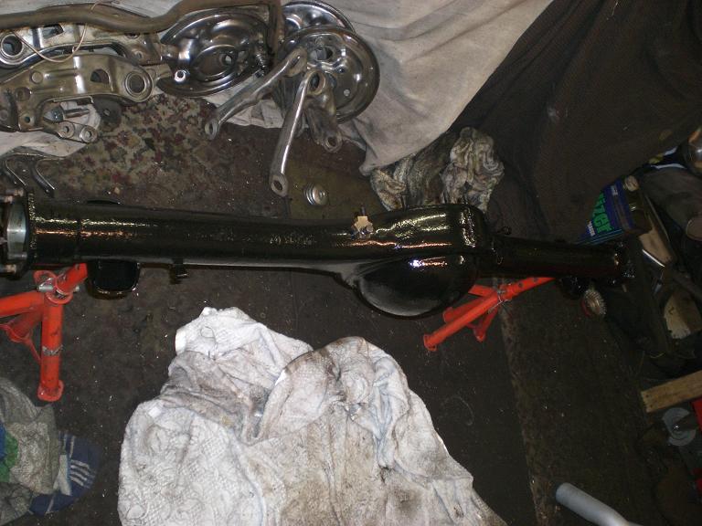

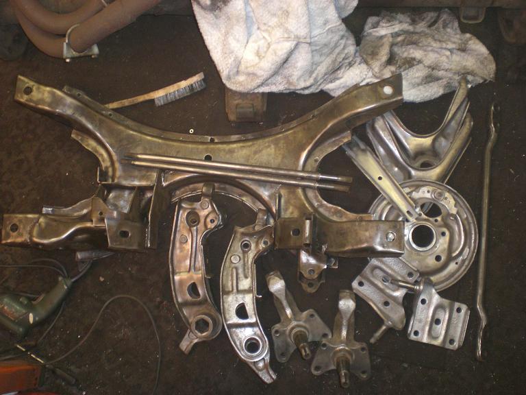

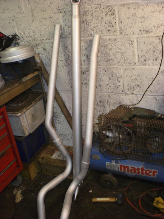

All the cleaning is finally done and the painting has started. There is also a picture of the new brake lines. Even with a sand blast cabinet it has taken ages to clean and de-rust all the parts. I have also rebuilt and painted the master cylinder and rebuilt all the brake cylinders and painted them. I will put all new seals in the rear axle before i reassemble it. All the other parts will be dropped to the powder coaters on Monday and I should have them back a week later and them i can start to put it all back together.

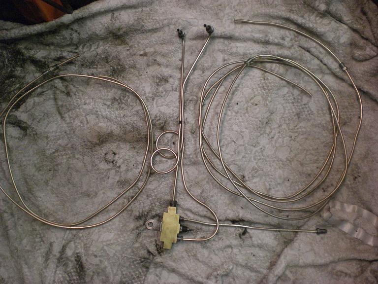

New copper nickle brake lines
Rear axle
Rear axle
Drive shaft and exhaust

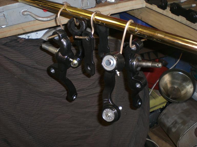

Suspension components

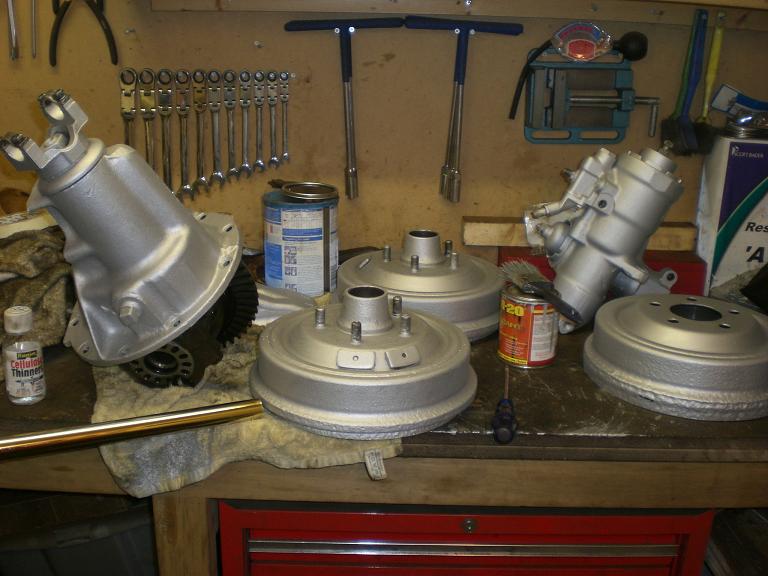

pumpkin and drums
pumpkin and drums

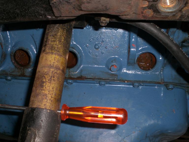

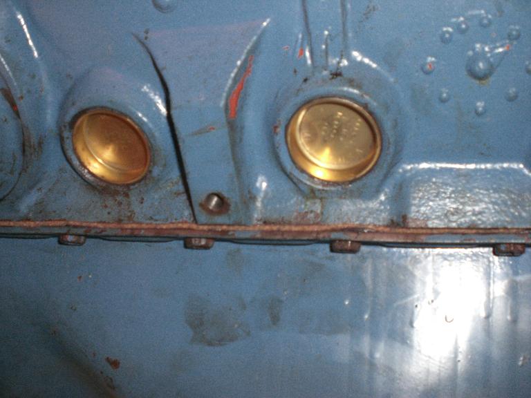

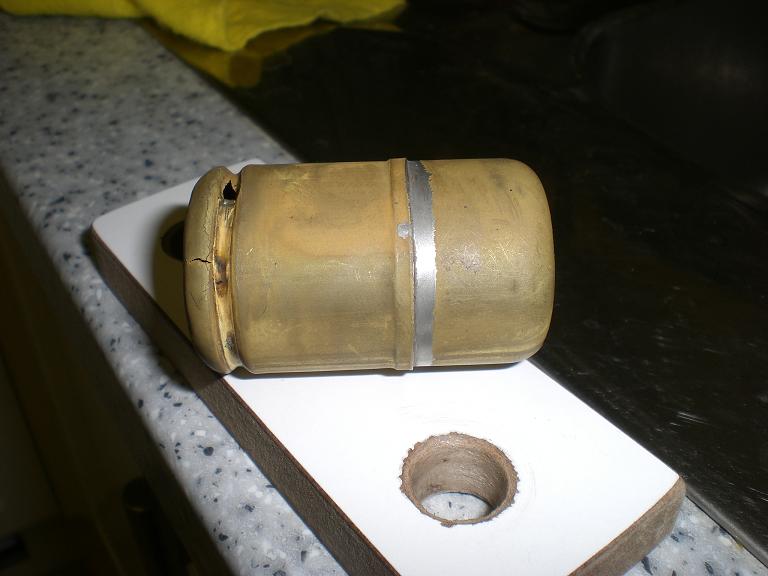

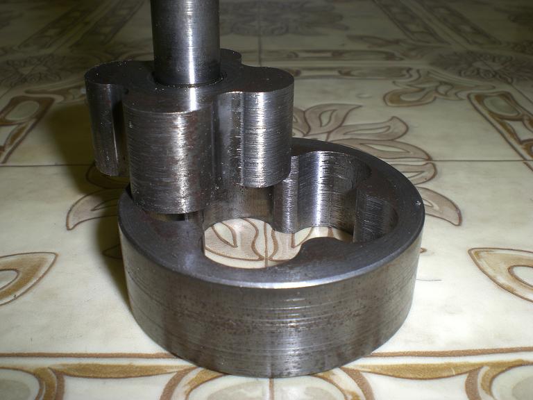

Been working on the car all day and got a load of jobs done.Replaced all core plugs in the motor. Fitted all the new brake lines back onto the car. Put the new oil pump and pick up tube in and knocked the dent in the sump out. Removed the fuel sender to find out why my fuel gage wasn't working and discovered a hole in the float. The old oil pump was Knackered as you can see in the photo.
A very damaged oil pump

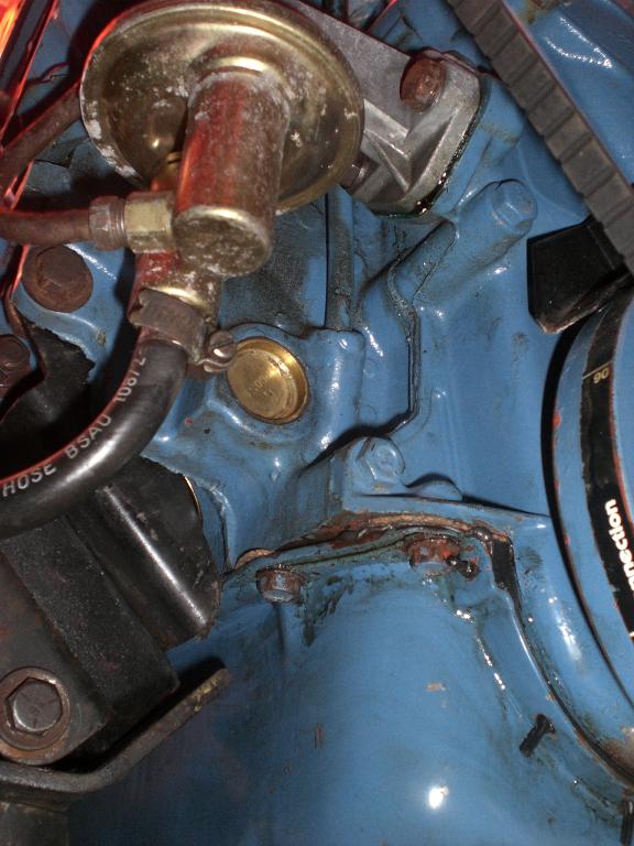

Front core plug
Front core plug
New brass plugs installed
A few holes in the old core plugs
Out plug taken out
Out plug taken out

Post by ANTON »
hole in fuel float
