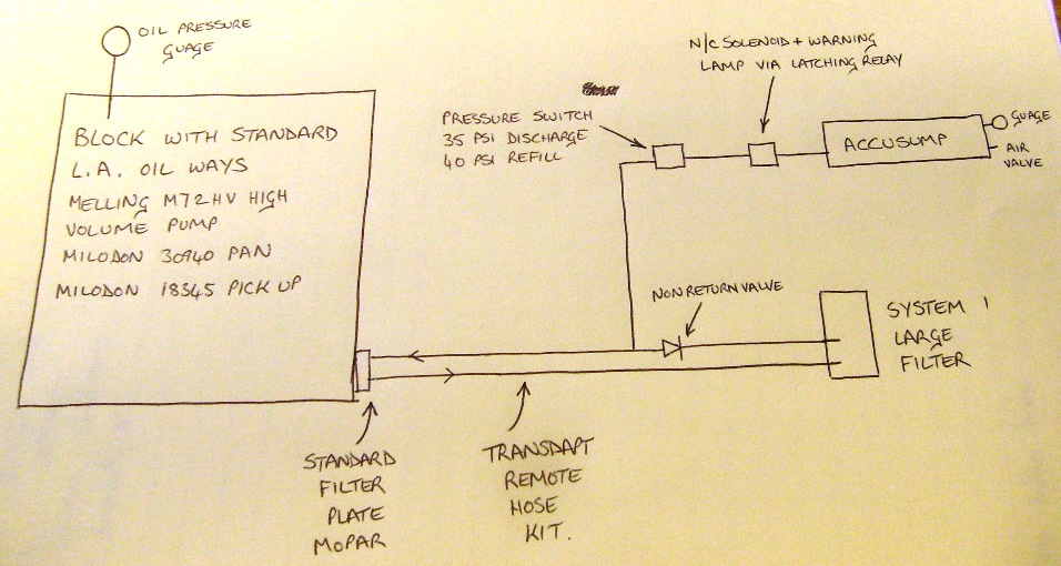

Canton & Aqua sump are both good, solenoid operated is the best way to go in my opinion, once less thing to worry about turning on at the track. You can always fit an inline pressure warning gauge if your uncomfortable about trusting solenoid to work, or wire solenoid on the N/O circuit to a warning device.

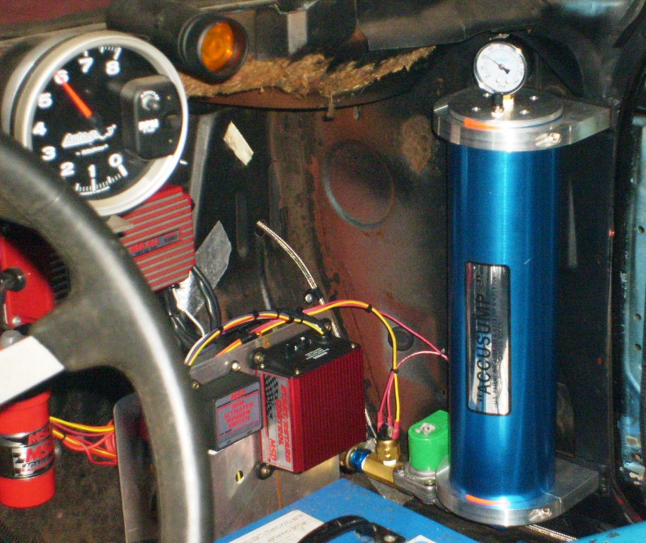

This is what I`m fitting, I have all the bits but is alot heavier than I thought.
This set up provides automatic pre oiling and surge control and gives me approx 30 secs worth of spare oil capacity should the worst happen. ( Hopefully enough time to save my motor )
Jon Connolly
Posts: 3116
Post by Jon Connolly »
I would recommend these to anyone
It is very reassuring looking over and seeing you have a reserve of oil ready.
The pre lubing is great too, takes 5 seconds only, then the motor is ready to go
The other thing is it is a nice bit of ballast that you can mount anywhere in the car

jon you posh git with your solinod operated sump, ive only every used manual
AS brutus says total pain not having dipstick on my B1, always paranoid about how much oil's in her, even my circuit race cars have either dipsticks or oil level gauge, it ok say yeh just put think much oil in, but makes no allowences for oil cooler size/cooler line lenght etc

Next time your missus says she never knows what to buy you for Christmas you can tell her to get you a " Canton Racing ecs valve for an Accusump reservoir " :lol:
I don`t use a dipstick now either, but do check the oil level after each couple of runs ... also visual check for oil leaks around each fitting.
