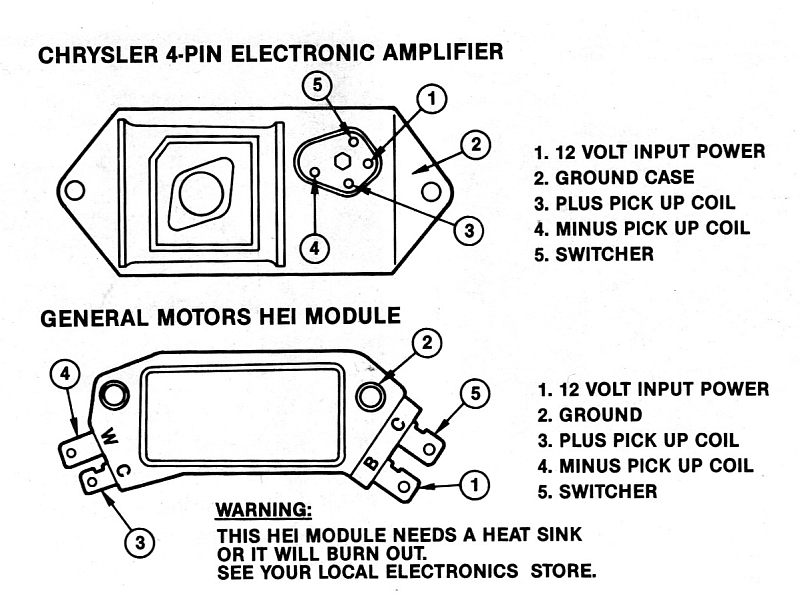

these modules in the DUI and in the HEI 4 pin are designed to survive the rigorous of switching currents in the 3-7 amp range
the coils you use with these modules have a primary resistance that allows a 3-7 amp current to flow when exposed to a voltage of 12 volts across the primary
