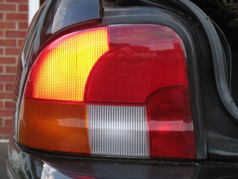

This is a WHITE LED replacement bulb with LEDs pointing to the sides and even behind so that they have a more even light distribution. Fitted in a Neon that we used to own years ago.
This is a RED LED light the same as above. Red taillight LEDS show brighter through a red lens as less light is filtered out.
This is a NORMAL bulb. You decide which looks more even on the brightness.

Good comparison Dave i agree normal incandesant bulbs are brighter and Omni light emmitting.
Led are much brighter face on and less amperage draw and a lot less heat
But having said that i bought some 1 watt LEDs for the interior down lights in the footwell on the truck....JESUS :shock: :shock: amazingly bright
