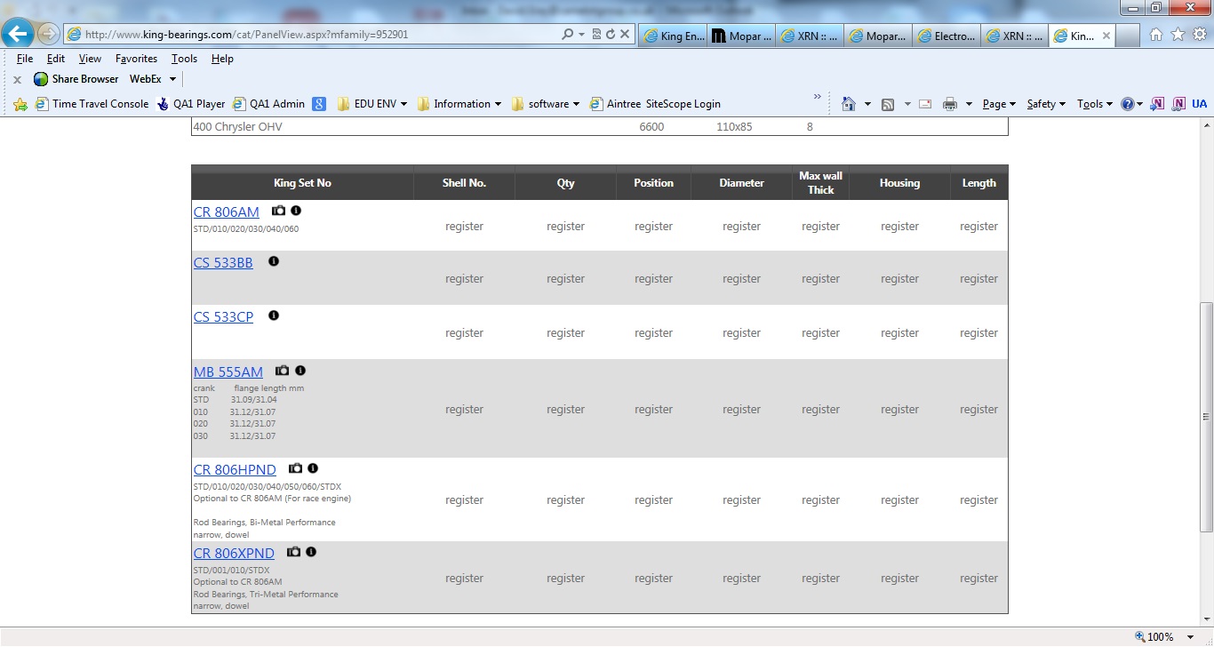

MB Main bearings
CR conrod
dunno what CS is i'd need to register to see photos but there will be cam
in the mix as well
need to ID the year of your engine i think
i have no idea if the small flange or the big flange is correct
but king seem to differnentiate
look for chrysler 1960 383 for the RB engine
and Chrylser 1962 383 for the B engine

Dave999 wrote:MB Main bearings
CR conrod
in the mix as well
Engine year is most likely 1959 as the car was first registered in UK Feb '60. I have no idea how long it took the French to build 'em though, so it may even be a 1958 build engine. Unfortunately the block ID stampings are illegible. The engine number on the RHS cylinder head (looking under the bonnet (hood :D )) is TY7 31203 which is supposed to be it's original.
I've been using Chrysler 1959/60 model Saratoga to ID the engine components as this and the Windsor seem to have been the only models using the 383 motor.
On the centre main bearing thrust flange, I had the Engineers check this, this morning, and the rebate in the block/cap is about 3.7" which leaves space for the larger flange, so that is what I will go for.
PS. I think I now have a good handle on these bearing numbers having looked at the catalogue for some time :read2:
Thanks for the help David. Cheers
