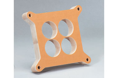

Have you tried a thick spacer between the carb and manifold?? You may find that heat transfer to the carb is percolating the fuel when it gets hot. Usually will start but can take an age while new fuel is pumped through. Quite common.....just a thought and maybe worth a try??

This one is wooden but think you can get fibre material etc . Just need to get one matched for your intake and carb setup :thumbright:
