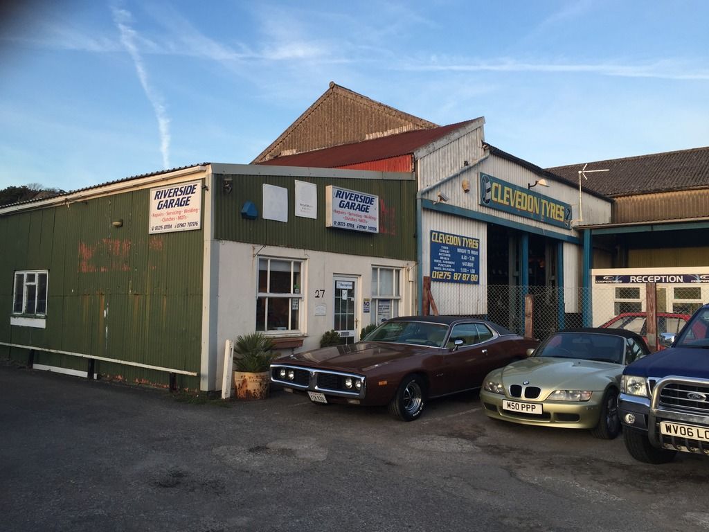

Charger's in the garage today having its vitals checked. Theres an annoying exhaust rattle that is going to be sorted out too.

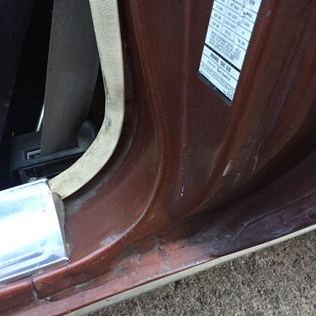

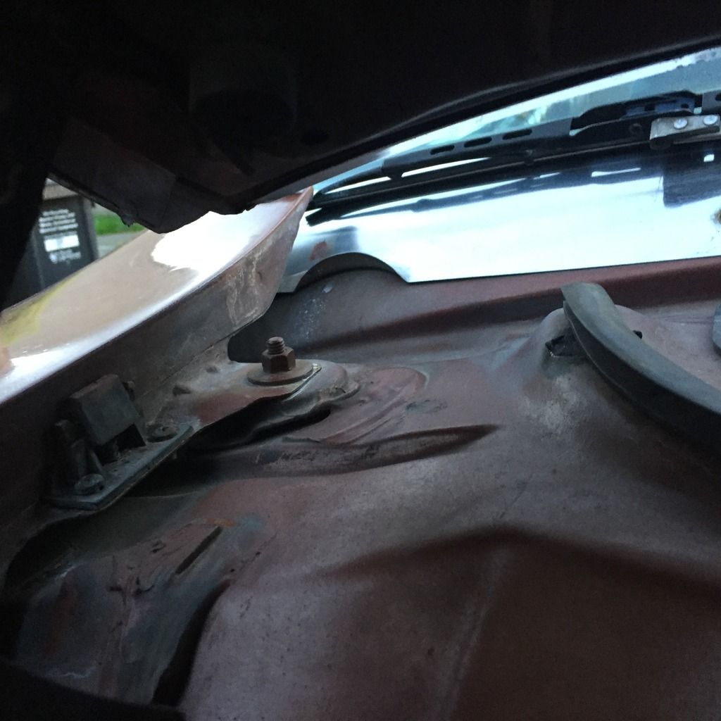

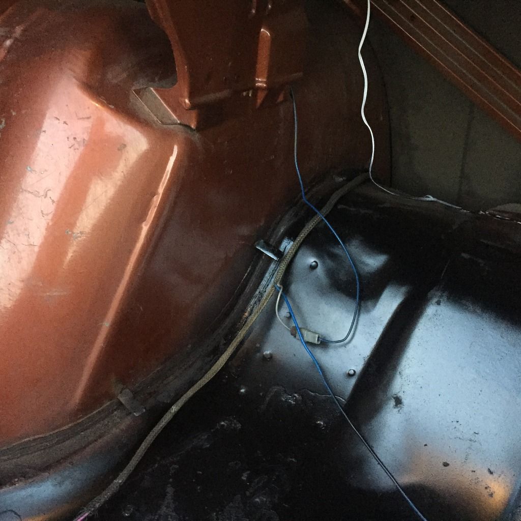

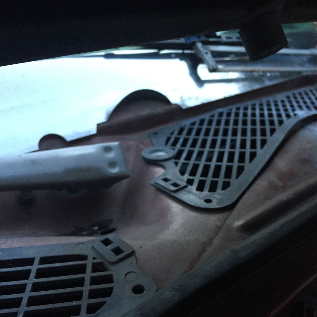

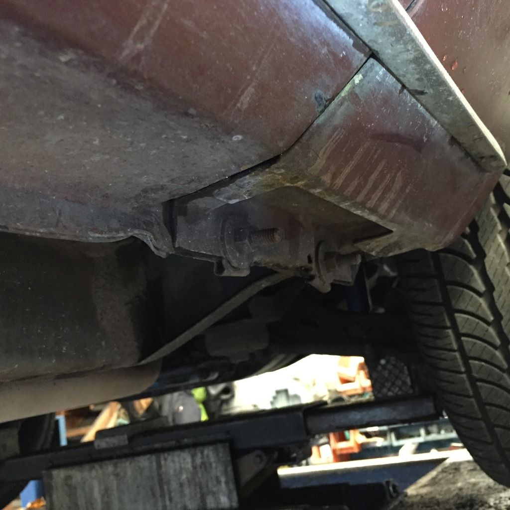

Some shots of various parts of the car, so you can see the condition. Its all grubby and unloved at the moment, but it will gleam again soon.
In the trunk, i have sprayed the black on floor there temporarily, as i'd wire brushed years of crap and gunk from it.

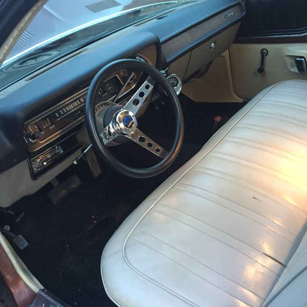

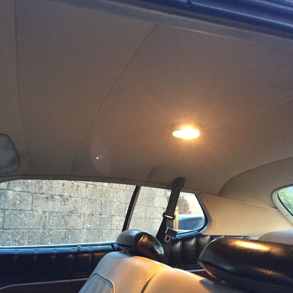

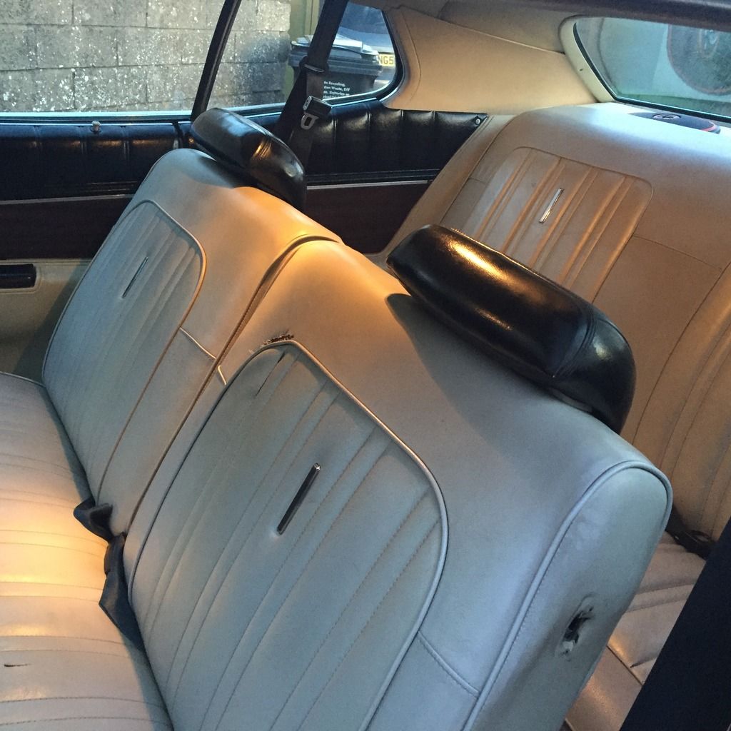

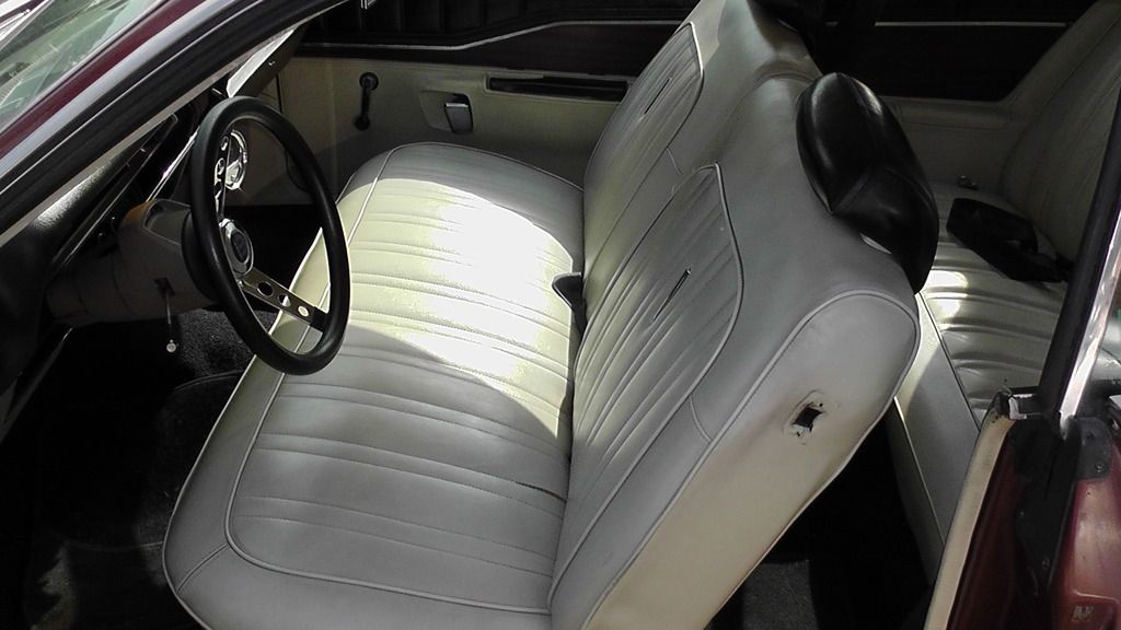

Some shots of the interior as it is at the moment.
Not sure what has been sprayed on the headrests to give them that gloss black shine, but i don't like it. Any suggestions?
It has an aftermarket steering wheel fitted, but i have the original. Should i put the original one back on?
The big chrome rev counter looks a bit naff, so i may well remove that.
Posts: 22216
That is a period style Tach - I specifically got one to go in the Bee! ;)
Personal taste though.
Looks a very solid car and Blue is absolutely right about timing.
Shoot for 34 Degress on full mechanical advance and then see what you have at idle. If the car pinks or is hard to start then back it off.
After-market Dizzys that you can custom re-curve are the way to go nowadays but sometimes you can strike it lucky with a stock one, it is just hit and miss really..
Posts: 14598
I'd take out the tach, that's an early 60's style and looks about as right as a flathead in a Camaro.....

Blue wrote:I'd take out the tach, that's an early 60's style and looks about as right as a flathead in a Camaro.....
Blues right... great to have a tach but it has to be younger than the car it's in not older. I just swapped out an older style one for an original 70's Sun tach.
The Superior 500 steering wheel is great... It is probably about 2" smaller in diameter and thicker, grippier than the original and will give you more 'feel' when driving... I'd just change the horn button to something plain.
The car looks really clean :thumbright:
