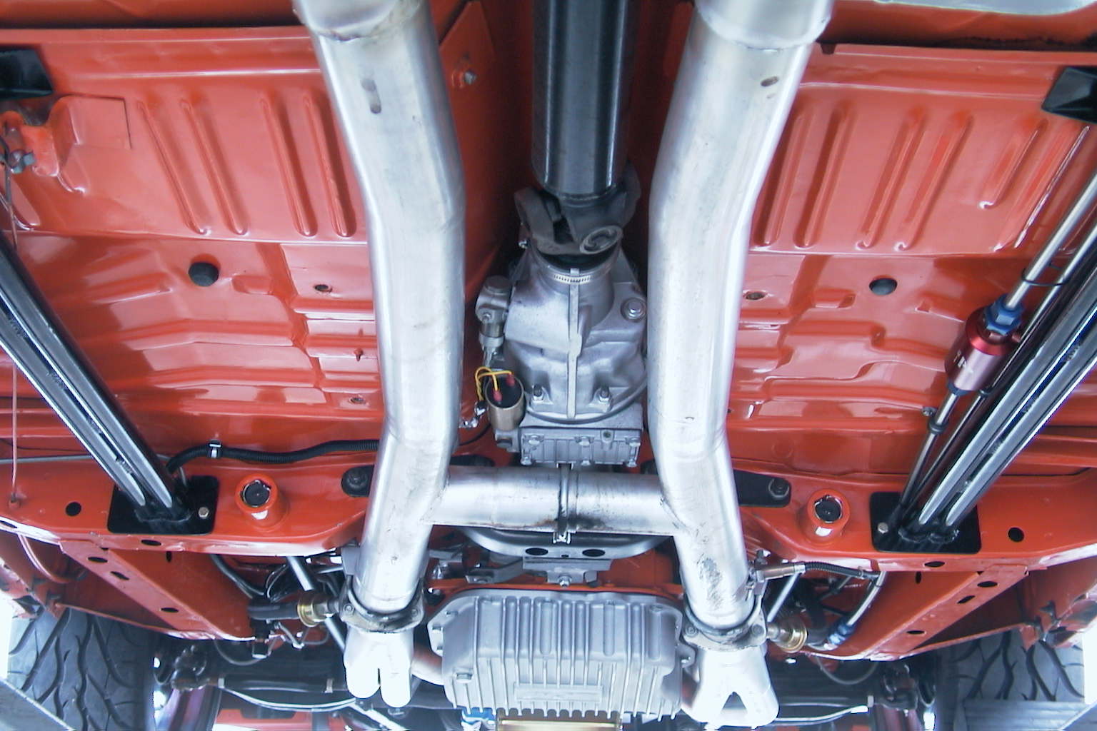

Is the gear vendors option 100% reversible or are there permanent modifications needed too?
Posts: 14446
Yes it is, you remove the original transmission tail shaft and bolt it on. It does require a shorter propshaft so just get a new one made and you still all your original parts to refit, no permanent mods are needed.

I actually just called the company in California and Rick Johnson was so helpful and knowledgeable. Amazing customer service.
kwsUnderside Dodge Charger 727 torqueflite.jpg (172.19 KiB) Viewed 1452 times
