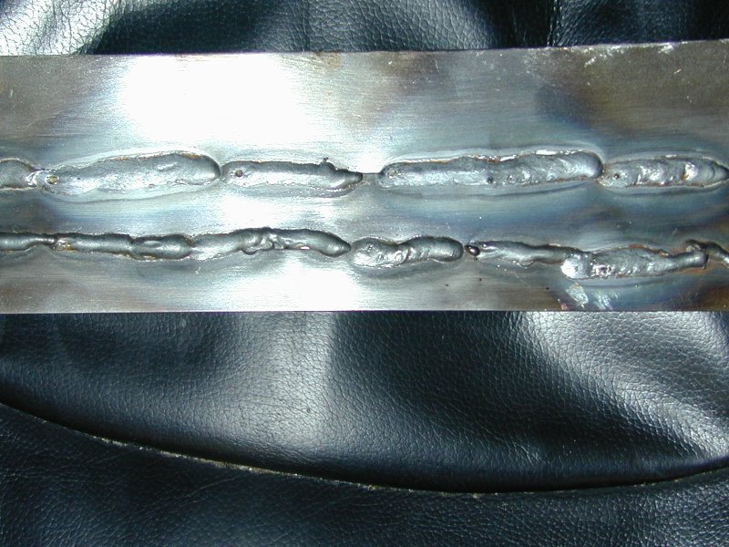

Anyway, with that done back to the car. I haven't used the MIG for probably 20 years, so I've had a bit of a play about on a practise piece and after a stringy start, got some moderately OK welds that look the same from both sides.

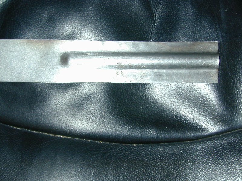

I've also tested a simple tool I made up to press in some ribs where needed and that seems to work OK (with a bit of dolly work afterwards).

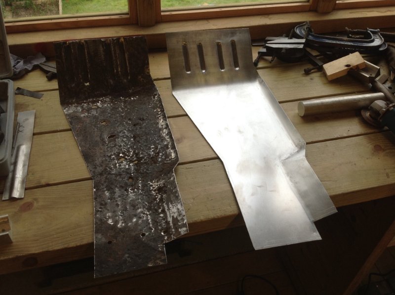

So, now to take some patterns from the floor and make up some patches....

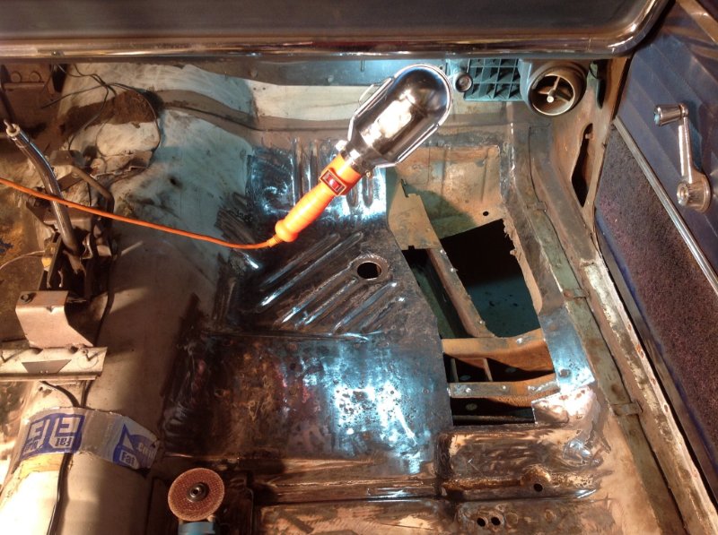

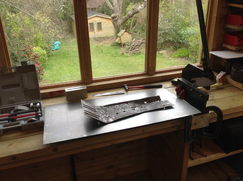

So, that's the bad bit out
Floor 7.jpg (115.85 KiB) Viewed 3792 times

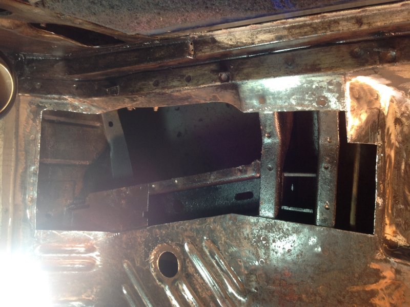

Best make a new bit...
Floor 9.jpg (104.67 KiB) Viewed 3792 times

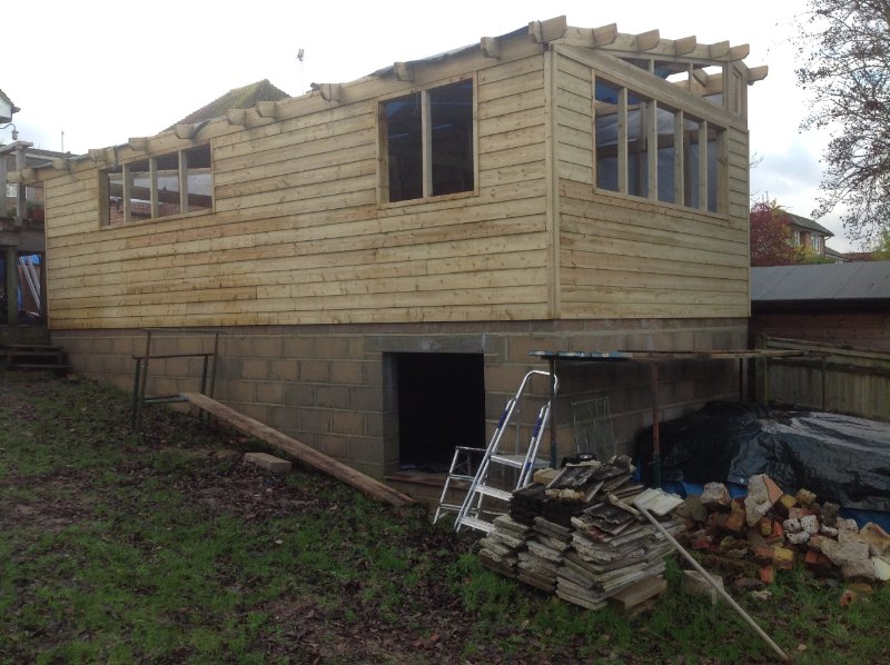

That is the extended version ! Thanks to the slope we're on it's already nearly a storey above ground at the back...

That’s lovely. Room underneath for stuff tooπŸ‘

Got a wire brush and some rust converter as far up the exposed sections as I could, I'll hit it with some weld-through primer before zipping it up.
Floor 12.jpg (103.49 KiB) Viewed 3756 times

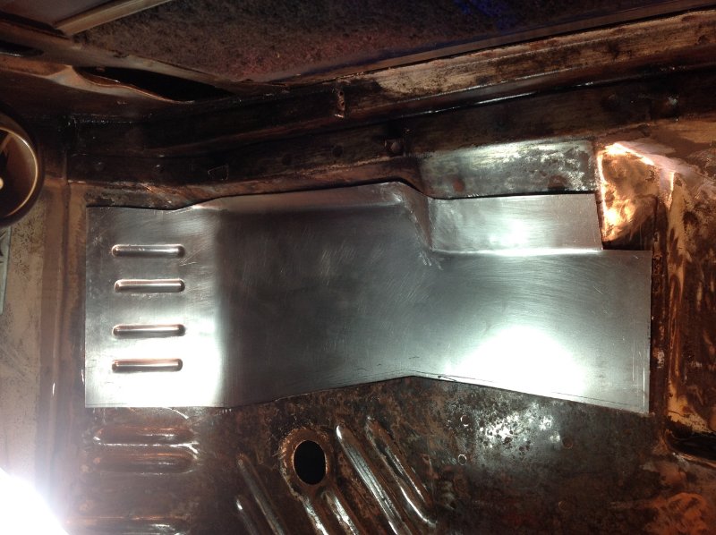

Got pretty close with the new patch...
Floor 15.jpg (74.79 KiB) Viewed 3756 times
It'll just need a final trim to fit.
Floor 13.jpg (96.69 KiB) Viewed 3756 times

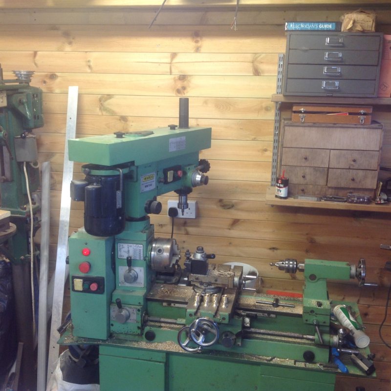

Underneath is a good store, but not quite high enough to stand up properly. 'Machine shop' is upstairs though...
