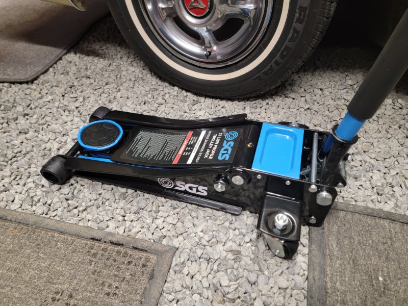

Ive just bought this jack as this thread and my dodgy current jack prompted me to. Fantastic value, appears to be really good quality for the money and came less than 24hrs after I ordered it.

It does Stu, so far Im really impressed for the money. My old one was a nightmare to lower. As soon as I turned the handle it would just drop like a stone. It also very slowly dropped when the car was up so I had to be quick getting the stands under it. This one is very smooth and precise. Ive obviously only had it a couple of days but so far so good. It is very heavy so more of a garage jack than one you can just take in and out of the car :thumbright:

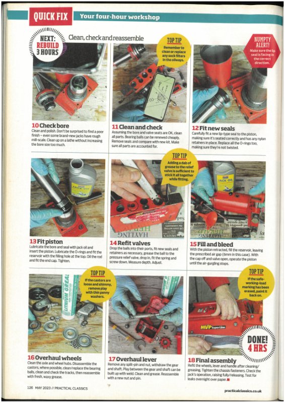

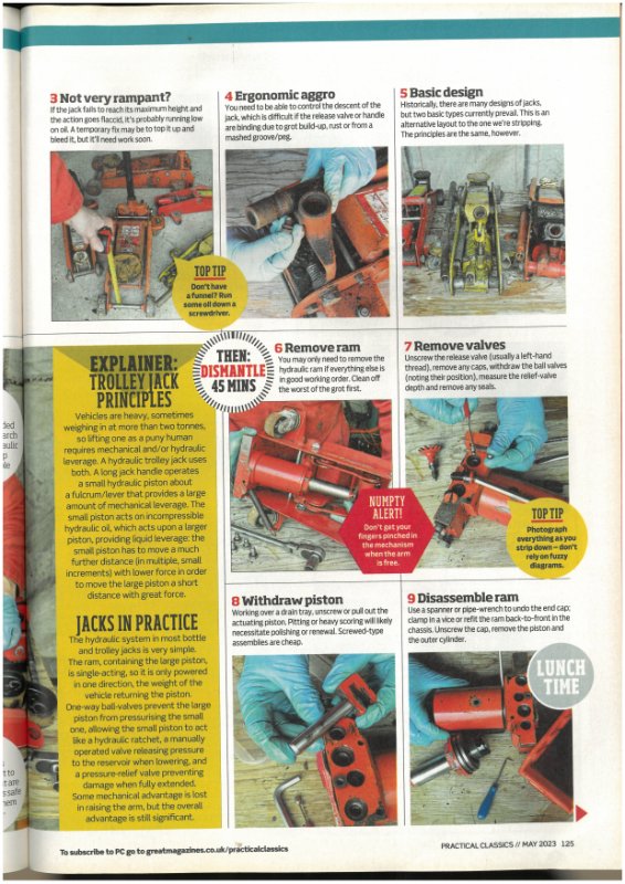

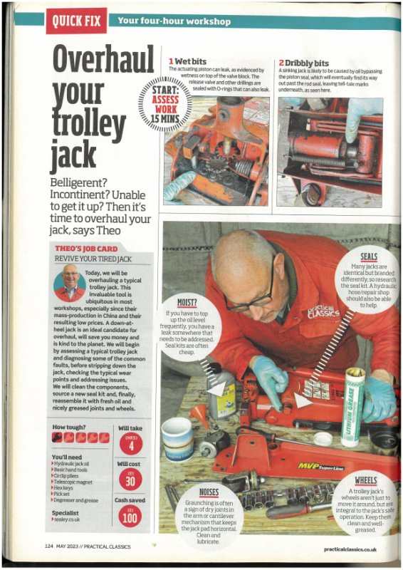

I doubt anyone's about to rebuild their jack, after what's previoussly been posted but... I just found this in an oldish (2023) Practical Classics that was heading for the recycling... :read2:
trolley jack 1.jpg (115.38 KiB) Viewed 18421 times
trolley jack 2.jpg (123.37 KiB) Viewed 18421 times
trolley jack 3.jpg (122.3 KiB) Viewed 18421 times

Dunno why those scans are so fuzzy - they look fine on the original jpeg :-k :roll:
