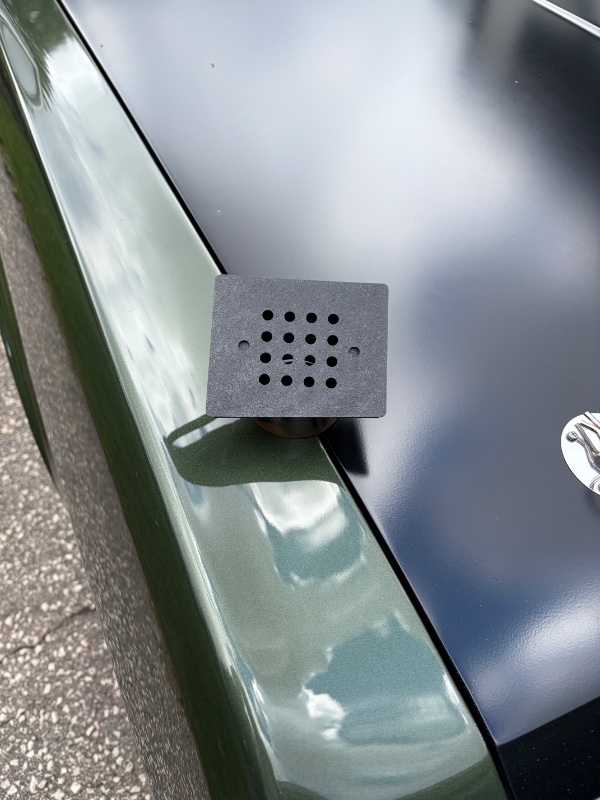

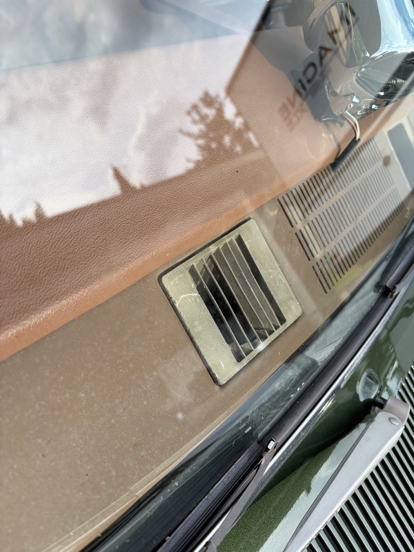

What a nightmare these things are, dash panel out, glovebox insert out, just to get to the securing nuts!
As you can see, the vents have taken a hammering, they are so brittle and so discoloured. I guess that’s what happens to original ones that have been in there since 1969.
Replacements are available but before I buy those I’m gonna try and 3-D print a couple see how that goes.
I can get NOS ones for $150, or repro ones for .$80. Only come in black. Let’s see what I can make.

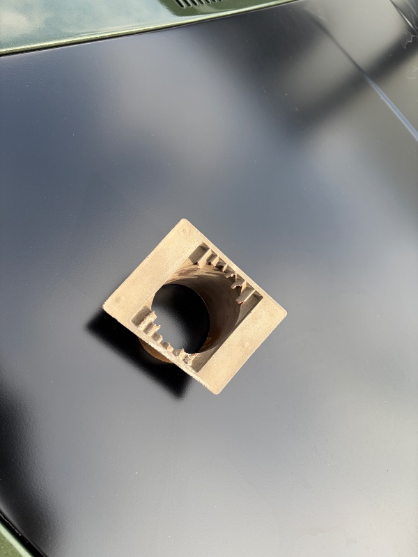

1st iteration, next version printing now. Think this will work just fine. Have to paint them of course.

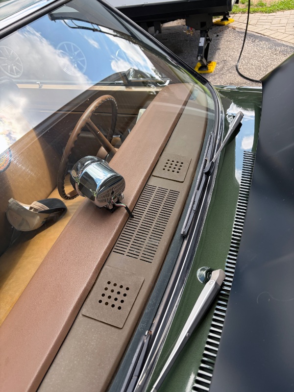

Well, it ain't stock... But neither is the rest of the car...... That's the defrost sorted. Next while the dash is out, a new speedo cable.

Still needed to do something with the vents. 50 cent fix!

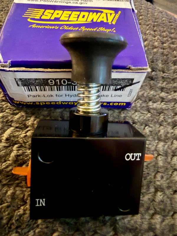

Speedo all in and working. Next, and last job to get done for the Ontario safety inspection (apart from windshield washers) is the parking brake.
All those parts on the 8.8” Ford rear, have been deleted or modified.
So decided to go the hydraulic route. Easier and cheaper.
This arrived today, and should do the job. Tomorrow, I will start designing a mount for it.

Not seen that style before, I assume the knob pushes down and stay locked?
Jeff
Posts: 8026
Location: Ontario.
Re: Jeff’s ‘69 Valiant
Post by Jeff »
Yes blue, push brake peddle, then the park-Lok button.
Release brake peddle, rear wheels are locked.
To release, just step on brake peddle, and it releases
Automatically.

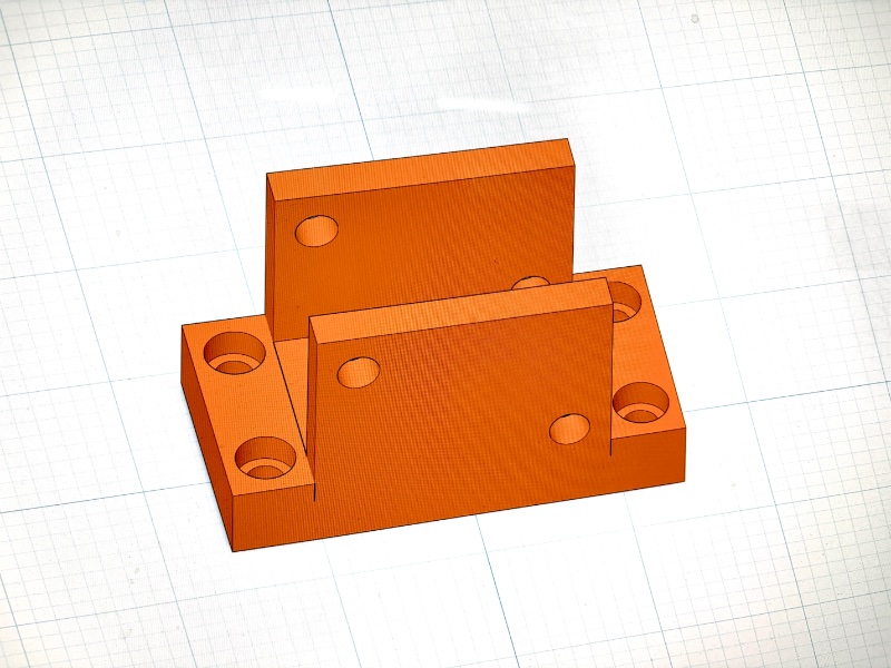

Just made this mount up in a CAD program. To mount the parking brake knob onto floor.
Made so many parts for the nomad in the past, now time for the Valiant.

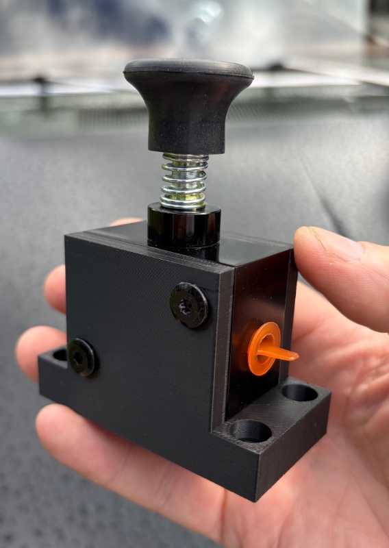

Finished mount with Park-Lok installed. Designed and printed in less than 2 hrs.
These 3D printers make basic fab work so bloody easy. Perfect fit, and less than a $1 in material.

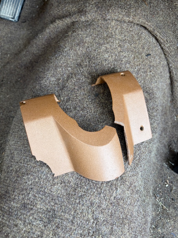

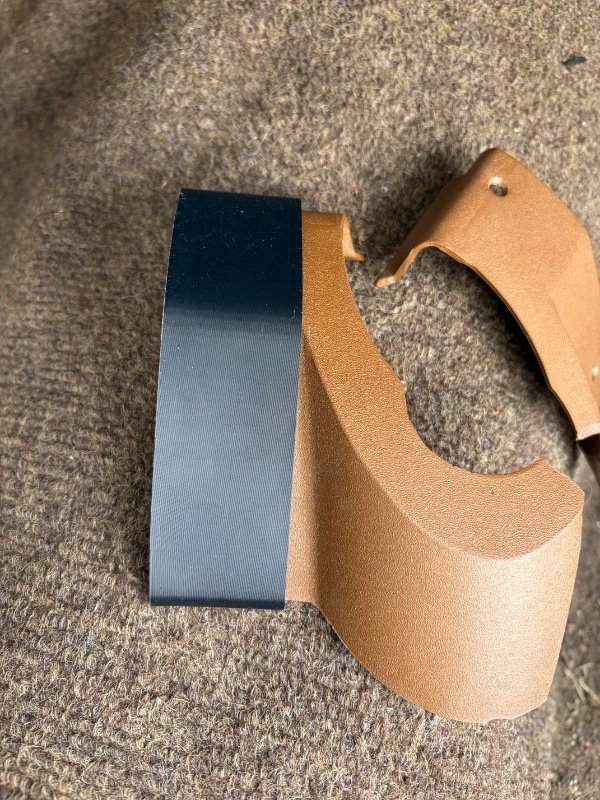

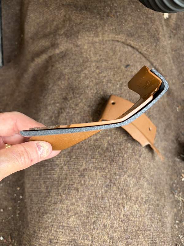

The under dash column trim is not as easy as gluing it back together.
So I scanned the profile, and printed two side parts, that will be glued on the front of the panel. Again, it’s not stock, but I can’t spend $200 on a repro one.
The curved bottom break, I will do the same, but affix to the rear.
Once painted, I think it will look OK.
