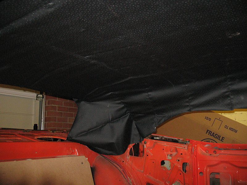

Thanks lads.
I will see if I can get the headliner in next without cocking anything else up. :lol:
Posts: 13003
A word to the wise mate, when fitting that headliner.
About twenty three helpers would be useful! :D
I'm lettin' Dave Madders do mine ;) :D
Ivor wrote:A word to the wise mate, when fitting that headliner.
Nah! Look at that. Perfect! :lol:
OK so it needs a little tweaking...... :roll:
Actually. I started putting it in and then realised I need to screw the trim down that goes around the bottom of the vinyl top first. A couple of the studs are accessed from the sail panel.
Pity the two end holes have been filled in by someone doing the bodywork. Hope I don't drill the holes out in the wrong place. :help:

Mate I don't have a clue what I am doing. :lol:
I only just got the steel trim fitted around the bottom of the vinyl top properly tonight. The bit across the back under the rear window? I had it on for the photos but it was not bolted down yet.
The two bolt holes nearest the quarter side glass have been filled in for some reason. So I have had to drill new holes. I was also short of two fasteners as when I ordered them I counted the holes I could see. So I have been grinding and welding two bolts to fit in the trim at the ends in such a way that they wouldn't turn when I was on the inside of the car putting the nuts on.
I only just finished 20 mins ago.
So now I can see about getting the headliner to fit nice and tight. But not tonight...
