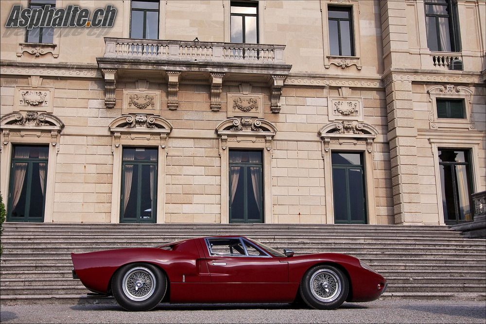

i did a lot of testing when the MK3 GT40 i rebuilt a few years ago broke down. i had four spare pumps to play with and upon stripping them down the rubber valves had swollen up by about 20% in the one off the car.
the owner did some research and although we wanted to keep the original type of pump for originality we ended up with an Edlebrock for reliability. has been good as gold since.

said GT40

Very nice car.

the GT40 did less than 100 miles when it broke down on a new pump. (it only has 7000 miles since it was built in 1969)
