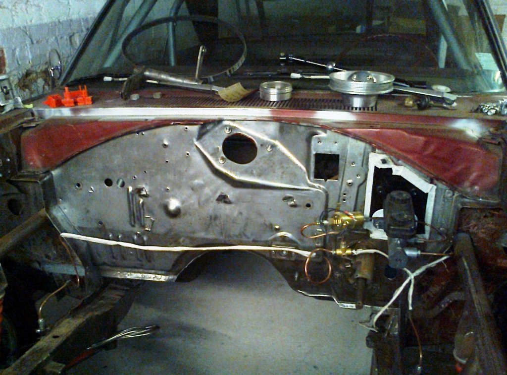

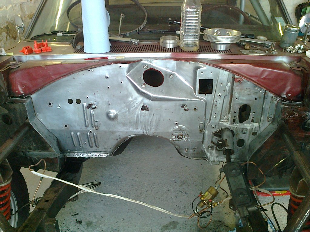

I've only gone and bare-metalled me bulkhead :roll:
It'll get the DE-OX and POR15 treatment tomorrow.
I'm gonna paint it body-colour, it doesn't have to be a great finish, so i'll use an aerosol.
Main thing i'm after is rust protection so... should i first hit it with Zinc primer, Gravitex stone-chip or something else?
looks great I'm painting mine the Ivor way check out his website for info.
What did you use to get it to bare metal does not look like a grinder job :? :thumbright: :thumbright: :thumbright:
Wire cup brush in a grinder for the accessible bits, various smaller wire brushes in a drill for the more fiddly bits, then Nitromors to finish. Hard going but effective :thumbright:

I did mine the other year when i took the inner wings out, i did as you have, then etch primed it, normal primer over the top and body colour then lacquer to finish, all out of cans.

Looking good I did that to mine last year and I am well chuffed how it turned out. Derek sprayed it for me with rattle can and it came out perfect.
Do your self a favour undo the four bolts the hold the master cylinder on and lean it forward and you will get a great job without having to mask it all up.

Anton- ta for the tip i'll do that. It been a right pain trying to work round it, i wish i'd thought of it sooner :roll:

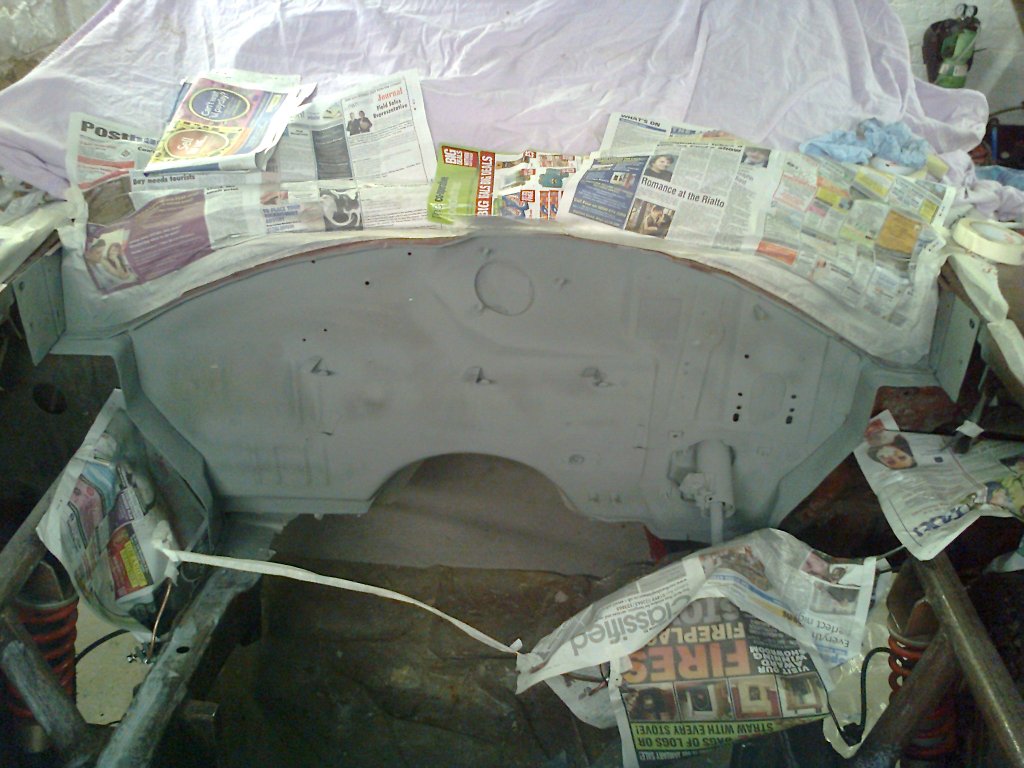

I've had rubbish results with POR 15 and I've followed the instructions to the letter... on a nice clean bulkhead like that it deffo wouldn't be my first choice! I think Mick's idea of etch priming would work best :thumbright:
Posts: 13003
Yep, another vote for etch primer here, you can get that in rattle cans and as long as you buy good quality stuff, it'll be fine, just one or one and a half coats, let it flash off for half an hour (air dry) then straight on with a primer.
Let the primer dry completely then give it a nice smooth rub over with a grey Scotcbrite (lessens you chances of rubbing through on the lumps and bumps in the bulkhead) just to key it for topcoating and that should be fine for an engine bay.

I don't mean Por15 paint i mean 'Metal-Ready' rust preventative. Great stuff, easy to use too.
You need to shift the worst of the rust, them just use a hand pump sprayer. Don't let it dry, give it all another squirt evey 20 mins or so then after an hour or two rinse it & dry it.
It leaves an etch primed surface, ready for primer/ paint :thumbright:

Well with Antons encouragement i've done it properly now :roll:
Por15'd and zinc primered. Just have a fan heater warming it up ready for some colour today :thumbright:
Oh and i found some grey Scotchbrite Ivor!
Bulkhead Zinc primer on.jpg (140.94 KiB) Viewed 1066 times

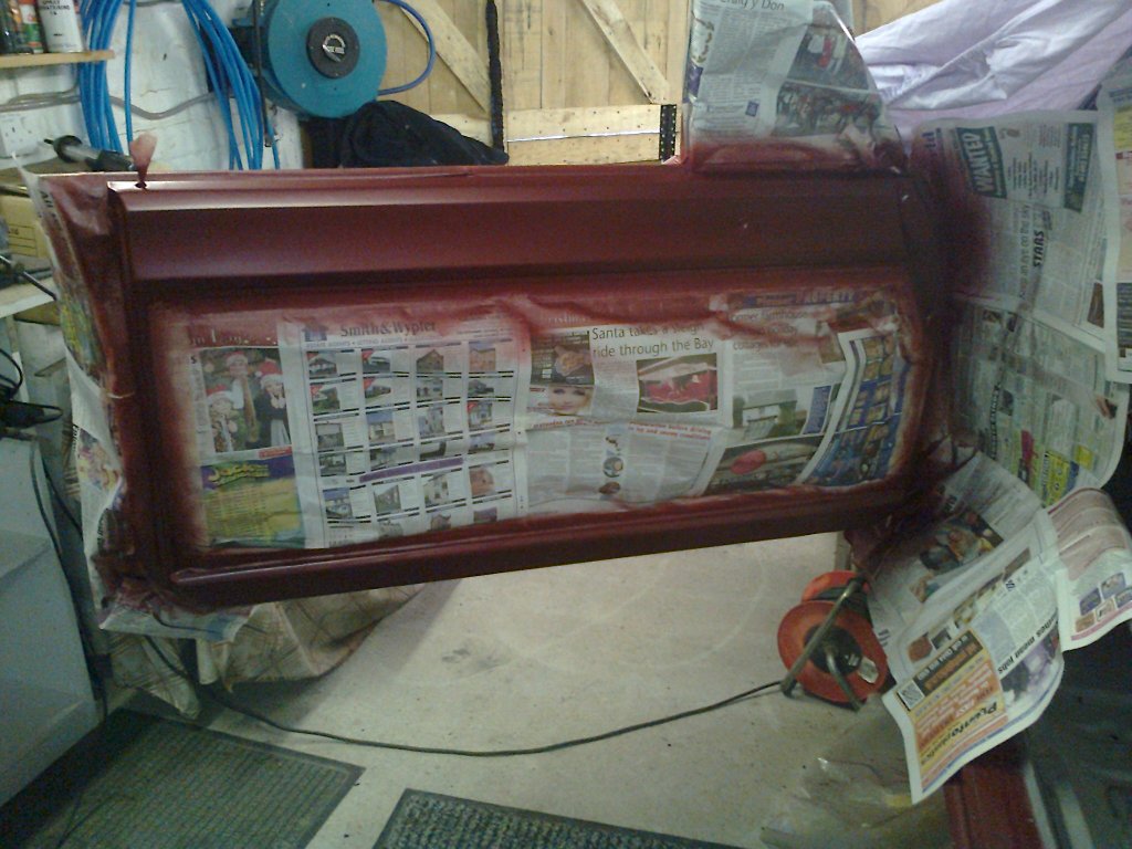

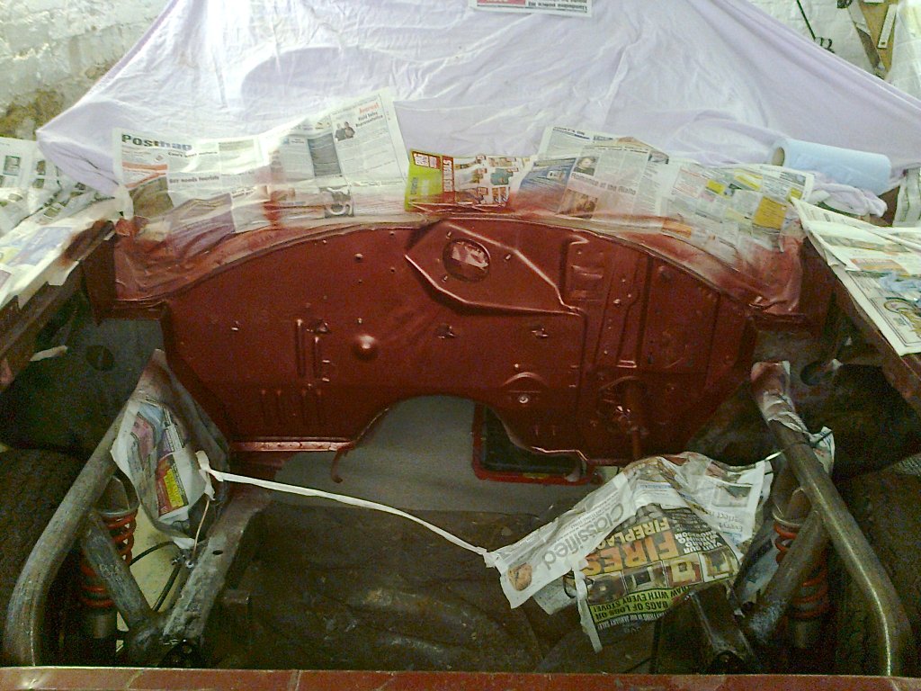

Coloured, did the inside of the door too inbetween coats...
Drivers door coloured.jpg (146.49 KiB) Viewed 1041 times
Bulkhead coloured.jpg (180.07 KiB) Viewed 1041 times
