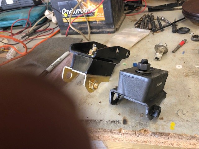

1) PolyLoc engine mounts arrived from Mancini. There's no discernible flex in them at all, which is just the job.
Fitted the mounts to the car without any issues. Whilst the engine is now very firmly mounted, which is what I was looking for, there's a significant amount of vibration transferred to the body. No huge problem for me, but you'd probably think twice before fitting these to a road car. I also lowered the rear part of the exhaust about 1/2" on its hangers to get more clearance with the floorpan. Another quick road test confirms that something is still hitting the floorpan though, so even more investigation needed.

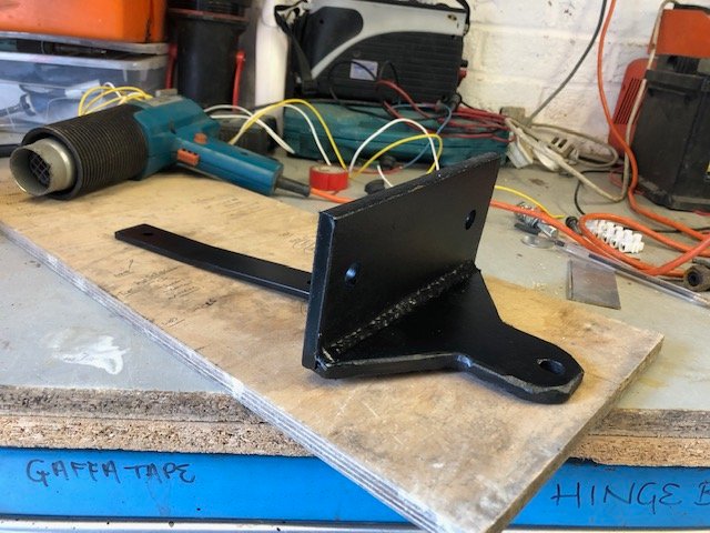

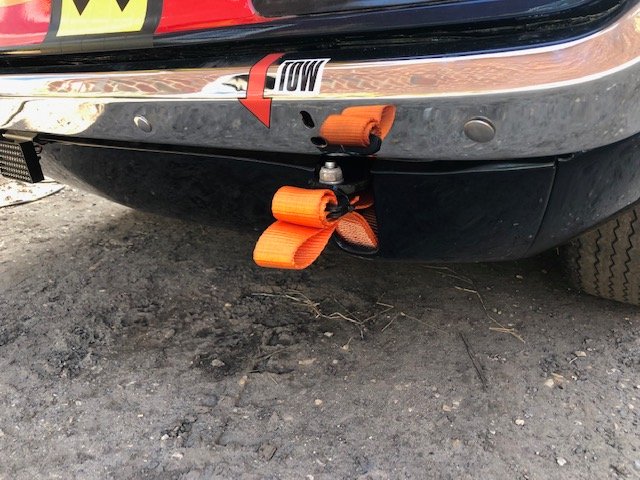

2) Rear bumper area . Need to fit a permanent towing eye/strap to comply with regs. There's nowhere that obvious to mount one, and any of the easier options (i.e.) behind bumper irons would probably result in body panel damage during a tow. Made a bracket out of heavy plate which will fit behind the bumper mount, and also extends along the frame rail using existing tapped holes to fasten.

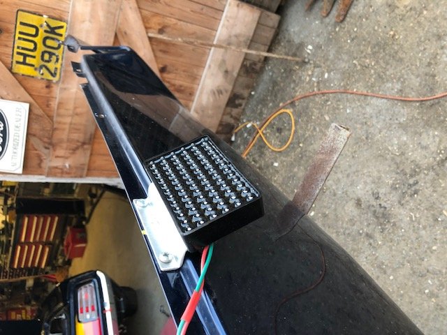

Also made a small bracket and fitted the rain light centrally on the rear valance while it was off
finished towing strap

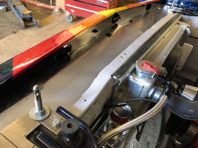

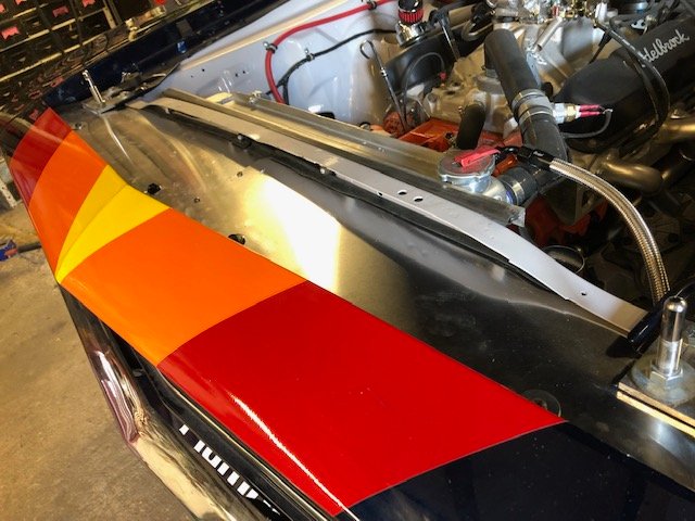

3) I'm still concerned about cooling , since the rad looks a little small. Panelled in the bonnet slam area using sheet ally , so that all the air coming through the grille is directed through the rad.

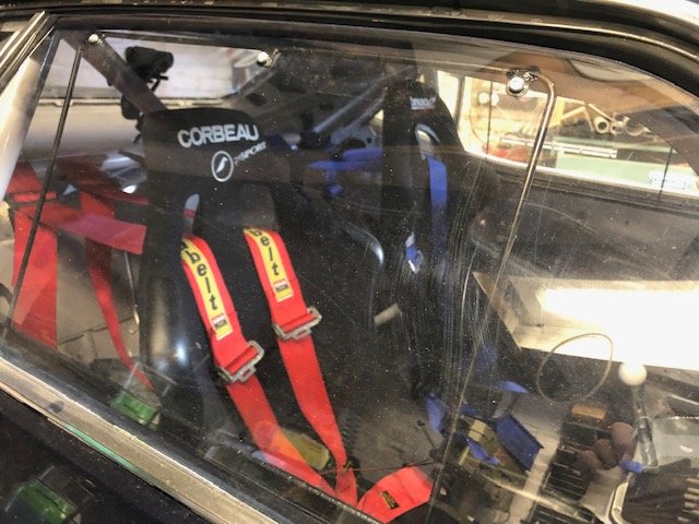

Passenger seat and belts installed.

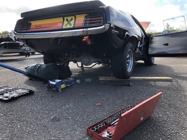

First issue - something is still *really* hammering on the floor under even mild acceleration. Come in after two laps and jack the car up to try and see what it is. Check all around the exhaust - nothing obvious to see. Maybe it's the gearbox hitting the tunnel - it *is* close after all. Much head scratching. Gary finally spots the bare patch in the paint.
Obviously, with hindsight, it was the diff yoke. The rear of the car has been lowered 2.5" (1" lower leaf springs and 1.5" lowering blocks) and it seems even this is enough to bring the yoke *really* close to the floorpan. Quick fix - remove the lowering blocks !
