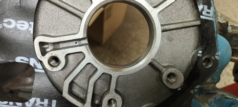

Oh dear , is that the result of a rad leak into the oil cooler.?

Johnny Dart wrote: Tue May 26, 26 1:23 pm Oh dear , is that the result of a rad leak into the oil cooler.?
that or the car was sat underwater, lol.

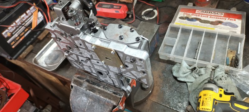

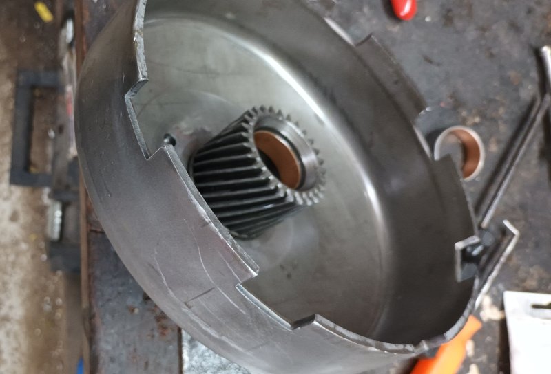

Got a bit more done , strip and inspect , check clearances, all good. Next the valve body , and the TF2 re program kit.

What is the advantages or disadvantages of the shift command feature , that you can have with the tf2 kit ?

Done the sprag oiling modification.

Johnny Dart wrote: Tue May 26, 26 5:50 pm What is the advantages or disadvantages of the shift command feature , that you can have with the tf2 kit ?
No real downside, just allows you to up and downshift at any RPM.

Ok , thanks , I'll go for that then.
I think Ill tackle the valve body tomorrow.

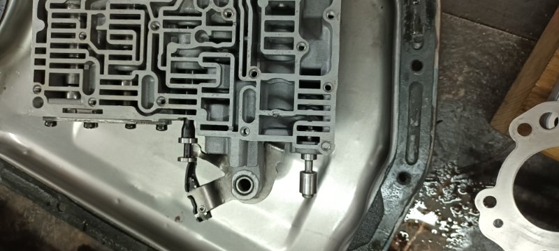

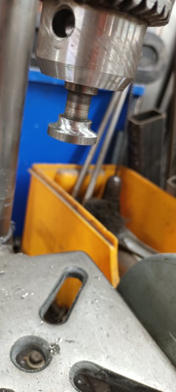

I got the valve body done today, fitted with the tf2 reprogramming kit.
I had to grind down a couple of valves , as per the kit instructions.

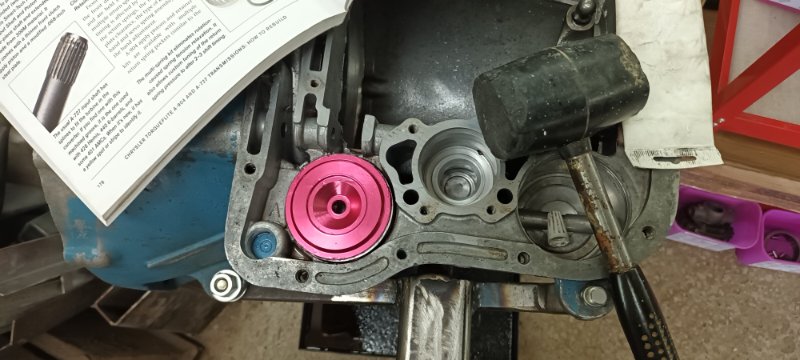

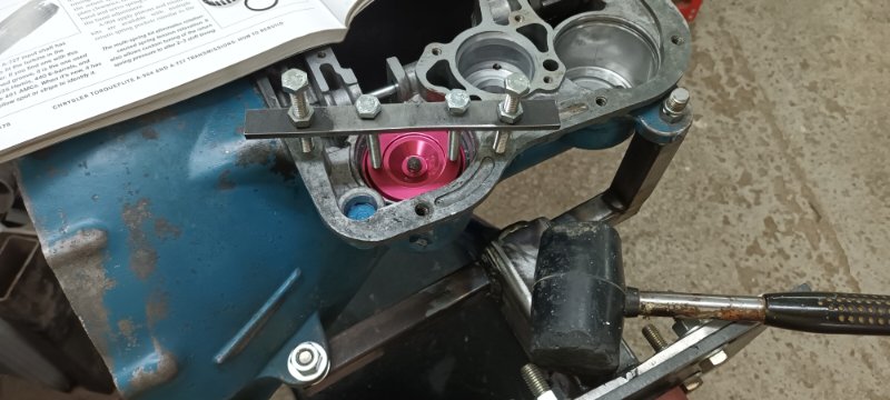

Tomorrow I've got to make up a tool to compress the front band servo.
Posts: 14598
Re: Johnny's Dart repairs
That wasn’t so bad was it? You can use a G clamp and a socket to compress the front servo, thats all I used for years, in fact my present tool is just an improved version of that.
Johnny Dart
Posts: 917
Post by Johnny Dart »
My g clamp wasn't big enough , so I knocked up a pusher out of some scrap, that worked.
Getting there now.😁

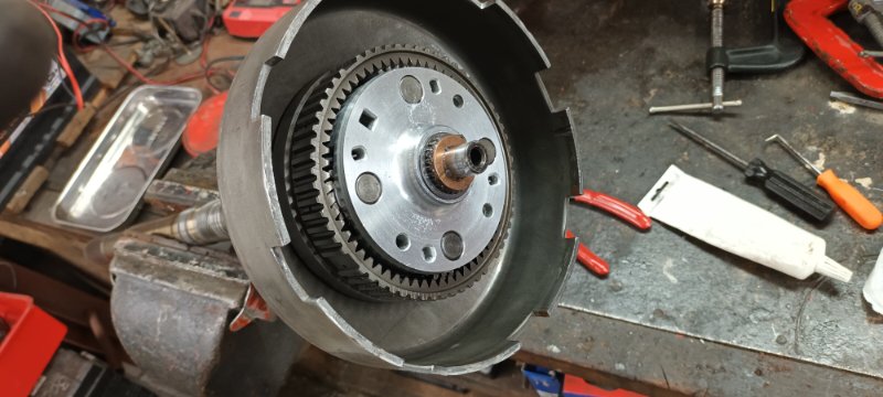

What's with this !
This came apart with this bush on top , and no springs on the accumulator, any ideas as to why this was done ?
