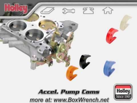

I've got a 29 and 35 shooters, 6.5 pv and numerous jets but 35 seems quite big for your car. Put your vac gauge on and tune it for max vac, what are the idle screws set at ? Also you could try different positions on the pump cams.
What do you mean by this mate?

Holley use various pump cams to alter the timing and duration of the pump shot through the accelerator jets. These quite often have two or sometimes three holes in a cam so the shot can be advance or retarded to help with tuning

I'm with Mick on the squirter. I recently went down to a 28 on my car and it seems to like it more than the 31 and 35 I tried. Take a look at the squirter, they are not like jets where a bigger size simply gives more flow. The squirters have different durations of flow and sometimes a smaller squirter will give a pro longed flow whereas a bigger squirter gives a shorter duration, bigger squirt.
