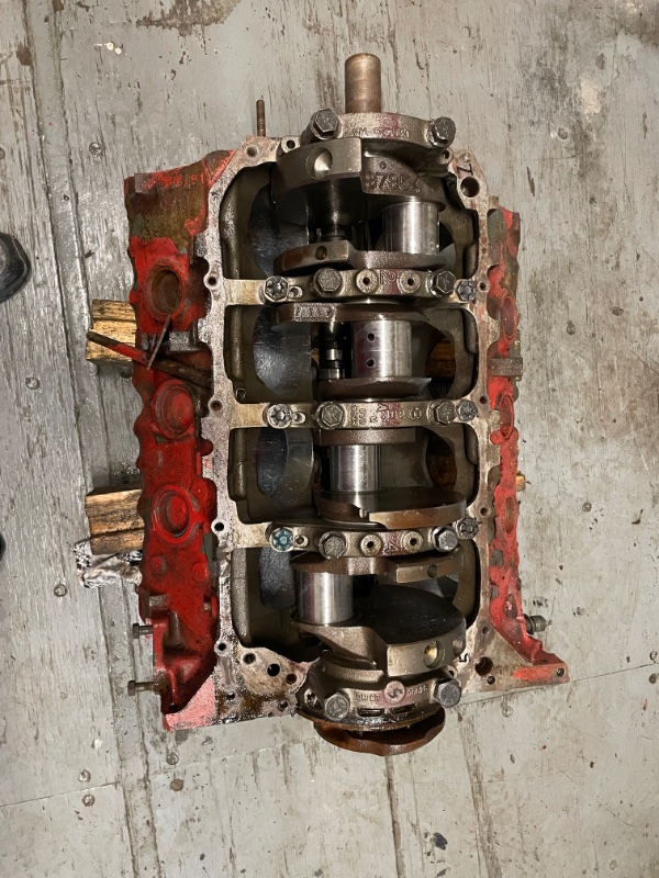

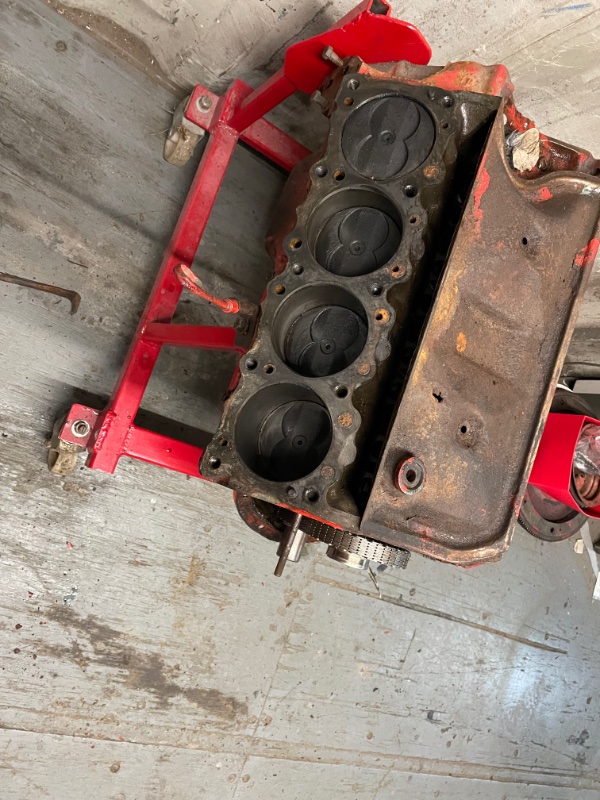

Re: My very last restoration!!!
Got the sump off yesterday, all looks ok so far and pleased to see 4 bolt mains etc.
my bores all measured up as standard with about 2 thou of wear ,
So I probably will get away with a hone and some new bearings and rings ??
Depending on how my cash flow is I may bite the bullet and beef it up some, a stroker crank and a bore should yield around 488 CI
But it’s a genuine unmolested WS RA engine so may just keep it stock ?
Time to think over the winter
i'd keep it stock, they didn't handle that well with the stock hp so..... at least get some miles under it and then if you want 'more' search out another engine to build up along with brake and suspension upgrades. just my thoughts, feel free to ignore me

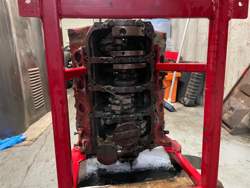

Well it’s definitely not unmolested!
Big ends are 40 under so suffered some trauma at some point,
Not checked the mains as yet but if there’s no damage I’ll get away with some new shells and rings
But as this is maximum if my mains are marked then a new crank will be required,

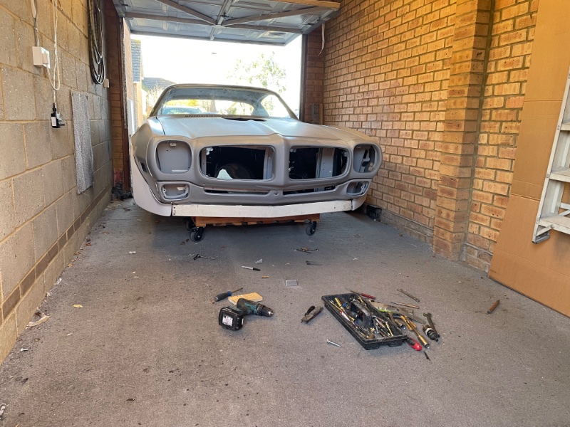

Back on the turd after a few weeks off
Moulding a new front spoiler is next up
Thought this way I could get a very good fitting front wing
And factor in a couple of subtle changes
Back at it already?newsatten wrote: Sun Dec 14, 25 5:29 pm Back on the turd after a few weeks off
I'm interested in learning how you go about making the spoiler!
Haha
Yeah but only light stuff as my eyes are playing up again!
Joys of being old !
Pulled the mains and my crank is good so maybe getaway with a set of bearings and and a polish,
So I’ll use the car as a plug and take a mould from it,
Proof positive that it will fit!
Won’t go mental with the mould as I’ll only be taking one moulding from it,
My dad was a sports boat builder so GPR is in our Da!
I’ll post pics of the progress,
Absolutely zero chance of an original one so needs must etc

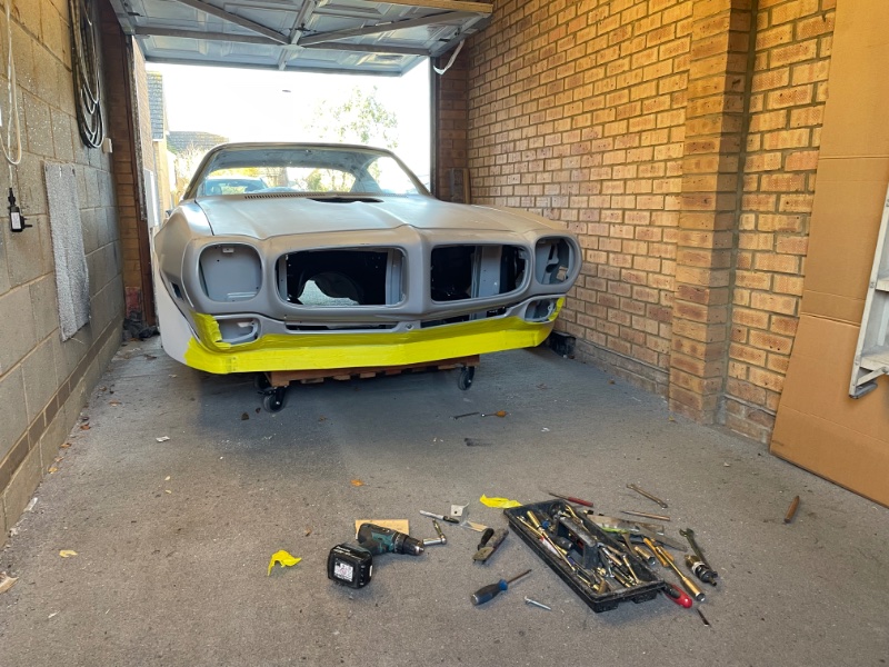

Back on the Turd again,
Almost finished my lower front bib,
This has been a mission but reasonable confident it’ll look good once completed,
Next quarter to door gapping,
Going to have to be creative with this project,
Body sewage alignment is acceptable but square angles are rubbish,
Oh the joys of Far Eastern sheet metal
Do you mean 'sewage' or swage?
For some cars 'sewage' might be be more appropriate. Not yours obviously.
