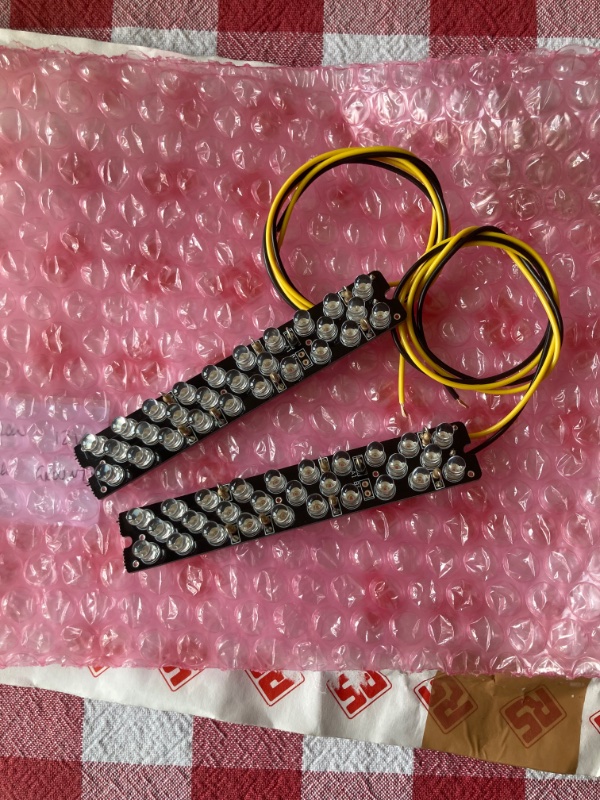

In other news, postie just delivered something I’ve been looking forward to getting.

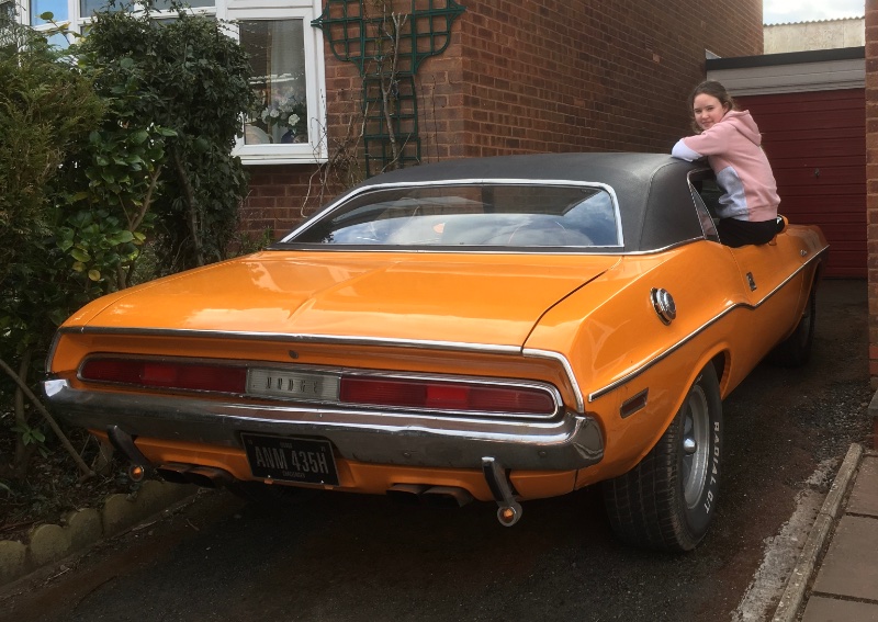

I can finally look to get rid of the dodgy rear indicators that someone bolted onto the bottom of the rear overiders. They look like bowlacks dangling off the bottom of the car…
Always hated them, these should look nice and stock once I figure out how to fix them to the inside of the lenses.

Good progress mate!
Be good to get rid of those 'orrible indicators! Personally I'd just put the lights back to American spec. but I'm a bit like that..

Lol, I’d have had money on you saying that!
I did consider it, but I use it a lot on the road and decided I’d rather not bank on the average Joe realising my brake lights were flashing because I was turning. It’s a self / car preservation thing for me.
I’m focussing on critical stuff first, but 3 things about the view from the rear really annoy me :
1. The bawbag rear indicators - hoping an easy fix now!
2. The view through the rear window of the torn up back of the rear seat - away being fixed by a local upholsterer.
3. The wonky lights where it’s clearly had a push at some point - bodywork is a bit beyond me, so got a friend locally who’s going to come and have a look and advise.
If I can get those three sorted in the next few weeks, I’ll be a very happy man. In the meantime, I’ll keep chipping away.
I’m assured that the yellow LED installation is pretty straight forward, but hadn’t really considered exactly how I’m going to fix the panels inside the rear lenses…

LED Flashers.
I would mock up first before any changes and check that the Indicator relay will still work using LED's - they don't draw much / any Current so the Bi-metallic Flasher Relay may not work... you may have to add a resistor or two to make it function.....
