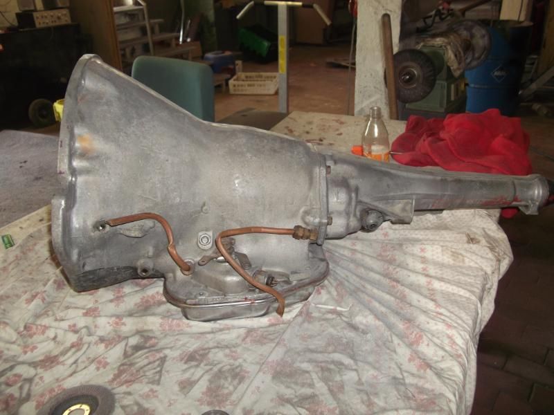

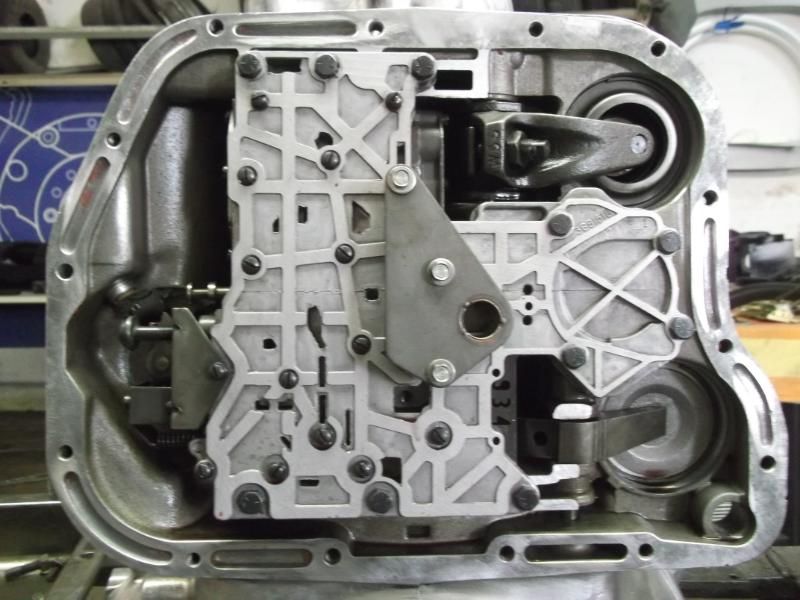

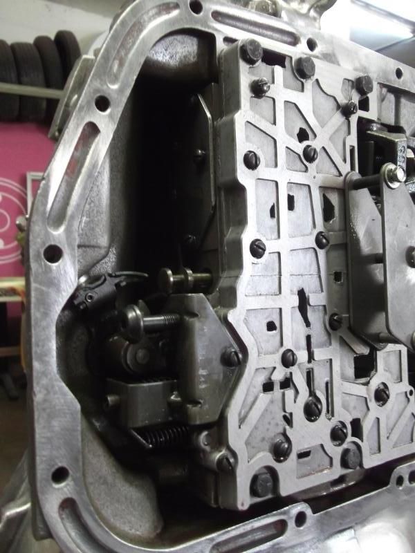

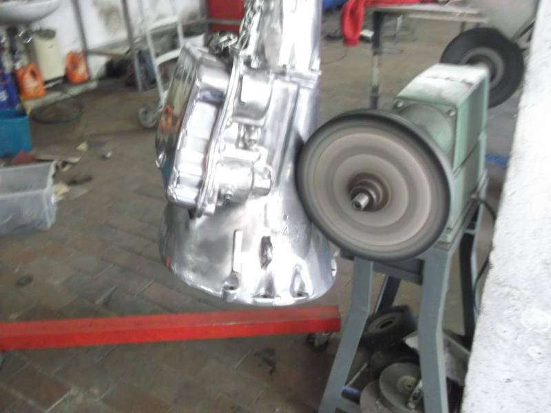

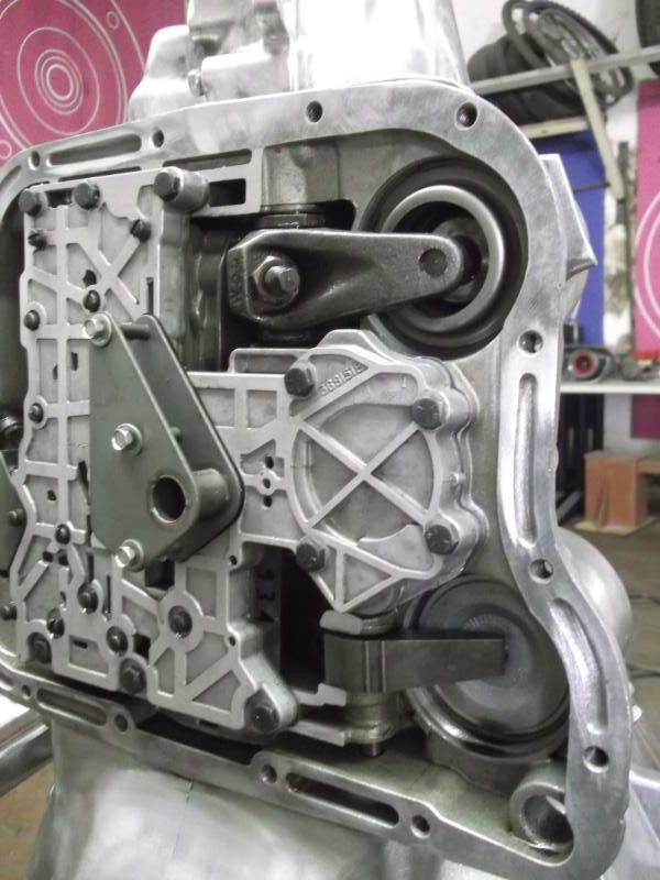

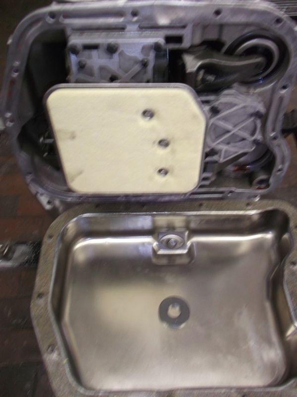

So next up is that dirty gearbox in the corner
Brought as a super box with all the fancy bits.
Can anyone see anything fancy i know nout about gearboxes???

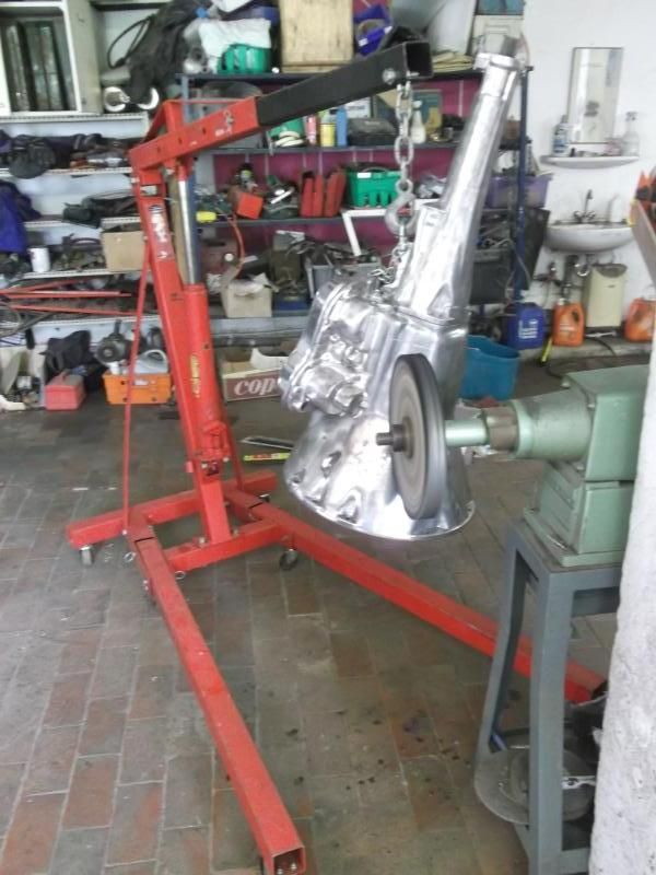

Got carryed away with the cleaning :oops:

You can't tell a lot just by looking at the bottom of the valve body.
looks like a stock everythin cept for the deep pickup/pan
Posts: 14652
All I can tell you from those pictures is it has a deep pan and an early front servo. You'd have to strip it down to see what else it has. 9.5 times out 10, when you pull an unknown Torqueflite apart that is supposed to have "all the best bits" in it, you'll find nothing but a shift kit, a four clutch front drum and a decent ratio front servo lever, the best of the cheap stock parts in other words. Aftermarket parts are very expensive and unnecessary in a lot of cases. A billet front drum alone is 500 quid, you'd be looking at over 2 grand in parts alone if you start chucking race parts in there...

Also now i have polished it should i paint it with a clear coat so it keeps its shiney ?? Wax ?? WD40 ??
Dont want to polish is every again never
Clear coat and then wax. You can't keep them clean if you use the car.

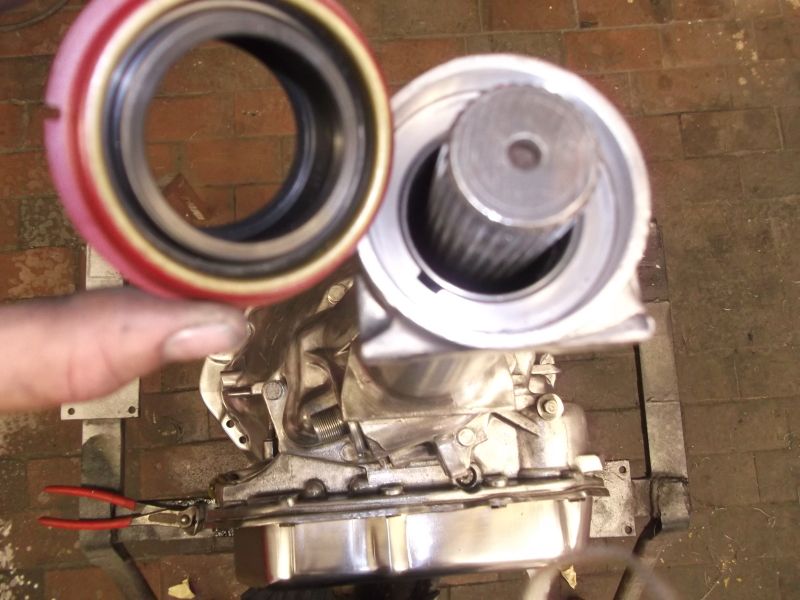

Changed filter fitted a magnet in the sump from old 6x9. Went to fit new rear seal (thanks for the lesson John R) could not find a socket to fit but found some sort of snuff box my gradad gave me

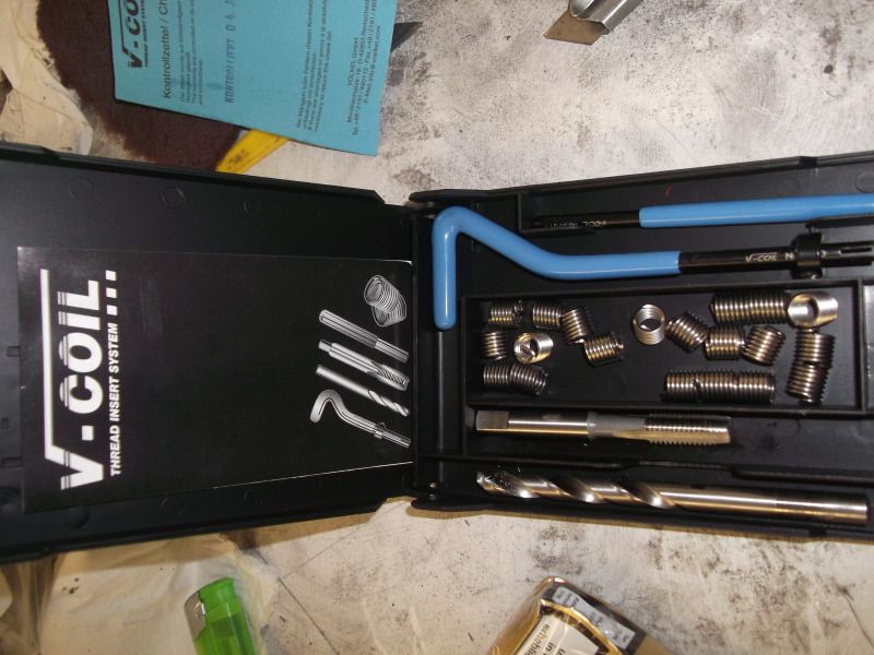

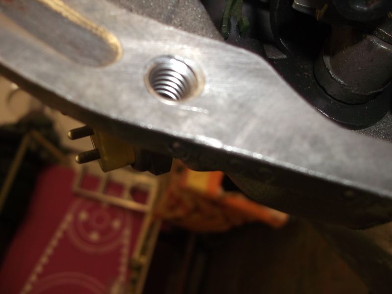

Had one sump bolt that was srewed so fitted a heli coil. First one for me brought kit and followed instruction all good :thumbright:

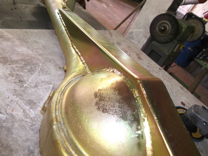

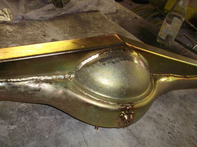

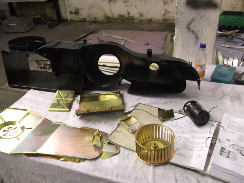

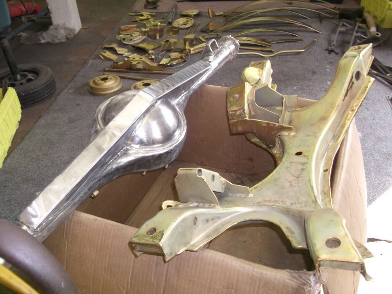

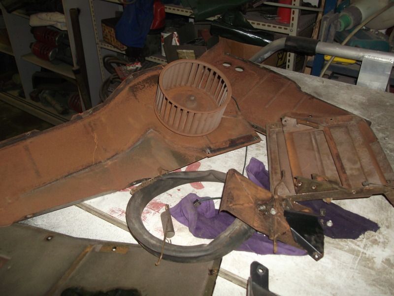

so yellow zinc plating got my more parts back from the platers
some where great and some not. Seams that a part that was heaily pitted with rust looks matt plated if you know what i mean. On my rear and front axle where i cleaned with a grinder it looks great. So i grinded the whole front and rear axle and took them back to be plated again. Also one tiny hole in my brace welding made the brace fill with water and cause problems with the zincing so i welded it up. 2steps back one step forward :roll:

How have you managed to Zinc plate the heater motor impeller. Its made of plastic?
Yes, any thing that is pitted prior to plating will look even worse after plating.
Its just like painting - its all in the prep.
74challenger318
Post by 74challenger318 »
Roger wrote:How have you managed to Zinc plate the heater motor impeller. Its made of plastic?.
:dontknow: but the fag packet plated ok :D
