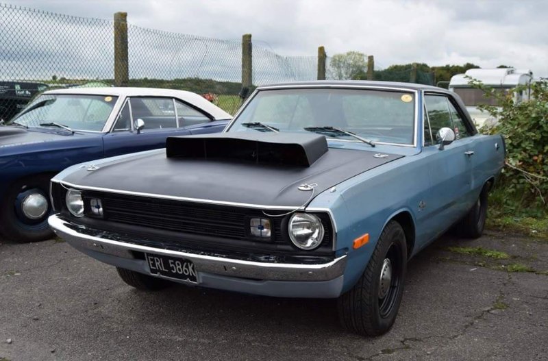

by Dave81
Testing Photo Upload from Mobile
A photo from the HRDs and a chance to test the new site......no need to reply. :thumbright:
