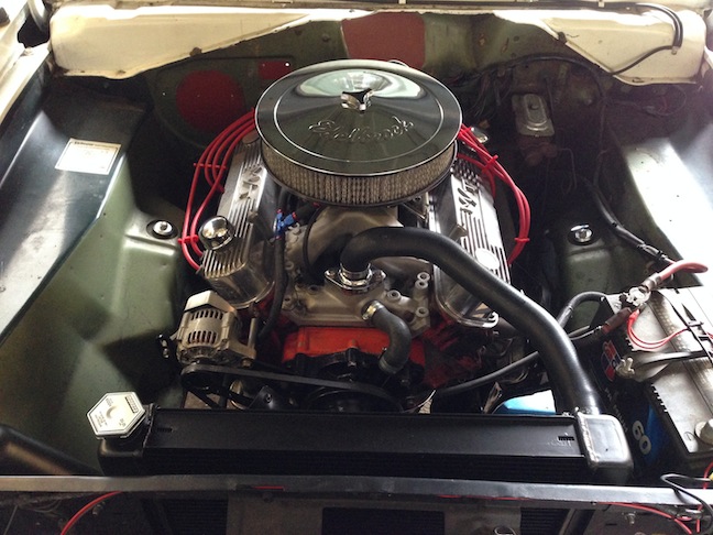

I've got a thing about flexible rad hoses, I hate the things, I admit it I'm a Hoseist. Factory style moulded hoses can usually be found when converting to an Ally rad. The stock bottom hose fitted with a little trimmed off each end. The top was way off. I made a wooden template that slipped over the rad and the thermostat housing and headed off to Customville, basically any hose that met the 2 points on the template would fit. Took about 2 mins of looking through their stock to find something that would do it. If you need to do the same The bottom hose is a Gates 20958, the top is a Dayco 70975

Fantastic!! - I was planning to pop in quickly to Villain's Saturday morning for the very same thing :thumbright: That rad look's very much like my Northern rad - is it?

Blue wrote:I've got a thing about flexible rad hoses, I hate the things, I admit it I'm a Hoseist. Factory style moulded hoses can usually be found when converting to an Ally rad. The stock bottom hose fitted with a little trimmed off each end. The top was way off. I made a wooden template that slipped over the rad and the thermostat housing and headed off to Customville, basically any hose that met the 2 points on the template would fit. Took about 2 mins of looking through their stock to find something that would do it. If you need to do the same The bottom hose is a Gates 20958, the top is a Dayco 70975
A simple, effective way to take all the guess work out of ,a parts bin rummage :thumbright:
Posts: 14479
Mark, My rad is a no make 26" that I picked up at the swap meet. I would imagine a Northern of similar size would be much the same.

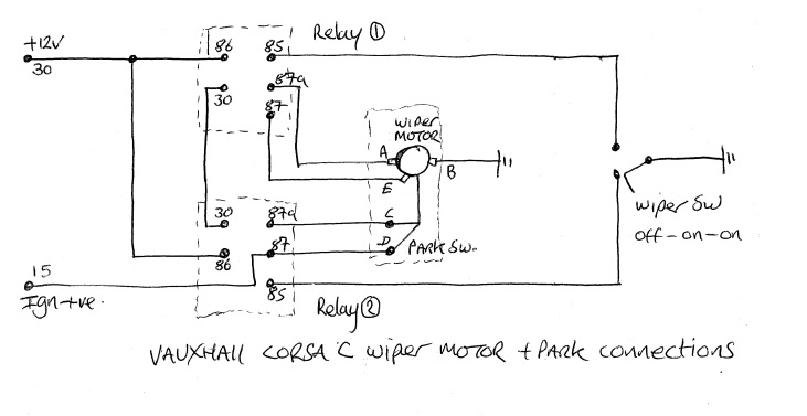

if you also want to use a modern wiper motor
begged, borrowed, nutted-out, stolen from the god of messegaboards the world over, wiper motor set uup for modern self park.
old self park a la mopar
plumb the power backwards via a contact switch in the motor, the 3rd brush and the wiper motor switch
which is a standard US Euro 2 speed and park switch
switch set up
off and park on, contact one on contact 2 off and park off, contact 1 off and contact 2 on and park off.
backwards current causes park.
modern self park OEM makes the contact switch so small and earth one of the other wires internally. wire it as per mopar with the mopar switch and the momentum of the motor pulls it past the switch and you short out to earth the power when the switch swicthed
kinda ruins fuses every rotation but if you were very very quick at changing them i guess you could drive with a clear screen
wipers don't park and they hesistate each rev and never switch off unless the fuse blows
what the....... etc
solution
use a toggle switch
(position 1) all off (position 2) contact 2 on, (position 3) contact 2 and contact 3 on.
and
set up two relays to latch when they see a pulse from the internal switch.
the latching pulses a backwards current in the motor and causes a park or
if not earthed correctly causes a spark
not that simples...but relays weigh nout.... :)
PS this is what it based on
you'll need to work out the wire colours through trial and error
think brown went to switch contact 1 OFF
here is the diagram for the corsa motor set up

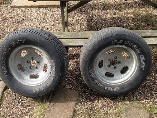

Thanks to Arran for the "econo slots". Fenton Gyro's in a pretty crusty state as described. I set about them with Brillo pads to get rid of the rough corrosion, and then flatted them with 1200 wet & dry to get rid of most of the marks and finished off with Solvol & steel wool. Still far from perfect but good enough for now, brightens the 'ol girl up a bit I reckon.
