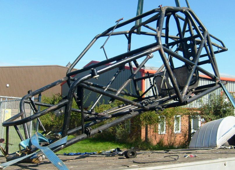

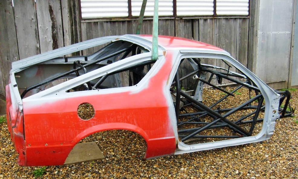

Got the Plymouth Arrow this morning on the truck and Hiab ed it up in the air so could see all around and underneath it. The wheelbase of the Arrow and Daytona are a bit different and the rake of the screen is a bit different but should be able to " lose " the changes in the rear arches and the passenger cell. The front is damaged and will be straightened prior to cutting to suit the Daytona.

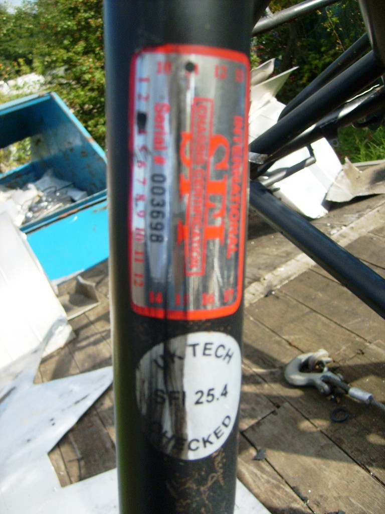

The cage still has a current tag to 7.5 and as I`m not touching anything behind the firewall should be fine ??
The Arrow body will be cut off and thrown away

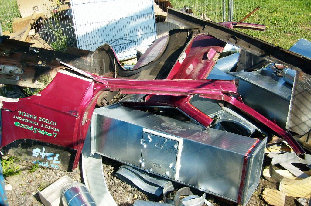

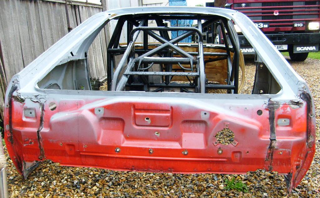

Removed the body this morning and scrapped it
Cage is now ready to go on the jig ( read 2 x RSJ`s laser levelled ;) ) and push / pull any damage ... there is very very little damage on it
Will try and drop the Daytona body over later in the week to get some idea of proportions

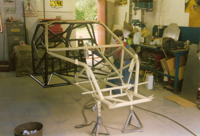

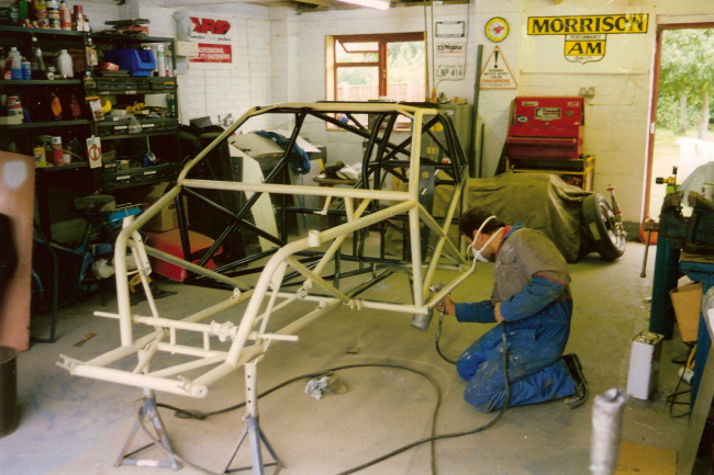

Was that Paul's old Arrow - the one that crashed at Shakey a couple of months ago? :?
Looks like it... 8-)

Hi Rob
Nice pictures .. not seen them before.

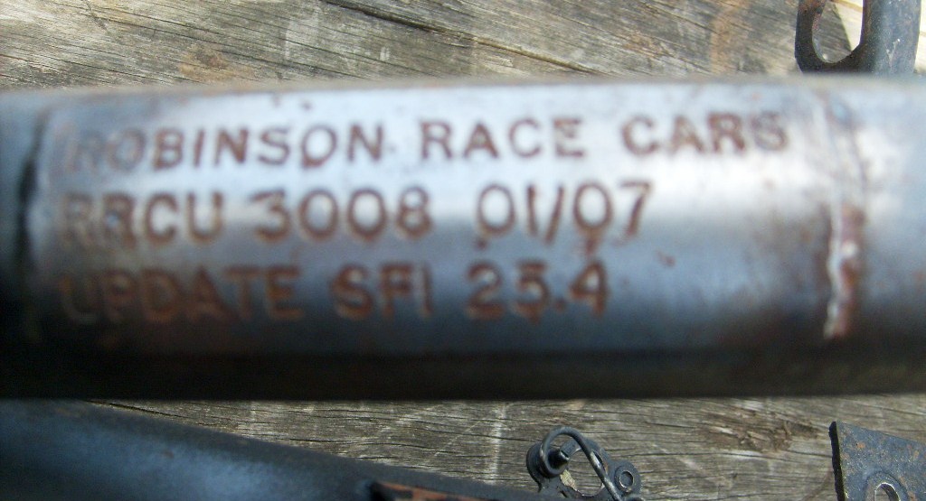

Yes it is the same chassis, I believe Andy Robinson finished it ?? as it wears one of his build plates and was modified to get it`s current tag. The front of the chassis has been altered since that photo so maybe Paul built the version 1 and Andy Rob modified and adapted it ?
It crashed at Santa Pod at low speed and hasn`t done much damage at all .. the front struts took alot of the impact and the wings, grill, bonnet scrubbed alot of the speed off.

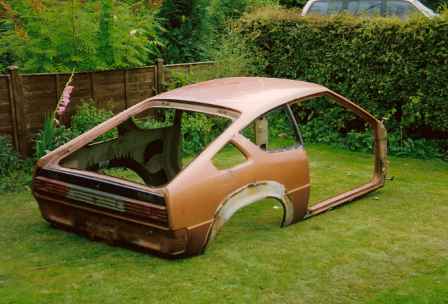

This is what I`m building
Posts: 13939
That'll look great Jon 8-) Copy his car but dont copy anything else about Darrell Alderman ;)
Maybe Andy Robinson did some recent mods to fit the Chevy motor for the previous owner? Tho he may have done some work while Paul still had it.
I suspect Clive Bond (Ultimate Race Cars) down in Cirencester did the original chassis as he does most of Paul's stuff - has done since he raced that Aussie Chrysler CH in the Roadster class in the mid to late 80's!

So where do you go to get a car tagged?
Any details on how they do it? Is it a basic 'points' system like 5 - 7 - 10 point cage and then do some checks of all the connections?
Does it have to be tagged by some kind of authorised body? Does it need re-tagging after light bumps etc? In other words, apart from running faster and having a massive crash, what invalidates the tag?

Cage has to be built to FIA / MSA rulebook for chassis and cages. A technical inspector ( someone like Jeff Martin ) will then inspect it on a " technical " day at Santa Pod and ask to see samples of materials used. If it meets the requirements of the MSA / FIA rulebook and is constructed well and proficently he will pass it as a representative of the sanctioning body, if it is built incorrectly with the wrong materials he will fail it.
He will then attach a sticker / tag with a serial number and expiry date. This is unique to the chassis cage and not the car. It is traceable and details recorded so they cross refence with the chassis plate etc. When it expires it has to have another reinspection and is passed again for a number of years ( unless rules have changed in meantime and it needs an update ). There is a fee for this. All these details are then kept centrally to ensure all cars in competion meet minimum legal requirements for safety.
Harnesses, shields, flex plates etc regularly have to be changed but generally speaking a chassis won`t need work between inspections. Any work forward of the firewall is outside of the scope of the inspection hence I will change from BBC to SBM and change rack and pinion and wheelbase

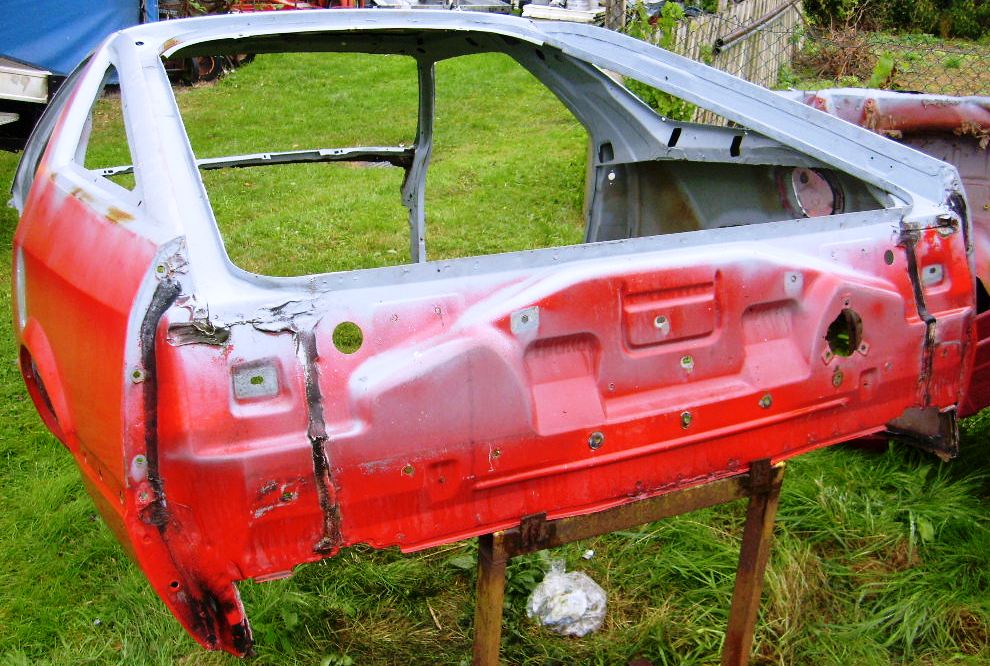

Body is now cut to outer skin only and some secondary supports
Offered the body up to the chassis and the fit is really good
Am off tomorrow too and the chassis will be going on the jig ( homemade )
The body will be fitted to suit the front struts with door openings coming where they come. The rear arch will then get chopped and moved forward / back to suit rear wheel position
