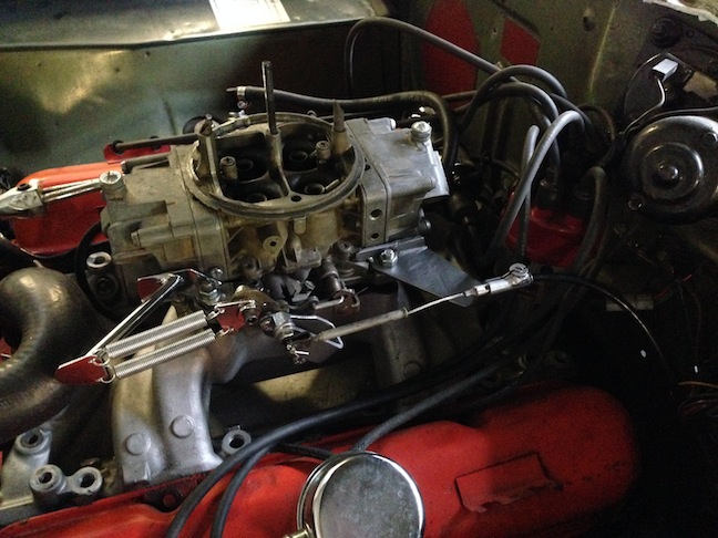

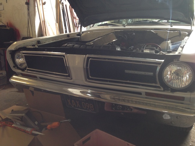

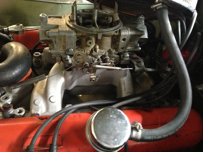

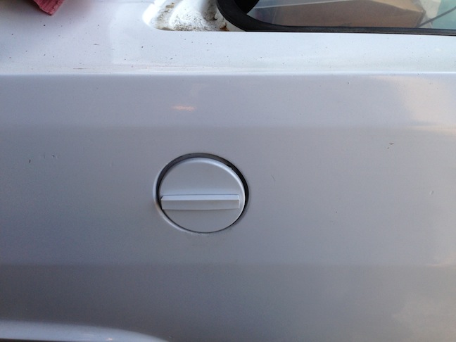

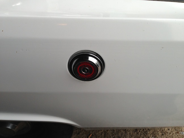

Well progress has been a little slow, I expected to have it MOT'd by now. I had the rear drums off to see why it had bugger all handbrake to find one side covered in gear oil. Got it all stripped down to change the halfshaft seals, waiting for those, brake shoes and wheel cylinders which looked a bit weepy. Everything else in there was new which is handy. So, decided to do a few odds and sods in the meantime. Throttle action was a bit ropey so I made a new cable bracket and fitted some proper return springs. Got hold of an original filler cap. Made heater and radio delete panels, did a quick resto the grille. Here's the befores...
TyreFryer

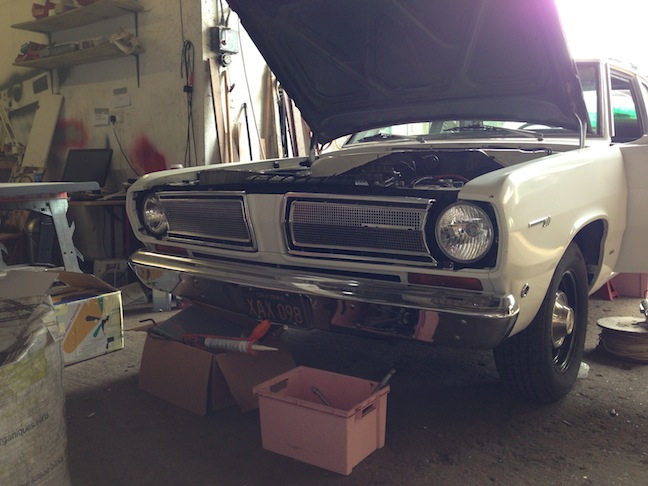

and the afters...
Martin Walker
Posts: 14516
And the afters...
Posts: 7572
Thats quality work there Blue...you are a talented guy!

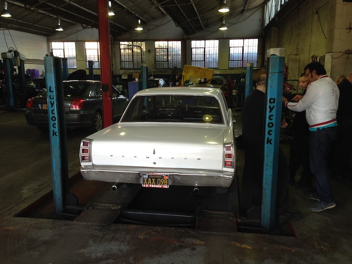

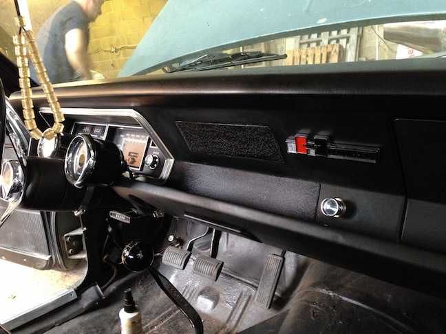

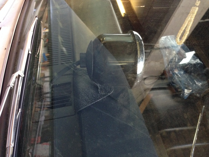

Progress has been slow, but I'm getting on with it. Back brakes rebuilt, handbrake cable unsiezed, new shoes, wheel cylinders and green bearings. Fitted a new indicator switch, which was the reason I only had 1 Brake light. Moved the tach up top where I can see it with a nifty bracket that slips under the dash pad to save drilling it. Fitted a pair of air shocks as a temporary fix to raise it up a bit as the headers were very low to the ground. Oh, and I got it MOT'd today where I met a Greek Elvis impersonator as you do in North london....

"Ugghh-hhaaa-haaa", very nice, ladies and gentlemen; thank you very much.
looking good 8-)
Looking good Blue.
Like the tacho bracket.
If your progress is slow mines static !!!
Good work mate :thumbright:
