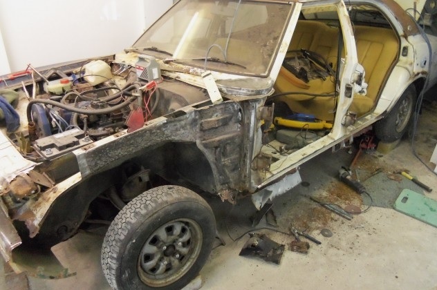

Just a little update for the cortina people out there :rr:
Been busy welding and welding oh! and welding recently. So nothing too exciting to report :?

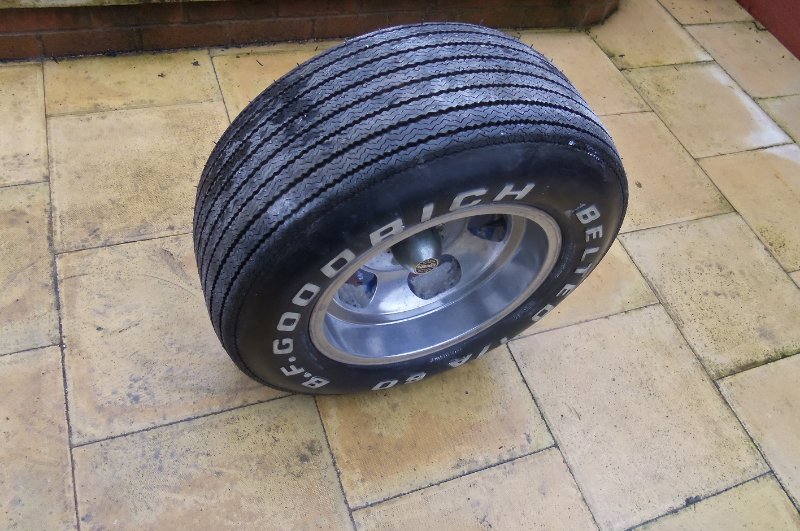

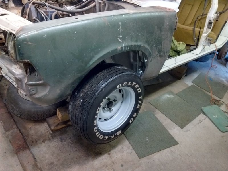

I have been playing around with some wheels though. :D I bought some 8 x 14s slots but the tyres don't sit right,
So have decide to go with steel's, I want them as deep as I can get them.
Ive taken the middle out of some 7 x 14in american wheels turned them round and trial fitted some 14in sierra centers. This is not the final wheel as they will be 5 stud, but just wanted to see haw much I will have to bring the wings out to accommodate the wheels.

Oh!! no, its going to be low and loud, lower the car the fatter it looks :thumbright:

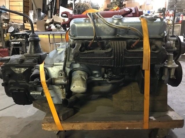

Its been a while now, but still on with the build. Quite a lot has happend since I was last on, Ive bought another 318 from the states with a manual box and all the manual goodies.
Cant seem to upload more pictures so will be back later and tell you all about it :)

hi mate,
the gearbox in the pic looks like a truck box. be aware it may have a 'crawler' first gear (very low ratio) with a big jump to second. that and it's size wouldn't be good for a car. maybe adapt another box to your bellhousing etc, shouldn't be hard.
neil.
