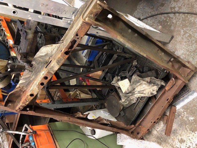

Bit more progress last couple of days
Before cutting the car up, made an additional jig for later use, to locate the rear frame rails.
Then able to cut out large pieces . Won't need this bit anymore !
Once that was out , the front sections of the rails could be carefully picked off the rear floor etc
New pieces initial mockup/placement. After a bit of clamping and squeezing it looks like the fit of the new AMD parts will be very good indeed.

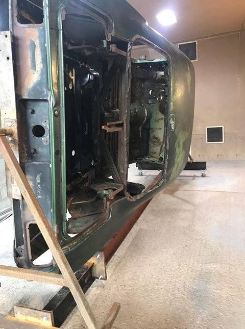

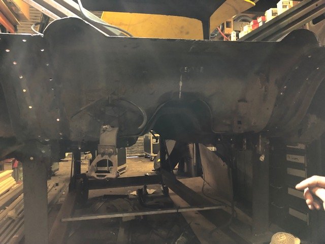

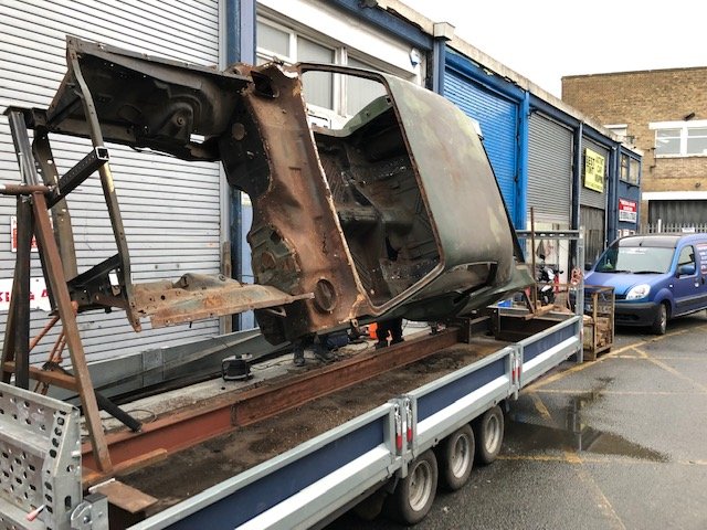

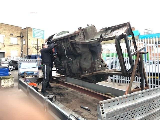

Got the cowl panel under the windscreen removed. Raided the scrap metal pile and built a Rotisserie over the weekend .
Borrowed Bartek and Darek from work yesterday to scrape off the underseal with the aid of a heat gun and blowtorch
Dropped the car off at the blasters near Gatwick this morning. I didn't get time in the end to remove the front floorpan but no big deal. The blaster does mostly classic cars and is building a race car himself.

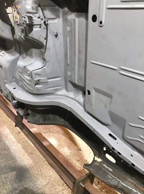

Some areas already blasted and primed by this evening.

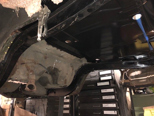

The AMD floorpan is due to arrive on Monday, so intend to get that and the torsion bar crossmember fitted next week, a few other patches, then it's off to have the roll cage installed.
